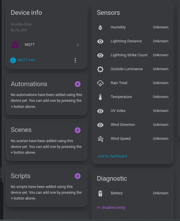

MQTT sensor returns “Unknown” despite topic and json data present in the broker
I have a similar issue to this post but his solution does not fix it:

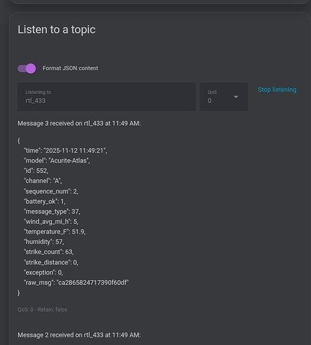

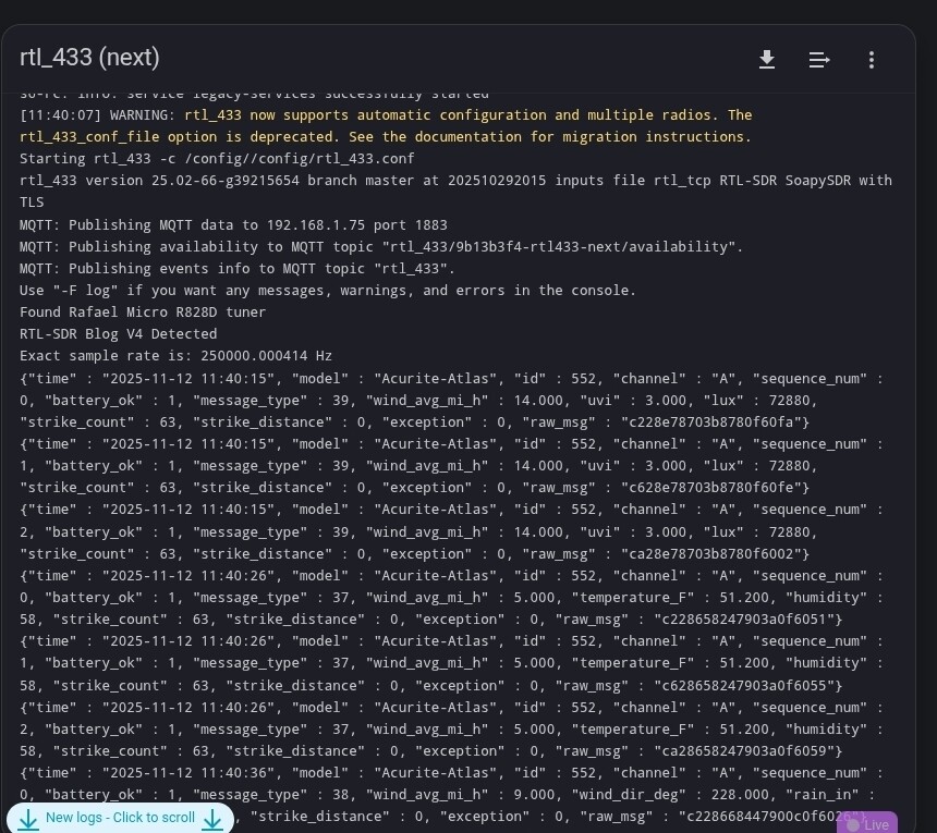

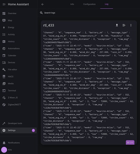

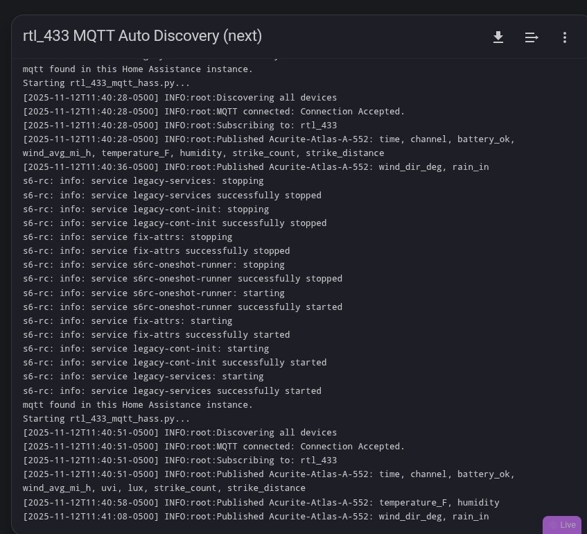

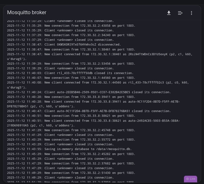

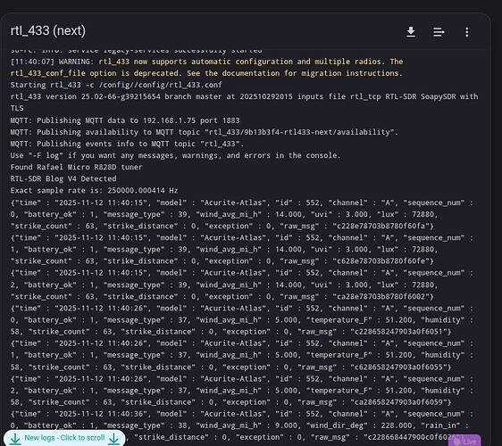

I am using Mosquito broker, RTL_433, RTL_433 Auto Discovery. Everything looks like it is talking correctly, so I cannot pinpoint where my issue is. See screenshots:
Any help is welcome. I have default settings on everything. I am using ID/Pass on Broker,RTL, and Auto Discovery. I altered the event topic to rtl_433 everywhere, because Auto Discovery would not read anything as rtl_433/+/events. Maybe that is a sign of where my problem is?
Also this is my first time trying these addons, so it could easily be a newbie error.
It looks like a combination of copying the exact topics in the Auto Discovery (not next) readme, adding “output si” in the rtl_433 config, and rebooting got them to show. Hope this helps someone in the future!
