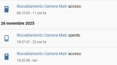

I’ve a problem with an mqtt switch that I’ve found it started without a reason, as visible by the screenshot , for the event of today at 06:12:03 :
that mqtt switch is configured as follow:

I know that into activity page it’s possible to see the automation or the user that triggers the change state, but who triggers the change state when nothing is presented into activity page ?
is it possible to have a better log there ?
how can I solve this issue that led me mad ?
thanks

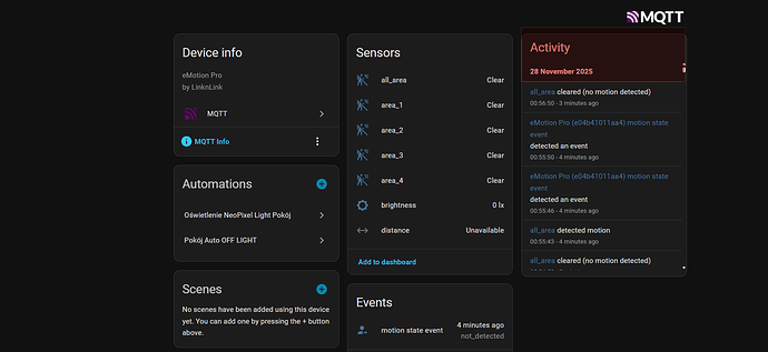

Look in the MQTT device Activity, whether the device disappears from the network
Also check what he wrote @maxym
I’ve no mqtt device there
Which are the benefits of having devices there instead of only into code (my config yamls for shellies is unchanged since HA 0.106)?

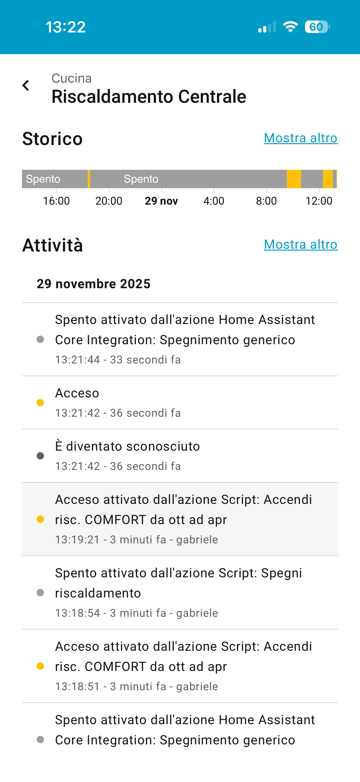

I’ve remove the retain into configuration, but now happens that, when shellies are turned on and HA is restarted, HA does turn of the shellies, and this is unwanted, how an mqtt switch can survive the HA restart?
Thanks
Ok I’ve found myself the solution for this issue: the switch is linked to a generic thermostat that, during startup, notify different state between switch and itself , so turns off the switch.
