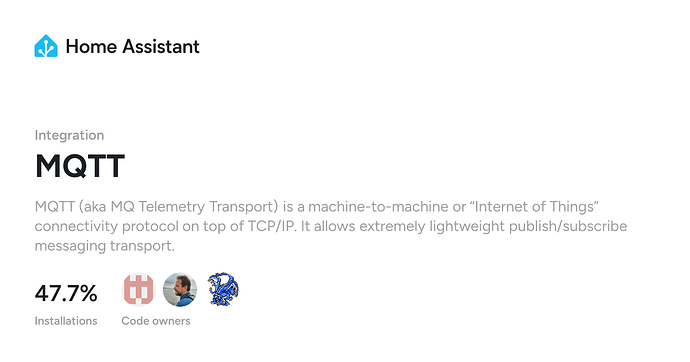

In the docs for MQTT, there’s a section on using abbreviations and base topics.
This says that you can setup a base topic using “~”: “blah/blah”, then add other topics under it using “cmd_t”:“~/set”.
