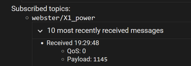

Here is an image showing the value returned from the remote server:

It would help if you would share the YAML or whatever code you are using to create the sensor. Generally speaking, all HA stuff is technically text, but if you add a unit of measure to it, then it will get treated like a number.
Solved - thank you so much - was missing unit of measure.
