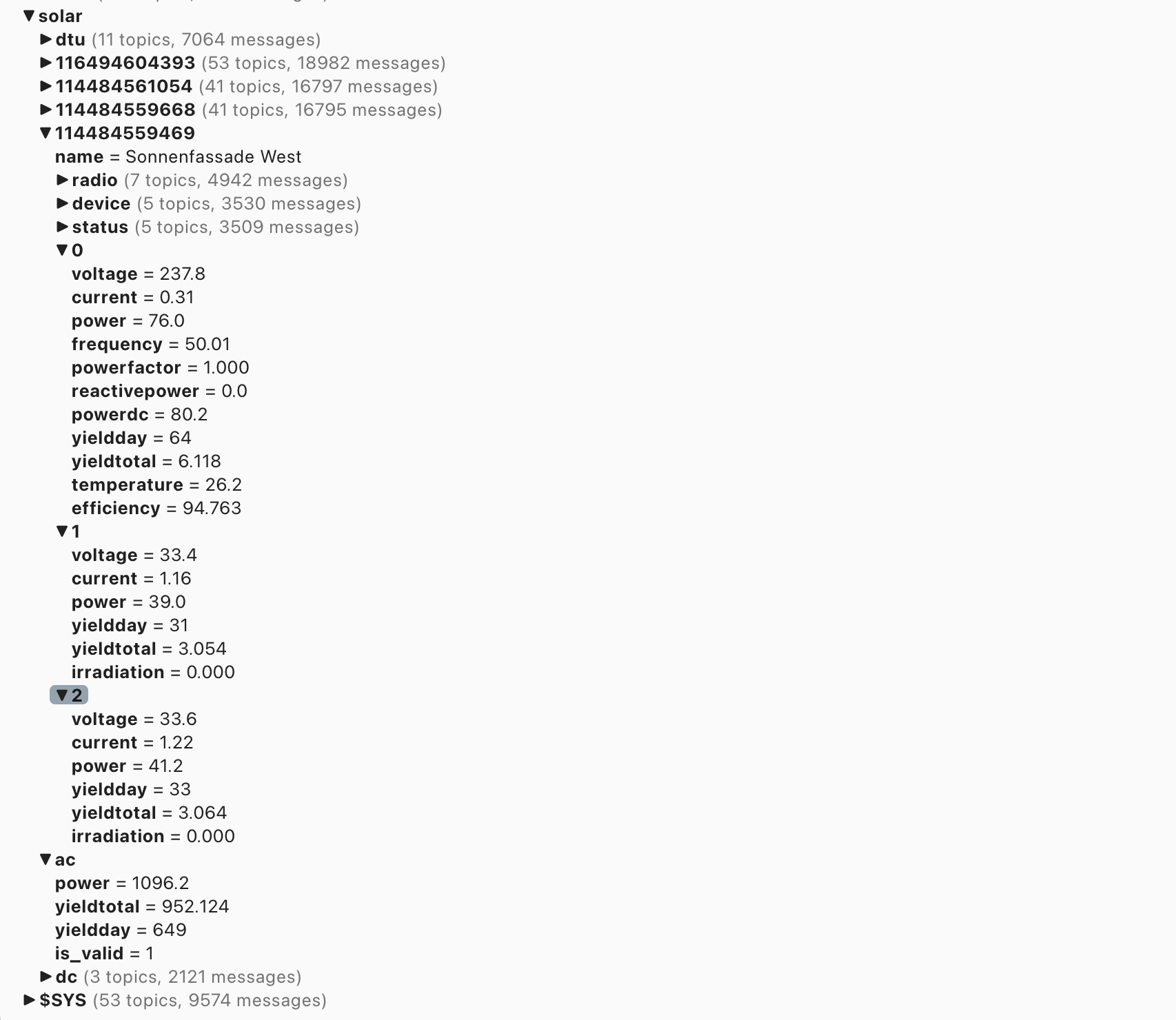

  • MQTT Mosquitto installed and running

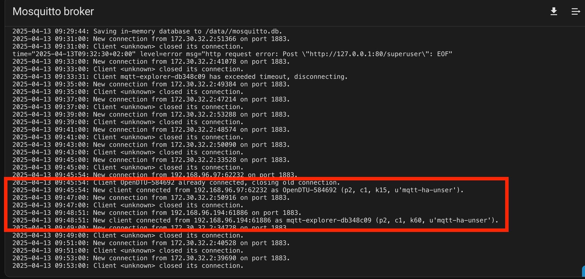

  • MQTT connected to TTN and running
  • openDTU configured and connected to Mosquitto Broker
  • MQTT Explorer connected to HomeAssistant Host is delivering data from the solar/ac/power etc. topic.
It should be possible to receive the DTU values ​​despite the configured connection to TTN.

Mqtt integration connect’s only to mosquitto broker.
To connect to TTN, you need a “bridge client” in mosquitto.
