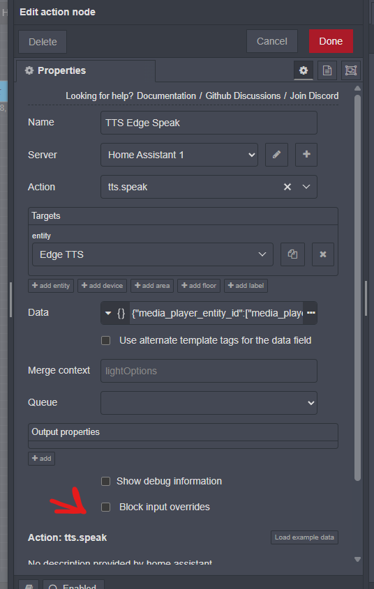

My code:
[{"id":"560edfb0d17e914b","type":"api-call-service","z":"flow-edge-tts","name":"TTS Edge Speak","server":"dbc269b7ec5d8849","version":7,"debugenabled":false,"action":"tts.speak","floorId":[],"areaId":[],"deviceId":[],"entityId":["tts.edge_tts"],"labelId":[],"data":" \"media_player_entity_id\": [ \"media_player.google_home_overloop\", \"media_player.nest_zithoek\" ]}","dataType":"json","mergeContext":"","mustacheAltTags":false,"outputProperties":[],"blockInputOverrides":false,"domain":"tts","service":"speak","x":690,"y":252,"wires":[[]]},{"id":"ac8b7f8f1fbf0e3a","type":"function","z":"flow-edge-tts","name":"makeMSG","func":"msg.payload ={\n data: {\n message: \"Dit is een test\"\n }\n};\nreturn msg;","outputs":1,"timeout":"","noerr":0,"initialize":"","finalize":"","libs":[],"x":506,"y":252,"wires":[["560edfb0d17e914b"]]},{"id":"21d1a4bbed30e2b3","type":"api-call-service","z":"flow-edge-tts","name":"Volume","server":"dbc269b7ec5d8849","version":7,"debugenabled":false,"action":"media_player.volume_set","floorId":[],"areaId":[],"deviceId":[],"entityId":["media_player.nest_zithoek"],"labelId":[],"data":"{\"volume_level\":\"{{volume}}\"}","dataType":"json","mergeContext":"","mustacheAltTags":false,"outputProperties":[],"queue":"none","blockInputOverrides":false,"domain":"media_player","service":"volume_set","x":348,"y":252,"wires":[["560edfb0d17e914b"]]},{"id":"30d5d269fef5ea9b","type":"inject","z":"flow-edge-tts","name":"","props":[{"p":"volume","v":"0.4","vt":"num"},{"p":"topic","vt":"str"}],"repeat":"","crontab":"","once":false,"onceDelay":0.1,"topic":"","x":202,"y":252,"wires":[["21d1a4bbed30e2b3"]]},{"id":"dbc269b7ec5d8849","type":"server","name":"Home Assistant 1","version":5,"addon":false,"rejectUnauthorizedCerts":true,"ha_boolean":"y|yes|true|on|home|open","connectionDelay":false,"cacheJson":false,"heartbeat":false,"heartbeatInterval":"30","areaSelector":"friendlyName","deviceSelector":"friendlyName","entitySelector":"friendlyName","statusSeparator":": ","statusYear":"hidden","statusMonth":"short","statusDay":"numeric","statusHourCycle":"default","statusTimeFormat":"h:m","enableGlobalContextStore":true},{"id":"72b36798b6f8a559","type":"global-config","env":[],"modules":{"node-red-contrib-home-assistant-websocket":"0.79.4"}}]

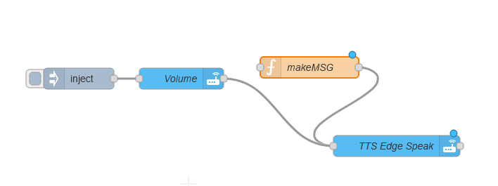

In your export, the first action node is connected to the second action node instead of the function node. Also, in your screenshot, the “data” field starts with {, but that opening brace is missing in the exported flow.
What an unbelievable stupid mistake.
On my screen it showed:
So I didn’t see that node 2 was connected straight to node 4 and missing node 3.
