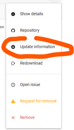

A new release is available, HACS should discover it automatically and prompt you to update. If you cant wait then in HACS you can select “update information” in the 3 dot menu to the right of the entry for the mspa integration.
Then you can download/redownload followed by restart of HA.
