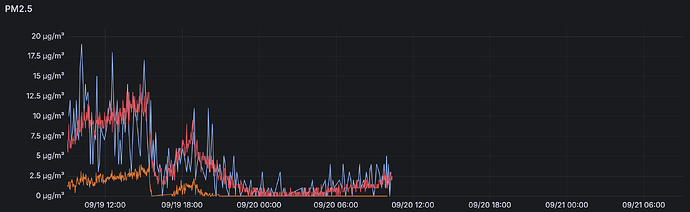

I have my HA instance set up to store long-term air quality sensor data in InfluxDB and visualize it in Grafana. For measuring PM2.5, these sensors use the unit “μg/m³”. This migration breaks all of my existing PM graphs because of the unit “change”:
My options to fix this seem to be:
  1. Switch all of the graphs to the “new” unit (μg/m³ → μg/m³). This is tedious and I lose the ability to display the entire history of each sensor (the data now “starts” at the time of the unit change).
  2. Merge the “old” and “new” series (μg/m³ + μg/m³) via a Grafana transformation (“Merge series/tables” transformation filtered to each series pair) for every sensor. This works, but is tedious, error prone, and only applies to the individual graphs in which I specify the transformations.
Are there any other approaches to fix this breakage? Something inside HA itself I can configure to merge these two equivalent units? Something I can do inside InfluxDB? Wondering how others are dealing with this.
