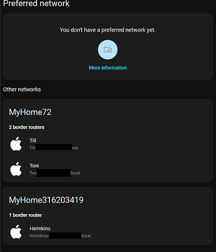

However, it looks like my 3 Apple devices are creating 2 separate Thread networks that don’t seem to be synchronized.
Here’s the screenshot that makes me think so:
I followed ChatGPT’s instructions to remove/reset the devices from my HomeKit home and add them back again, but they always end up creating the same two networks with the same IDs.

Till + Toni are HomePod Minis, Heimkino is a recent Apple TV 4K.

Check this post by @vctgomes : https://www.reddit.com/r/HomeKit/comments/1go214a/apple_tv_creating_new_thread_network/
Seems like the Apple TV has that behaviour when connected through Ethernet instead of WiFi.
Oh yes - the apple tv indeed is connected with cable…
will try that - THANK YOU!
My solution was weird: I created a new VLAN exclusive to my HomePods and Apple TVs, then I connected the devices again. I make no idea what happened haha.
