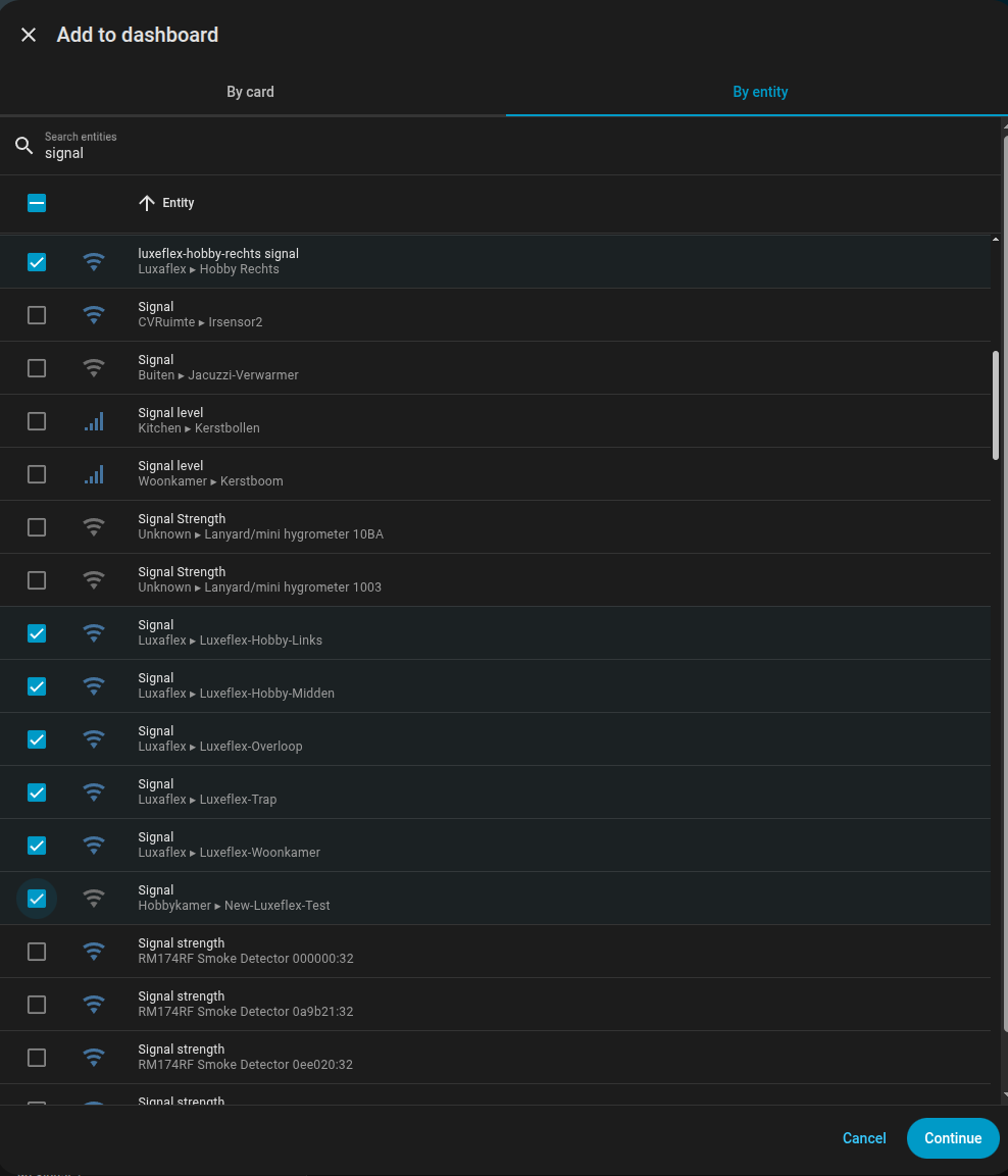

I Add multiple sensors by entity let’s say 20 or 30 searched and selected by “temperature” and select at the point ‘We created a suggestion for you’ I entered “Add to dashboard”
They ALL have the same Layout like the width and hight, visability, and at Config the Content (Like state content)

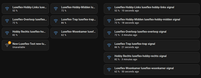

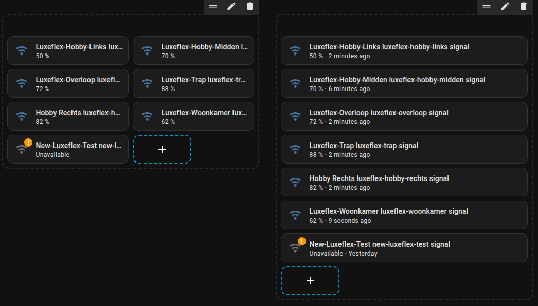

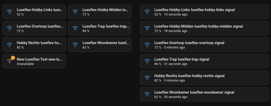

Here I quick select what I want, in this case selecting the wifi signals from my
ESPHome nodes :
Left default results and right how I wish to have it :
Here the same but the editor closed, so the unavailable are not listed :

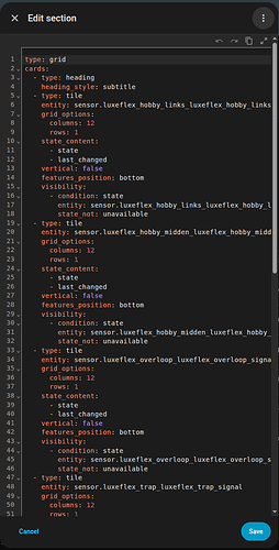

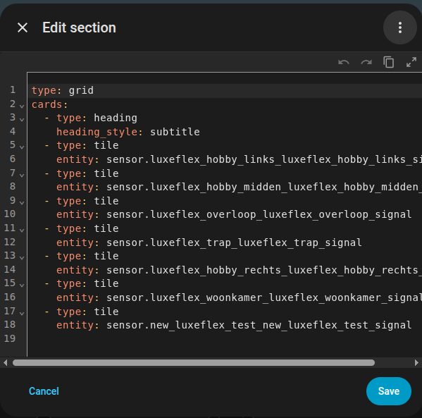

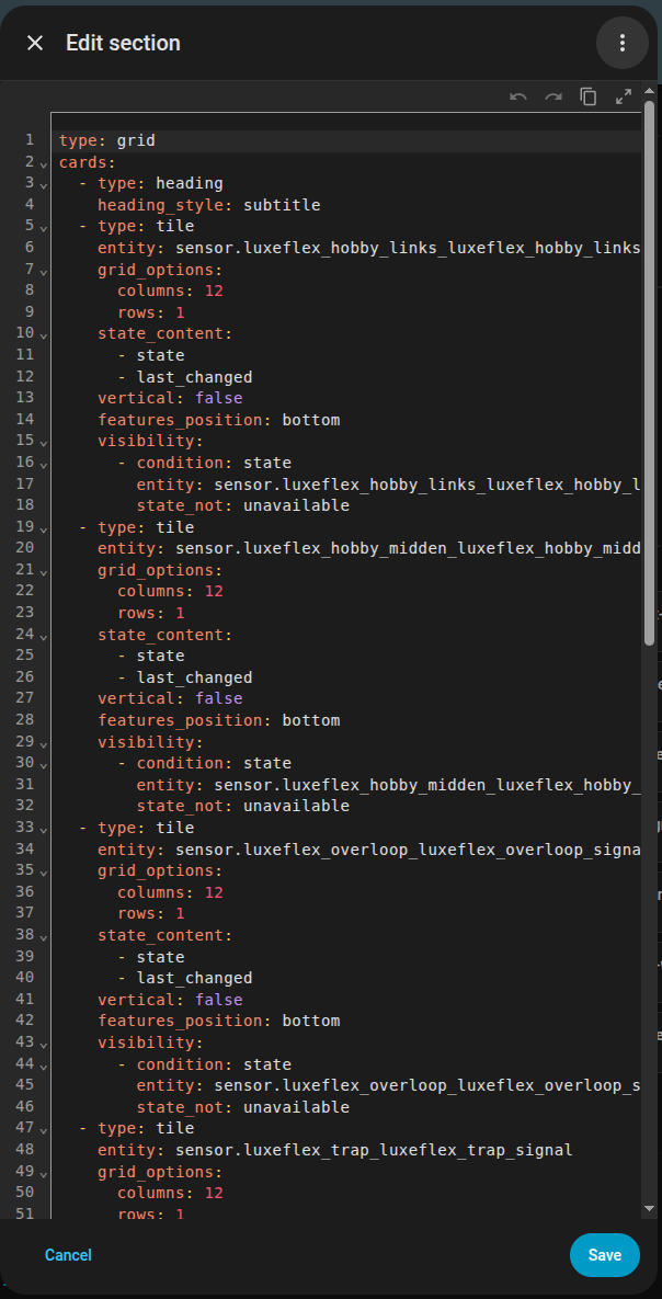

Result default in Yaml :
Results as I wanna have it in Yaml :

If I add 10 entities, no matter how I add them … now I have to add :
state_content:
  • state
  • last_changed
grid_options:
  • colums: 12
  • rows: 1
to every entity manualy.

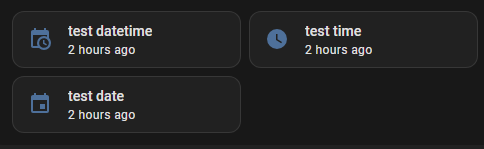

As was already suggested - auto-entities could be a way.
It cannot fill a content of a section (at least it could not till some recent moment).
But it can fill a Grid (or any other stack-like cards).
type: custom:auto-entities
card:
  type: grid
  columns: 2
  square: false
card_param: cards
filter:
  include:
    - entity_id: input_datetime.test*
      options:
        type: tile
        entity: this.entity_id
        state_content:
          - last_changed
        vertical: false
        features_position: bottom
