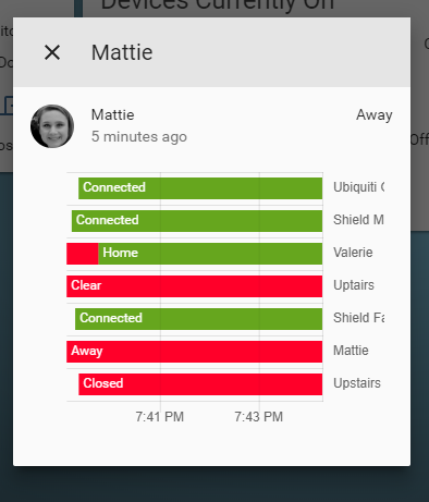

This started happening recently: some history graph started showing (seemingly) random other entities, even though not selected in the card. Also, when selecting certain entities to view status and history, others will show up as well. Here is an example of the history graph – only the temperature entities should be displayed and a zoneminder camera mode is being added (among other things not shown).
Note: I did not change anything in this card – it was working, and in the process of other configuration changes I have broken it.
I have stopped homeassistant, deleted the database and restarted and this is still happening. Any ideas how these extra entities can be creeping into cards without being explicitly referenced?
