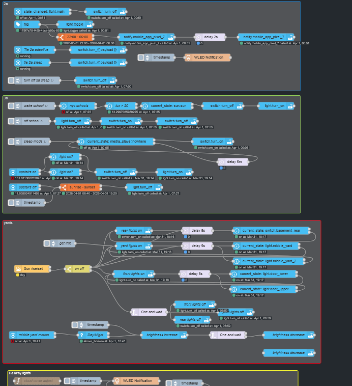

Is it better i.e. more efficient/less cumbersome/easier to de-bug etc to use one events:state node multiple times throughout a series of flows or have just one copy of it and use links?
I’m really just trying to figure out a tidy way to ensure my ever-growing NR setup is as easy as possible to de-bug or make changes to etc.
Currently I might have say a motion detector state-change node in one flow, but also need that input in another flow - how best to do this??
It was easy when I just had a beginning setup but now I have many flows, broken down into lights for each room, motion, heating control, and many more. It’s growing and I want to keep control of it. Is there a guide to sensible design maybe??

Next question is say I have a flow which waits for an events:state input, makes some checks etc and sends an output service-call to a device, maybe a smart bulb. Then in another flow, I might have a different events:state input followed by different checks but which use the same service call.
Would that be a need to duplicate the service call node or link back to the previous flow?
I guess my query is when to link and when to duplicate?
I did have my lighting control on one flow once but it was massive and very hard to follow/debug. It’s currently broken down into many flows but there are many connections also from motion detection, presence detection, even the media control flow has links into the lighting flows.
I don’t use links from page to page. There is nothing wrong with doing that, it’s just my preference. I use links on the same page if there are too many lines criss crossing.
I use grouping on pages to break up my different areas. If I need the same service call on another page, I add another node. It really comes down to what makes sense to you. I wouldn’t worry about duplicating nodes for different flows.

I like the idea of no inter-flow links as well, that would help me a bit, I guess way back I was concerned about having duplicate nodes, I’ll re-think now and tidy-up.
I do tend to use a lot of same-flow links and junction nodes - my flows like just like wiring diagrams with all the wires running parallel, maybe a bit of OCD there I think.
