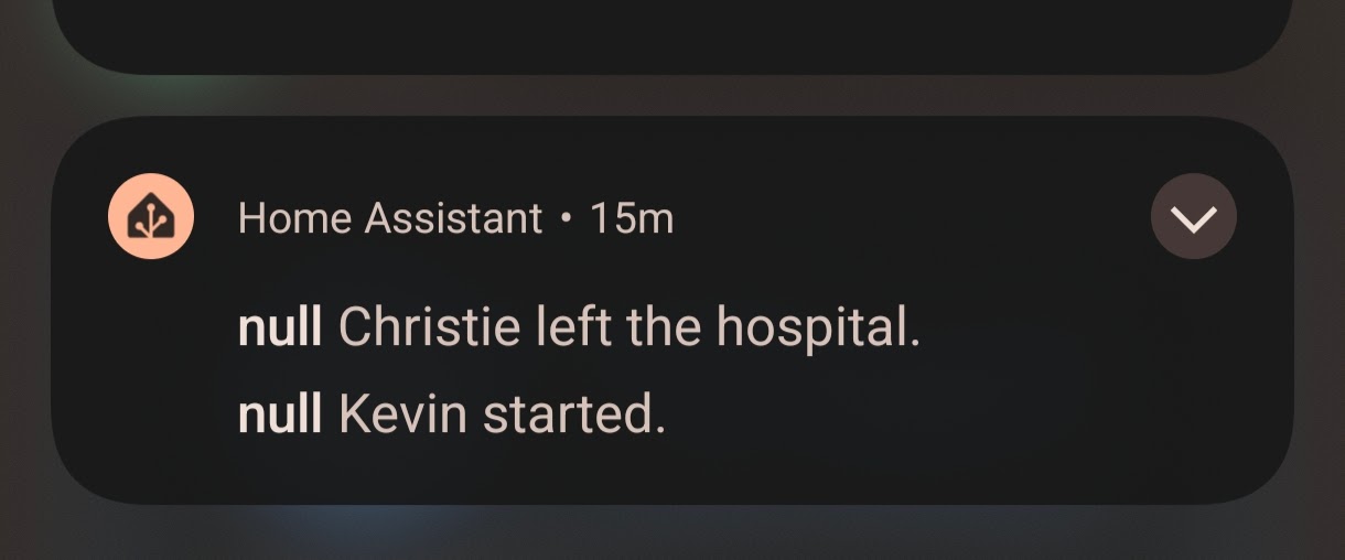

I send most HA notifications to my phone without a title. They have a message body and no title. The notifications look fine when received one at a time.
When I have multiple notifications stacked up, things get weird. Each notification has ‘null’ where a title would be, followed by the message body.
Are you asking how to suppress displaying titles, or maybe descriptive titles may be in your near future?
I am pointing out that my titleless notifications display as expected when they arrive at my phone one at a time (without ‘null’).
They display incorrectly when multiple notifications accumulate and are displayed in this array format.
It didn’t always used to be this way. Up until a few weeks ago the messages displayed as expected either way.
I think this is a bug, but I’m not sure where to report it.
I’m having the same issue and managed to work around it by giving my notifications a title that is just a single white space.
