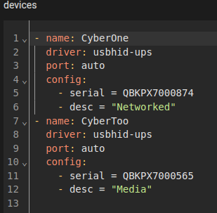

I believe the powervalue variable is to identify which UPS the host is connected to for power. 0 in this case is telling it just to monitor that system.

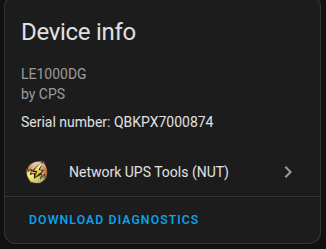

The serials are as complete as I can see. I got the serial numbers from the NUT integration itself.

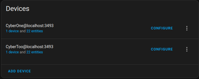

In this post, they successfully got things worked by using the serial numbers. I did the same, but no luck.
Any other ideas?
What about VendorID and ProductID? Have you looked for those (numbers versus names)? Order of the Ids may be important here also.
