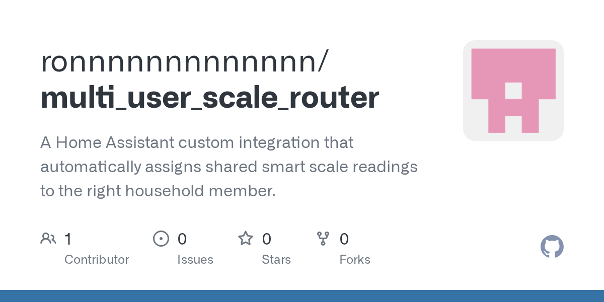

I’ve actually just created a custom integration for this very use-case, and it can work with any HA weight sensor regardless of scale model:
