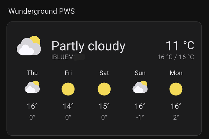

Yes, did you see the picture I attached to the thread?
Yep. I like how it displays on yours, especially the daily list with min/max. See mine:
How did you customise yours? If you did it yourself, can you share the YAML?

I’m using weather-clock-card
This is the UI config from my mushroom dashboard:
type: custom:clock-weather-card
entity: weather.YOUR_ID
This is the repo: GitHub - pkissling/clock-weather-card: A Home Assistant Card indicating today's date/time, along with an iOS inspired weather forecast for the next days with animated icons.
(But you can also install it via HACKS)
