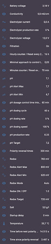

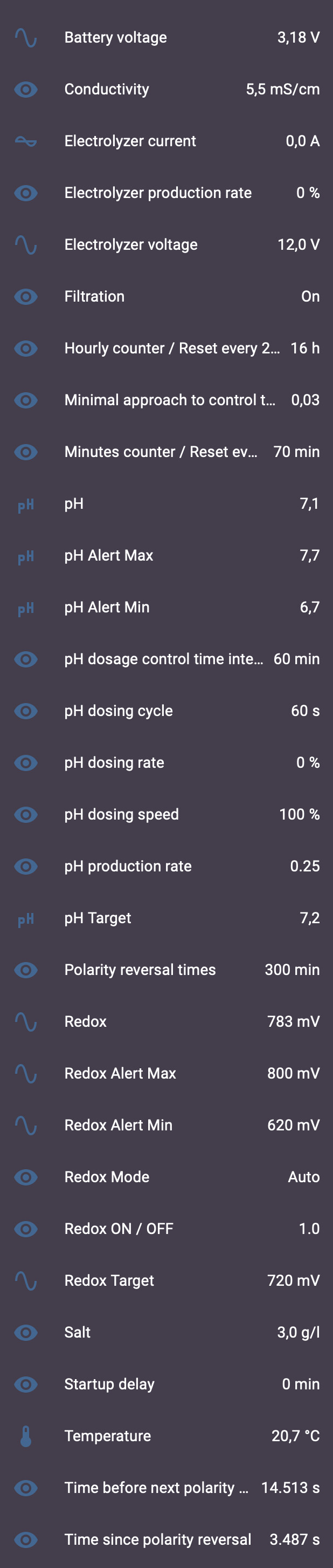

I have developed an integration for Bayrol receiving the real-time data directly through their MQTT interface.
So far I have tested it with BAYROL Automatic Salt 5 but happy to integrate other models as well.
I submitted this integration for HACS pending approval. But you could install it as custom repository in the meantime.
Please let me know if you have any questions.
Dirk
The integration is now part of HACS which makes it much easier to install.
Pool Manager 5 (PM5) and Automatic Cl-pH are also supported.
