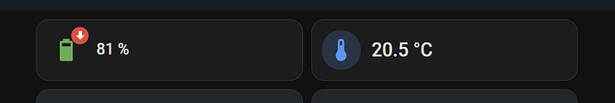

The mush-card-primary-font-size attribute works in my themes.yaml for mushroom entity cards but not for the mushroom template card. Any ideas what attribute I should use for that card, please?

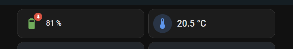

Screenshot above shows the template card on the left, entity card on the right, with the theme applied to the dashboard.
I have tried a few variations like mush-tile-info-primary-font-size without success.

Try --tile-info-primary-font-size
Sadly not, with or without the leading double hyphens.
