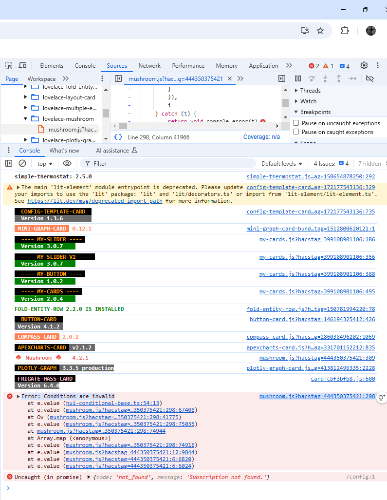

I keep having connection problems and found a suggestion here in the forum to take a look at the client side. So I opened the developer tools in the Chrome browser and when I opened my dashboard, this error always came up
I then removed a few cards and the error no longer occurs when opening the dashboard, but at some point later. Since there is something about mushroom everywhere, I would say that it affects this extension.
Does anyone know what the cause could be?

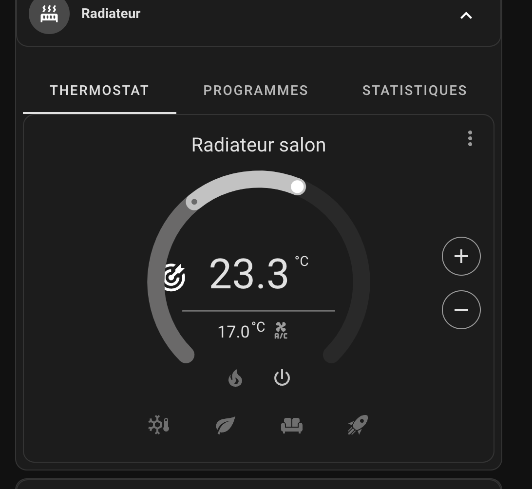

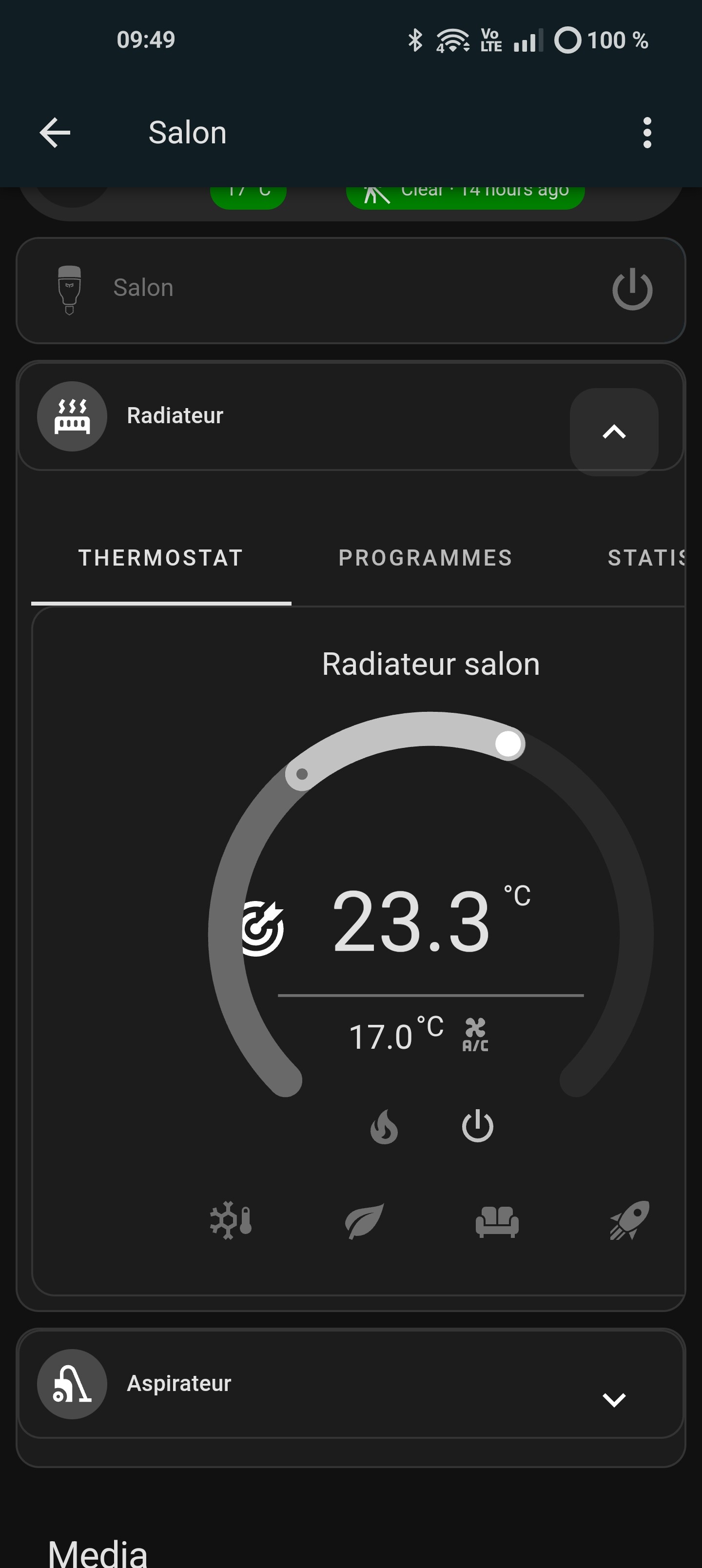

Hi, I’m using mushroom card for my mobile dashboard.
But I’ve an issue on mobile.
The card not displaying full information like on laptop.

Thanks for the help.
Unfortunately, your issue is most likely not Mushroom related
I do see issues with your Mushroom code…
type: custom:mushroom-template-card
primary: Radiateur
entity: climate.radiateur_salon
icon: mdi:radiator
icon_color: |
  {% if is_state(config.entity, 'heat') %}
    orange
  {% else %}
    white
  {% endif %}
layout: horizontal
tap_action:
  action: more-info
Verify your device state in Developer Tools and use config.entity vs entity
Same issue with the correction code.
As I said earlier…

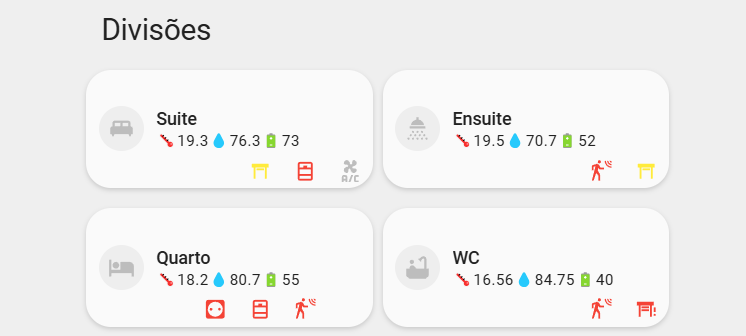

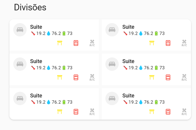

Hello trying to fix some cards, based in previous examples… i’m able to fix it, but can’t fix the style… can anyone help?
This is what i’m trying to fix
Icon align is messy
The align inside the box i want is this one
But now i have a big box shadow that is divided … i want all the box have the shadow and rounded corners.
Here is the code

          - type: custom:vertical-stack-in-card
            cards:
                primary: Suite
                secondary: >-
                  🌡️{{ states('sensor.suite_temperature_xiaomi') }}💧{{
                  states('sensor.suite_humidity_xiaomi') }}🔋{{
                  states('sensor.suite_battery_xiaomi') }}
                icon: mdi:bed-king
                tap_action:
                  action: navigate
                  navigation_path: suite
                hold_action:
                  action: toggle
                icon_color: >-
                  {{ 'deep-orange' if is_state('binary_sensor.suite_motion',
                  'on') else 'disabled' }}
                fill_container: false
                layout: horizontal
                multiline_secondary: false
                card_mod:
                  style: |
                    ha-card {
                      {% if is_state('binary_sensor.suite_motion', 'on') %}
                         background: rgba(255, 152, 0, 0.1);
                      {% endif %}
              - type: custom:mushroom-chips-card
                chips:
                  - type: conditional
                    conditions:
                      - entity: binary_sensor.suite_motion
                        state_not: "off"
                    chip:
                      type: template
                      icon_color: |-
                        {% set state=states(entity) %}
                        {% if state=='open'  or state=='on' %}
                        yellow
                        {% elif state=='unavailable' %}
                        red
                        {% endif %}
                      icon: mdi:motion-sensor
                  - type: conditional
                    conditions:
                      - entity: cover.estore_suite
                        state_not: closed
                    chip:
                      type: template
                      icon_color: |-
                        {% set state=states('cover.estore_suite') %}
                        yellow
                        red
                        {% endif %}
                      icon: |-
                        mdi:window-shutter-open
                        {% else %}
                        mdi:window-shutter-alert
                        {% endif %}
                      tap_action:
                        action: more-info
                      hold_action:
                        action: toggle
                  - type: conditional
                    conditions:
                      - entity: binary_sensor.suite_window
                        state_not: "off"
                    chip:
                      type: template
                      icon_color: |-
                        {% set state=states('binary_sensor.suite_window') %}
                        {% if state=='on' %}
                        yellow
                        {% elif state=='off' %}
                        disabled
                        red
                        {% endif %}
                      icon: mdi:window-open
                  - type: conditional
                    conditions:
                      - entity: climate.suite_ac
                        state_not: "off"
                    chip:
                      type: template
                      icon_color: disabled
                      icon: |-
                        {% if is_state(entity, 'heat_cool') %}
                          mdi:sync
                        {% elif is_state(entity, 'heat') %}
                          mdi:fire
                        {% elif is_state(entity, 'cool') %}
                          mdi:snowflake
                        {% elif is_state(entity, 'dry') %}
                          mdi:water-percent
                        {% elif is_state(entity, 'fan_only') %}
                          mdi:fan
                        {% else %}
                          mdi:air-conditioner
                        {% endif %}
                alignment: end
                card_mod:
                  style: |
                    ha-card {
                      --chip-box-shadow: none;
                      --chip-background: none;
                      margin-top:-10px
            card_mod:
              style: |
                ha-card {
                  height: 85px;
            cards:
                primary: Suite
                secondary: >-
                icon: mdi:bed-king
                tap_action:
                  action: navigate
                hold_action:
                  action: toggle
                icon_color: >-
                layout: horizontal
                card_mod:
                  style: |
                    ha-card {
                      {% endif %}
                chips:
                  - type: conditional
                    conditions:
                        state_not: "off"
                    chip:
                      type: template
                      icon_color: |-
                        yellow
                        red
                        {% endif %}
                  - type: conditional
                    conditions:
                        state_not: closed
                    chip:
                      type: template
                      icon_color: |-
                        yellow
                        red
                        {% endif %}
                      icon: |-
                        {% else %}
                        {% endif %}
                      tap_action:
                        action: more-info
                      hold_action:
                        action: toggle
                  - type: conditional
                    conditions:
                        state_not: "off"
                    chip:
                      type: template
                      icon_color: |-
                        yellow
                        disabled
                        red
                        {% endif %}
                  - type: conditional
                    conditions:
                        state_not: "off"
                    chip:
                      type: template
                      icon: |-
                          mdi:sync
                          mdi:fire
                          mdi:snowflake
                          mdi:water-percent
                          mdi:fan
                        {% else %}
                          mdi:air-conditioner
                        {% endif %}
                alignment: end
                card_mod:
                  style: |
                    ha-card {
                      margin-top:-10px
            card_mod:
              style: |
                ha-card {
                  height: 85px;
            cards:
                primary: Suite
                secondary: >-
                icon: mdi:bed-king
                tap_action:
                  action: navigate
                hold_action:
                  action: toggle
                icon_color: >-
                layout: horizontal
                card_mod:
                  style: |
                    ha-card {
                      {% endif %}
                chips:
                  - type: conditional
                    conditions:
                        state_not: "off"
                    chip:
                      type: template
                      icon_color: |-
                        yellow
                        red
                        {% endif %}
                  - type: conditional
                    conditions:
                        state_not: closed
                    chip:
                      type: template
                      icon_color: |-
                        yellow
                        red
                        {% endif %}
                      icon: |-
                        {% else %}
                        {% endif %}
                      tap_action:
                        action: more-info
                      hold_action:
                        action: toggle
                  - type: conditional
                    conditions:
                        state_not: "off"
                    chip:
                      type: template
                      icon_color: |-
                        yellow
                        disabled
                        red
                        {% endif %}
                  - type: conditional
                    conditions:
                        state_not: "off"
                    chip:
                      type: template
                      icon: |-
                          mdi:sync
                          mdi:fire
                          mdi:snowflake
                          mdi:water-percent
                          mdi:fan
                        {% else %}
                          mdi:air-conditioner
                        {% endif %}
                alignment: end
                card_mod:
                  style: |
                    ha-card {
                      margin-top:-10px
            card_mod:
              style: |
                ha-card {
                  height: 85px;
            cards:
                primary: Suite
                secondary: >-
                icon: mdi:bed-king
                tap_action:
                  action: navigate
                hold_action:
                  action: toggle
                icon_color: >-
                layout: horizontal
                card_mod:
                  style: |
                    ha-card {
                      {% endif %}
                chips:
                  - type: conditional
                    conditions:
                        state_not: "off"
                    chip:
                      type: template
                      icon_color: |-
                        yellow
                        red
                        {% endif %}
                  - type: conditional
                    conditions:
                        state_not: closed
                    chip:
                      type: template
                      icon_color: |-
                        yellow
                        red
                        {% endif %}
                      icon: |-
                        {% else %}
                        {% endif %}
                      tap_action:
                        action: more-info
                      hold_action:
                        action: toggle
                  - type: conditional
                    conditions:
                        state_not: "off"
                    chip:
                      type: template
                      icon_color: |-
                        yellow
                        disabled
                        red
                        {% endif %}
                  - type: conditional
                    conditions:
                        state_not: "off"
                    chip:
                      type: template
                      icon: |-
                          mdi:sync
                          mdi:fire
                          mdi:snowflake
                          mdi:water-percent
                          mdi:fan
                        {% else %}
                          mdi:air-conditioner
                        {% endif %}
                alignment: end
                card_mod:
                  style: |
                    ha-card {
                      margin-top:-10px
            card_mod:
              style: |
                ha-card {
                  height: 85px;
    card_mod:
      style: |
        ha-card {
          border:none;
          background:none;
          /*box-shadow:none;*/

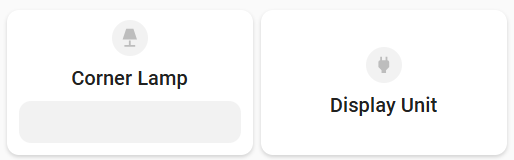

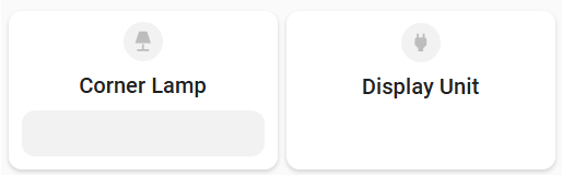

Hi All,
Can anyone potentially offer some advice for a query I have?
On the image below, is there any way to align the text on the right mushroom entity card to be the same as the mushroom light card, on the vertical column, so the text / icons on both cards are in the same spot (but on the right there would be white space at the bottom of the card)?
From this…
To this…
type: horizontal-stack
cards:
  - type: custom:mushroom-light-card
    entity: light.hue_bulb_dining_room
    icon: mdi:lamp
    layout: vertical
    primary_info: name
    secondary_info: none
    use_light_color: true
    show_brightness_control: true
    hold_action:
      action: more-info
    double_tap_action:
      action: none
    collapsible_controls: false
    fill_container: true
    icon_type: icon
    tap_action:
      action: toggle
    card_mod:
      style:
        mushroom-state-info$: |
          .container {
           --card-primary-font-size: 20px !important;
           --card-secondary-font-size: 16px !important;
          ha-card {
           --card-primary-line-height: 25px !important;
           --card-secondary-line-height: 20px !important;
  - type: custom:mushroom-entity-card
    entity: switch.hue_plug_dining_room
    icon: mdi:power-plug
    hold_action:
      action: more-info
    double_tap_action:
      action: none
    icon_color: primary
    primary_info: name
    tap_action:
      action: toggle
    layout: vertical
    card_mod:
      style:
          .container {
          ha-card {
Please post your card code to expedite a solution.
Have updated my post to include the current code which reflects the first image. I’m hopeful, additional code via card_mod may be able to give me the results I’m hoping for in the second image.
I simplified the code a bit…
cards:
    icon: mdi:lamp
    layout: vertical
    primary_info: name
    hold_action:
      action: more-info
    double_tap_action:
      action: none
    icon_type: icon
    tap_action:
      action: toggle
    card_mod:
    hold_action:
      action: more-info
    double_tap_action:
      action: none
    icon_color: primary
    primary_info: name
    tap_action:
      action: toggle
    layout: vertical
    card_mod:
      style: |
          ha-card {
           padding-bottom: 50px
I didn’t go through all your code because it’s a lot. Try something like this with the Layout-Card and Stack-in-Card
type: custom:layout-card
layout_type: custom:grid-layout
layout:
  grid-template-columns: 1fr 1fr
cards:
  - type: custom:stack-in-card
    cards:

Can’t believe it was that simple. Should have caught that myself, but perhaps was too immersed in it to notice what the right answer was. Cheers for sorting that.
