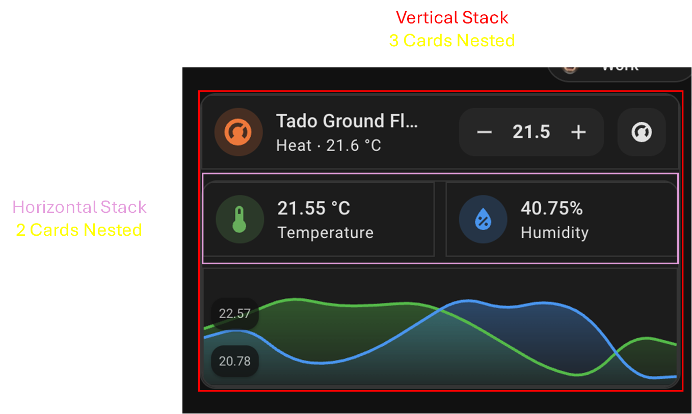

Accroding to the docs it should be
type: custom:stack-in-card
keep:
  box_shadow: false
cards:
  - type: custom:mushroom-climate-card
    entity: climate.wireless_temperature_sensor_x
    hvac_modes:
      - heat
      - cool
    show_temperature_control: true
    layout: horizontal
    name: Tado Ground Floor
    icon: mdi:thermostat
    double_tap_action:
      action: more-info
  - type: custom:stack-in-card
    cards:
      - type: grid
        square: false
        columns: 2
        cards:
          - type: custom:mushroom-entity-card
            entity: sensor.wireless_temperature_sensor_x_temperature
            primary_info: state
            secondary_info: name
            icon_color: green
            entity: sensor.wireless_temperature_sensor_x_humidity
            primary_info: state
            icon_color: blue
      - type: custom:mini-graph-card
        entities:
          - entity: sensor.wireless_temperature_sensor_x_temperature
            color: "#00bb33"
          - entity: sensor.wireless_temperature_sensor_x_humidity
            color: "#2196f3"
            y_axis: secondary
        hours_to_show: 24
        line_width: 3
        font_size: 50
        animate: true
        show:
          icon: false
          labels: true
          state: false
          legend: false
          fill: fade

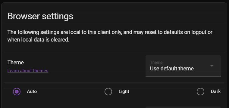

Also just try changing you theme for interest sake. Click on your profile icon just below the notification bell.
Stack In Card has not been maintained since 2020.
If that does not work you may want to try lovelace-layout-card
Layout-card
If needed, any layout can also be used inside a lovelace-card by using layout-card:
type: custom:layout-card layout_type: custom:masonry-layout layout: width: 300 max_cols: 10 cards: …
Layout-card will take its cards and place them within itself according to the specified layout.
layout: takes the same options as is the view configuration for a layout.
NOTE: Please be aware that layout-card is itself a CARD, and cannot be wider than any other cards in the same view.
All cards you specify within it must fit inside this same width.
Thus layout-card is of limited use except in panel mode.
NOTE 2: The ā€œdefaultā€ layout option for layout-card (which you’ll see if you’re using the GUI lovelace editor) uses the default layout engine of lovelace. It’s basically the same as the Horizontal layout, but without any options, without being able to hide cards and with the number of columns based on the width of the window rather than the layout-card.
I don’t recommend using it, but it’s there.
If I run Mushroom Shadow theme, the lines disappear :slight_smile:
Ultimately I was trying to keep my install clean and as default as possible.
Let me try your code, and thank you so much!
I’ll report back shortly
EDIT Using your code and no theme shows the lines again
Good to hear. I agree with keeping as default as possible.
To achieve this in default Home Assistant Cards.
I would suggest Stack-In card is broken.

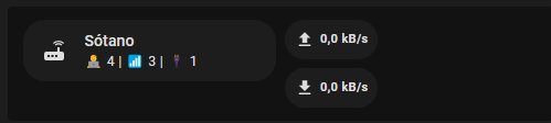

Hi! Thanks a lot all of those who had contributed with your ideas for my dashboard.
Right now I’m strugelling to make a card that shows my WiFi Deco with the information of coneccted users (total, WiFi and Wired) and the up & down speed.
What I want it’s to put at the right side of the mushroom-template-card (inside the card) bowth entities (sensor.sotano_up & sensor.sotano_down) .
How do you suggest to do it?
My actual template card looks like this:
Thanks in advanced
code
type: horizontal-stack
cards:
  • type: custom:mushroom-template-card
    primary: Sótano
    secondary: >
    :technologist: {{ states(ā€˜sensor.clientes_sotano_totales’) }} | :signal_strength: {{
    states(ā€˜sensor.clientes_sotano_wifi’) }} | :electric_plug: {{
    states(ā€˜sensor.clientes_sotano_cable’) }}
    icon: >-
    {% if state_attr(ā€˜device_tracker.sotano_deco’, ā€˜internet_online’) %}
    mdi:router-wireless {% else %} mdi:router-wireless-off {% endif %}
    entity: device_tracker.sotano_deco
    icon_color: >-
    {% if state_attr(ā€˜device_tracker.sotano_deco’, ā€˜internet_online’) %} green
    {% else %} red {% endif %} badge_icon: ā€œā€
  • type: vertical-stack
    cards:
    • type: custom:mushroom-chips-card
      chips:
      • type: entity
        entity: sensor.sotano_up
        icon: mdi:upload
      chips:
      • type: entity
        entity: sensor.sotano_down
        icon: mdi:download

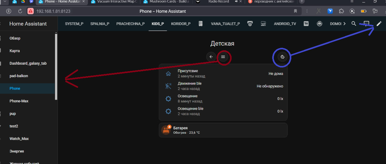

Hello everyone. I have made a menu on each page. Thanks to the button in the middle (red) I can hide and open the sidebar, is there any way to make the ā€œedit pageā€ button? I circled it in blue.

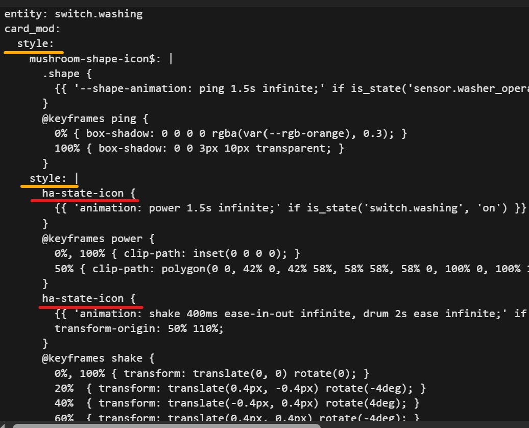

I love the animated icons and I tried to modify the (changed) to my needs: if device is on - animation on. If the device is off - no animation. I tried this way:
entity: switch.464040536436002816_bsh_common_setting_powerstate
icon: mdi:tumble-dryer
tap_action:
  action: toggle
hold_action:
  action: none
double_tap_action:
  action: none
grid_options:
  columns: 12
  rows: 1
card_mod:
  style: |
    {{% if switch.464040536436002816_bsh_common_setting_powerstate, 'on') %}
      ha-state-icon {
        animation: shake 400ms ease-in-out infinite, drum 1s infinite;

Unfortunately your posted code is all over the place and I assume you are getting errors. Do you have a specific question?
I underlined a few issues you need to address.
