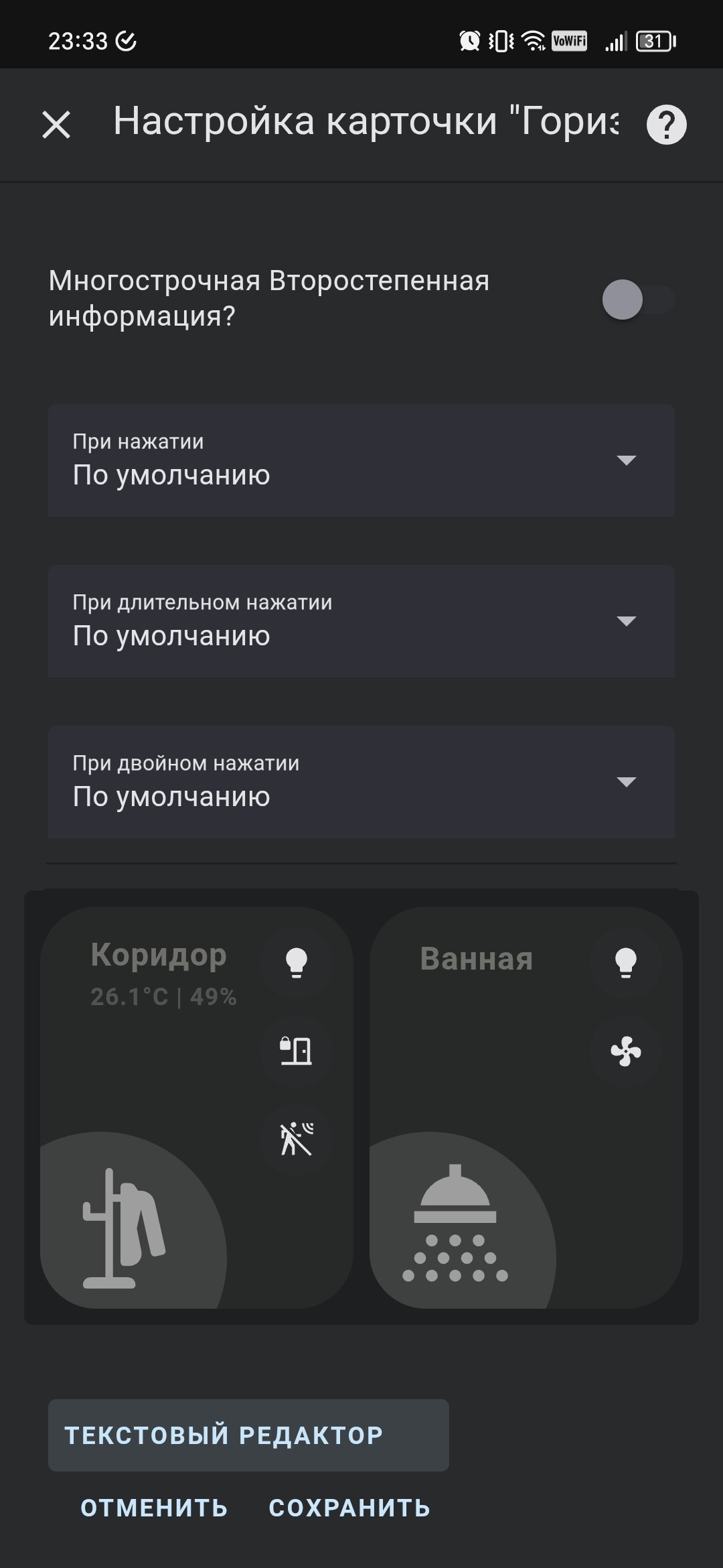

Hi guys. I need your help. I don’t know how to animate the chips in my room card.
Help please!
type: horizontal-stack
cards:
  - type: custom:vertical-stack-in-card
    cards:
        icon: hue:room-hallway
        icon_color: |-
          {% if is_state('switch.svet_koridor', 'on') %}
              #99FF99
          {% endif %}
          {% if is_state('switch.svet_koridor', 'off') %}
              grey
          {% endif %}
        primary: ŠšŠ¾Ń€ŠøŠ“Š¾Ń€
        secondary: |-
          {{ states ('sensor.klimat_koridor_temperature') }}°Д |
             {{states('sensor.klimat_koridor_humidity') | int }}%
        layout: horizontal
        card_mod:
          style:
            mushroom-state-info$: |
              .primary {
                font-size: 16px !important;
                position: relative;
                top: -42px;
                left: -125px;
                overflow: visible !important;
              .secondary {
                position: relative;
                top: -42px;
                left: -125px;
            mushroom-shape-icon$: |
              .shape {
                position: relative;
                left: -45px;
                top: 100px;
              ha-state-icon {
                --icon-symbol-size: 60px;
                  padding-right: 10px;
                  padding-left: 0px;
                  padding-bottom: 20px;
                  height: 70px;
                  width: 30px;
              ha-card {
                 --primary-text-color:  rgb(183,181,174, 0.5);
                 --secondary-text-color: rgba(183,181,174, 0.3) !important;;
                 background: none;
               :host {
                 --mush-icon-size: 126px;

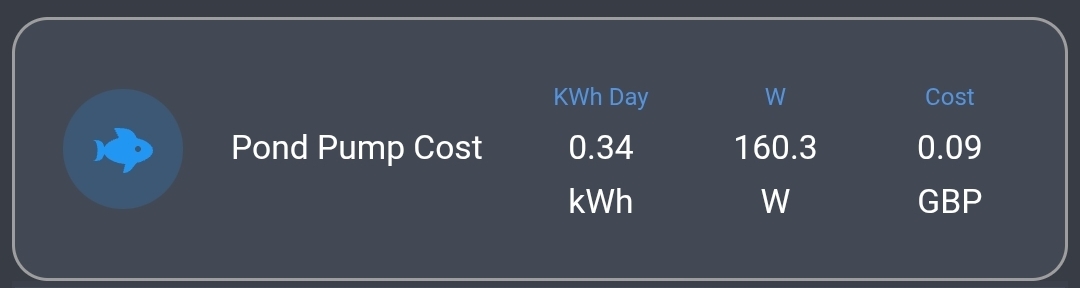

well yes, I use a completely over the top way that doesn’t use mushroom card on a multiple-entity-row (will work the same way for standard entity card)
type: custom:stack-in-card
card_mod:
  style: |
    ha-card {
      border: var(--grey-color) solid 1px !important ;
cards:
  - type: vertical-stack
    cards:
      - type: entities
        card_mod:
          style: |
            ha-card {
            --card-primary-font-size: 1.5rem;
            --card-secondary-color: var(--purple-color);
            border: 1px;
            box-shadow: none;
            background: rgba(0,0,0,0);
            margin-top: 0px;
        entities:
          - entity: sensor.pond_pumps_daily_energy_cost_2
            card_mod:
              style:
                hui-generic-entity-row $: |
                  .info.pointer .secondary ha-relative-time {
                      color: var(--blue-color);
                  state-badge:before {
                    content: '';
                    position: absolute;
                    top: 0px;
                    left: 0px;
                    width: 100%;
                    height: 100%;
                    border-radius: 50%;
                    opacity: 0.2;
                    {% if is_state(config.entity, 'home') %}
                    background: var(--red-color) !important;
                    {% else %}
                    background: var(--blue-color) !important;
                    {% endif %}
                  state-badge {
                    color: var(--red-color) !important;
                    {% else %}
                    color: var(--blue-color) !important;
                    {% endif %}
                  :host {
                    --paper-item-icon-color: var(--blue-color) !important;
                  ha-card {
                    box-shadow: none;
                    border: none;
                    margin-top: -10px;

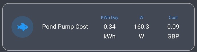

            type: custom:multiple-entity-row
            name: Pond Pump Cost
            icon: mdi:fish
            state_header: Cost
            format: precision2
            entities:
                format: precision2
              - entity: sensor.pond_pumps_power
                format: precision1
your have to play with colours and logic

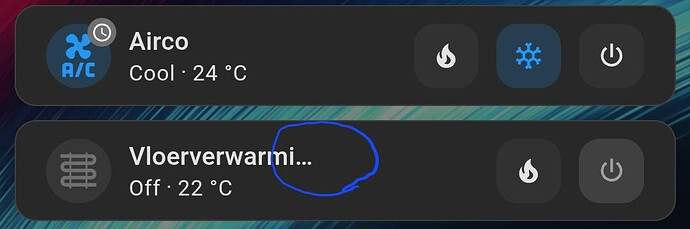

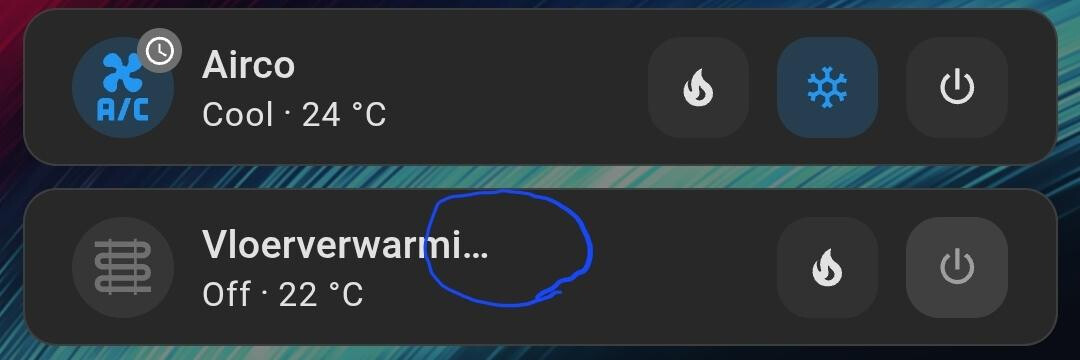

Hi lads,
what i was hoping was a simple issue turns out to be harder than i hoped,
and AI’s are looping the problem / throwing tantrums:
is there anyway to prevent the word ā€˜Vloerverwarming’ being cut?
I mean the ā€˜space’ is there :slight_smile:
(I’ve got cardmod etc installed)
Please provide your current code. The issue you have is fixable!
type: custom:mushroom-climate-card
entity: climate.vvw
grid_options:
  columns: 12
  rows: 1
fill_container: true
layout: horizontal
hvac_modes:
  - heat
  - "off"
show_temperature_control: false
icon: mdi:heating-coil
card_mod:
  style: |
    ha-card {
      border-radius: 12px;
      background: var(--secondary-background-color);
    /* Stronger overrides */
    .name, .label, .title {
      white-space: nowrap !important;
      text-overflow: clip !important;
      max-width: none !important;
      width: auto !important;
    /* Also override the container that may limit the text width */
    .info, .text-content {
this is the code with fixes i’ve already tried, the ideal sollution would be never to cut the text if its to wide id should be just ā€˜over’ stuff
With a column width of 12 it’s odd it’s getting cut off.
Try this and let me know…
card_mod:
  style:
      .container {
         align-items: baseline;
      ha-card {

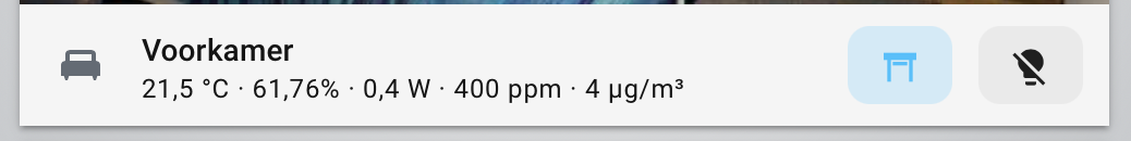

this can’t be coincidence… only yesterday did I find the space on my area cards secondary line used by the sensor classes too narrow, and several were showing the ellipsis, even though the action buttons were nowhere near…
I was thinking of scrolling that line (didnt make it yet) but we did find a way to take away space from those buttons with this:
style:
    .picture {
      filter: {{'grayscale(70%)' if is_state(config.entity,'off') else 'none'}};
    hui-card-features {
       width: calc(30% - var(--column-gap,0px)/ 2 - 12px) !important;
I’ve tried your align-items: baseline; on those features, but that has unexpected results :wink:
now area card isnt mushroom card, I am aware.
still, setting the width on your card here might also help?
That’s too funny, I thought about the method I provided after we discussed this yesterday…
 hui-card-features {
With multiple dash types and a myriad of device screen resolutions, I have been working towards more flexible CSS mod options.
exactly that. use relative methods And units where available seems most robust.
Should be in card-mod thread...
fwiw, I’ve noticed that setting that to
width: calc(20% - var(--column-gap,0px)/ 2 - 12px) !important;
makes the space a bit wider even, and if action buttons require, they auto-shrink :wink:
even
width: calc(20% - var(--column-gap,0px)/ 2 ) !important;
works, not sure where the finale - 12px was used
(note: it still is not 100% perfect, as it wont allow endless sensor_classes, or looks great on 3 buttons, but I would say for 95% of my area cards this suffices for now)
