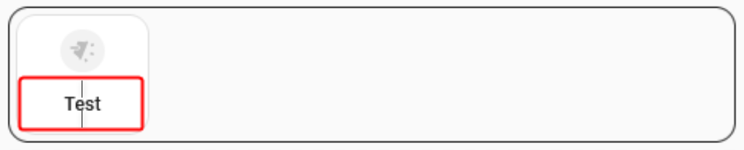

does anyone know how to reduce the spacing above and below the primary info text line in vertical layouut mode = above and below the word “Test” in the screenshot below?
My current code is looking like this:
type: custom:mod-card
style: |
  ha-card {
    background-color: light-grey;
    border: solid;
    border-width: 0.1em;
    border-color:light-gray;
    padding-top: 4px;
    padding-left: 4px;
    padding-right: 4px;
    padding-bottom: 4px;
card:
  type: horizontal-stack
  cards:
    - type: custom:mushroom-light-card
      entity: light.bathroom_lutz_dimmer_switch
      primary_info: name
      icon: mdi:light-flood-down
      layout: vertical
      secondary_info: none
      card_mod:
        style: |
          :host {
            --mush-icon-size: 28px;
            --card-primary-font-size: 12px !important;
            --card-primary-line-hight: 20px;
Here is a method
cards:
      entity: light.bathroom_lights
      primary_info: name
      layout: vertical
      card_mod:
       style:
        mushroom-state-info$: |
         .container {
         margin: -10px 0px;
          --card-primary-font-size: 12px;
         ha-state-icon {
          --icon-symbol-size: 28px;
Works like a charme, thanks a lot!

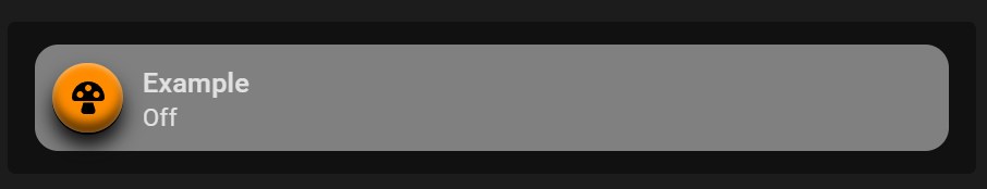

I tested it and it works.
type: custom:decluttering-card
template: test_template
variables:
  - name: Example
  - icon: mdi:mushroom
  - entity: light.night_stand
decluttering_templates:
  test_template:
    card:
      type: custom:mushroom-template-card
      entity: '[[entity]]'
      primary: '[[name]]'
      icon: '[[icon]]'
      icon_color: |
        {% if is_state('[[entity]]', 'on') %}
          white
        {% else %}
         black
        {% endif %}
      secondary: |
        {{state_translated('[[entity]]') }}
      tap_action:
        action: toggle
      hold_action:
        action: more-info
      card_mod:
        style:
          mushroom-shape-icon$: |
            .shape {
               background: darkorange !important;
               box-shadow: 0px 1px 0px 0px rgb(0,0,0),
               0px 7px 10px 0px rgb(10,10,10),
               inset 0px 1px 3px 0px rgba(250, 250, 250, .5),
               inset 0px -5px 5px 0px rgba(0, 0, 0, .6) !important;
            ha-card {
             background: grey !important;
              --icon-symbol-size: 20px;}
