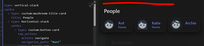

How do i go about removing the padding here, please?
type: custom:mushroom-title-card
card_mod:
  style: |
    ha-card {
        margin-top: -20px;
title: Hello, {{ user }} !

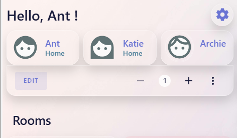

Any help idea how i make this button horizontally align to the title, please?
Code:
type: vertical-stack
cards:
  - type: horizontal-stack
    cards:
      - type: custom:mushroom-title-card
      - type: custom:button-card
        tap_action:
          action: call-service
          service: |
              this.dispatchEvent(new Event('hass-toggle-menu', { bubbles: true, composed: true }));
              return none;
        hold_action:
          action: url
          url_path: null
        icon: mdi:cog
        color: var(--primary-color)
        show_name: false
        styles:
          card:
            - width: 45px
            - height: 45px
            - border-radius: 99px
            - margin: 0 0 0 -8px
          icon:
            - width: 30px
    cards:
        tap_action:
          action: navigate
          navigation_path: "#ant"
        entity: person.ant
        show_icon: false
        show_name: true
        show_state: true
        state:
          - value: Work
            styles:
              state:
                - color: rgba(221,87,70,0.7)
          - value: not_home
            styles:
              state:
                - color: "#79AC78"
        custom_fields:
          skin:
            card:
              tap_action:
                action: navigate
              icon: mdi:circle
              styles:
                card:
                  - box-shadow: none
                  - border: none
                icon:
                  - height: 50px
                  - width: 50px
                  - color: var(--skin-color)
          face:
            card:
              tap_action:
                action: navigate
              icon: mdi:face-man
              styles:
                card:
                  - background: none
                  - box-shadow: none
                  - border: none
                icon:
                  - width: 55px
                  - color: var(--face-color)
        styles:
          card:
            - background: var(--card-background-color)
            - height: 70px
            - border-radius: 20px
            - padding: 15px
          name:
            - position: absolute
            - bottom: 45%
            - left: 53%
            - font-size: 18px
            - font-weight: 600
            - color: var(--primary-color)
          state:
            - bottom: 21%
            - left: 53%
            - font-size: 14px
            - font-weight: 550
            - color: "#51829B"
          custom_fields:
            skin:
              - bottom: 11%
              - left: 8%
            face:
              - bottom: 7%
              - left: 6%
        tap_action:
          action: navigate
          navigation_path: "#katie"
        entity: person.katie
        show_icon: false
        show_name: true
        show_state: true
        state:
          - value: Work
            styles:
              state:
          - value: not_home
            styles:
              state:
                - color: "#79AC78"
        custom_fields:
          skin:
            card:
              tap_action:
                action: navigate
              icon: mdi:circle
              styles:
                card:
                  - box-shadow: none
                  - border: none
                icon:
                  - height: 50px
                  - width: 50px
          face:
            card:
              tap_action:
                action: navigate
              icon: mdi:face-woman
              styles:
                card:
                  - background: none
                  - border: none
                  - border-radius: 0px
                  - box-shadow: none
                icon:
                  - width: 55px
        styles:
          card:
            - height: 70px
            - padding: 15px
          name:
            - bottom: 45%
            - left: 54%
            - font-size: 18px
            - font-weight: 600
          state:
            - bottom: 21%
            - left: 54%
            - font-size: 14px
            - font-weight: 550
            - color: "#51829B"
          custom_fields:
            skin:
              - bottom: 11%
              - left: 8%
            face:
              - bottom: 7%
              - left: 6%
        tap_action:
          action: navigate
          navigation_path: "#archie"
        entity: person.person
        show_icon: false
        show_name: true
        show_state: true
        state:
          - value: Work
            styles:
              state:
          - value: not_home
            styles:
              state:
                - color: "#79AC78"
        custom_fields:
          skin:
            card:
              tap_action:
                action: navigate
              icon: mdi:circle
              styles:
                card:
                  - box-shadow: none
                icon:
                  - height: 50px
                  - width: 50px
          face:
            card:
              tap_action:
                action: navigate
              icon: mdi:face-man-outline
              styles:
                card:
                  - background: none
                  - box-shadow: none
                icon:
                  - width: 55px
        styles:
          card:
            - height: 70px
            - padding: 15px
          name:
            - bottom: 45%
            - left: 54%
            - font-size: 18px
            - font-weight: 600
          state:
            - bottom: 21%
            - left: 54%
            - font-size: 14px
            - font-weight: 550
            - color: "#51829B"
          custom_fields:
            skin:
              - bottom: 11%
              - left: 8%
            face:
              - bottom: 7%
              - left: 6%

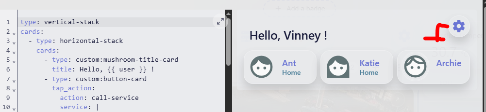

I am getting closer - but now the title is center aligned ! Help :smiley:
cards:
    card_mod:
      style: |
        ha-card {
          display: flex !important;
          align-items: center !important;
    cards:
        card_mod:
          style: |
            ha-card {
              height: 45px !important;
        tap_action:
          service: |
              return none;
        hold_action:
          action: url
          url_path: null
        icon: mdi:cog
        show_name: false
        styles:
          card:
            - width: 45px
            - height: 45px
          icon:
            - width: 30px

Right this is as close as i can get - ive dtiched the mushroom title card - alignment is fine now, however the font doesnt match the other cards:
cards:
    card_mod:
      style: |
        ha-card {
          margin-top: -20px;
    cards:
            return `Hello, ${hass.user.name} !`;
        show_icon: false
        show_name: true
        show_state: false
        tap_action:
          action: none
        styles:
          card:
            - background: transparent
            - border: none
            - box-shadow: none
            - padding: 0
            - height: 45px
            - display: flex
            - align-items: center
            - justify-content: flex-start
          name:
            - font-size: 28px
            - font-weight: 600
            - color: var(--primary-text-color)
            - text-align: left
            - justify-self: flex-start
            - font-family: inherit
            - line-height: 1.2
        tap_action:
          service: |
              this.dispatchEvent(new Event('hass-toggle-menu', { bubbles: true, composed: true}));
              return none;
        hold_action:
          action: url
          url_path: null
        icon: mdi:cog
        show_name: false
        styles:
          card:
            - width: 45px
            - height: 45px
          icon:
            - width: 30px

Solved:
cards:
    card_mod:
      style: |
        ha-card {
          margin-top: -20px;
    cards:
        show_icon: false
        show_name: true
        show_state: false
        tap_action:
          action: none
        styles:
          card:
            - border: none
            - box-shadow: none
            - padding: 0
            - height: 45px
            - display: flex
          name:
            - font-size: var(--mush-title-font-size, 24px)
            - font-weight: var(--mush-title-font-weight, 600)
            - color: var(--mush-title-text-color, var(--primary-text-color))
            - text-align: left
            - font-family: var(--mush-title-font-family, inherit)
            - line-height: var(--mush-title-line-height, 1.2)
        tap_action:
          service: |
              return none;
        hold_action:
          action: url
          url_path: null
        icon: mdi:cog
        show_name: false
        styles:
          card:
            - width: 45px
            - height: 45px
          icon:
            - width: 30px
    cards:

      entity: person.2
      content_info: none
      use_entity_picture: true
      tap_action:
        action: navigate
        navigation_path: "#profile"
  - type: conditional
    conditions:
      - condition: user
        users:
          - 3
    chip:
      type: entity
      entity: person.3
      content_info: none
      tap_action:
        action: navigate
alignment: end
card_mod:
  style: |
    ha-card {
        margin-top: 20px;
    mushroom-entity-chip:nth-child(2) ha-card,
    mushroom-entity-chip:nth-child(3) ha-card,
    mushroom-entity-chip:nth-child(4) ha-card {
        {% set person_entity = entity %}
        {% if is_state(person_entity, 'home') %}
          --chip-border-color: #097969 !important;
        {% elif is_state(person_entity, 'away') %}
          --chip-border-color: red !important;
        {% else %}
          --chip-border-color: grey !important;
        {% endif %}

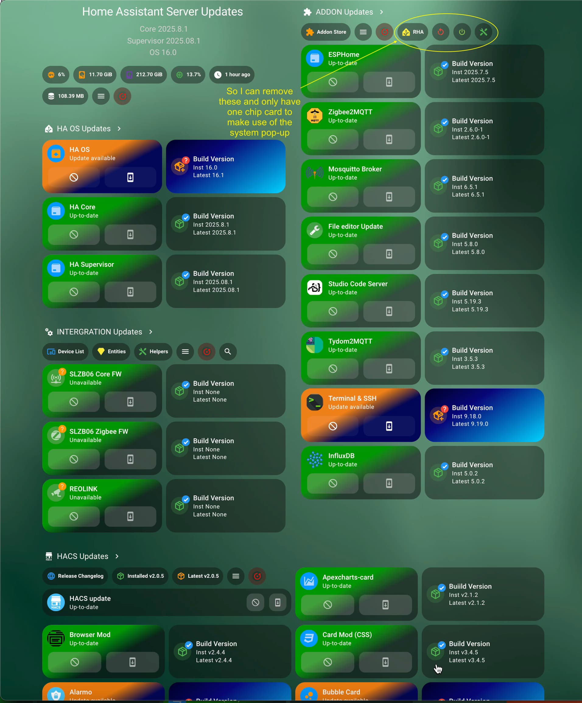

Hello everyone,
I am building myself a dedicated page (dashboard with mushroom cards) for all updates for HA, its intergrations and addons and HACS and any extras to be all in one place with tools to accommodate pre tasks (like link to backup page etc) before any update is initiated.

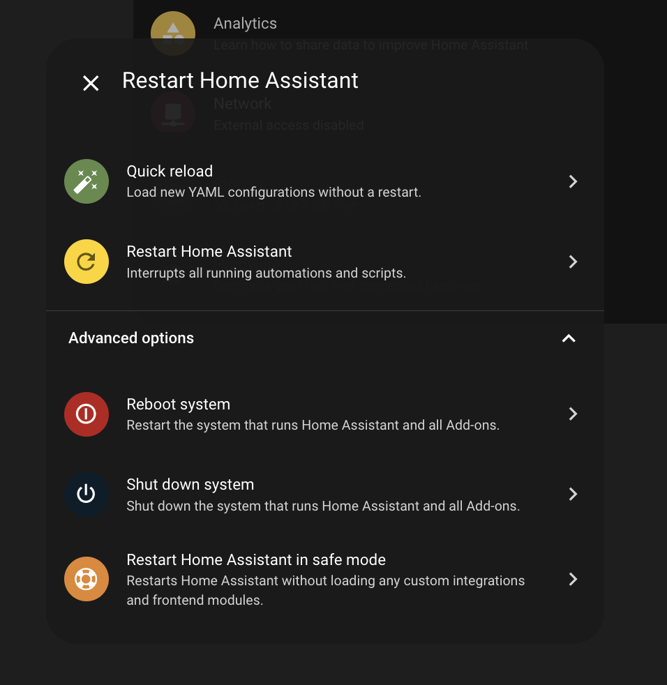

@dimitri.landerloos
Do you think it is possible to invoke the native shutdown pop-up window (like a VB modal or lightbox applet) on the system page via a chip card via script or code etc?
I was wondering if I could also do this via Card Mod on the chip card.
The pop-up is a good option as it has safety built in as a 2 or 3 click choice and confirmation before initiating any of the options.
Again, it is so all necessary tools for maintenance tasks are in one place.
I would place a short screen video capture to show what I mean but I’m not sure as a limited member I can do this yet…
Please note… I already have the basic chip cards setup to invoke the standard entities but they are dangerous as all you need to do is accidentally glide and click your mouse over the chip card and boom down goes your system plus there is no confirmation that you are about to preform the reboot or shutdown action.
I suppose you could build one in manually but really I am after the official Modal pop-up as it has all the choices and protective confirmations already in place.
Any thoughts appreciated… ?
Thanks in advance.
Screen shot examples below.
