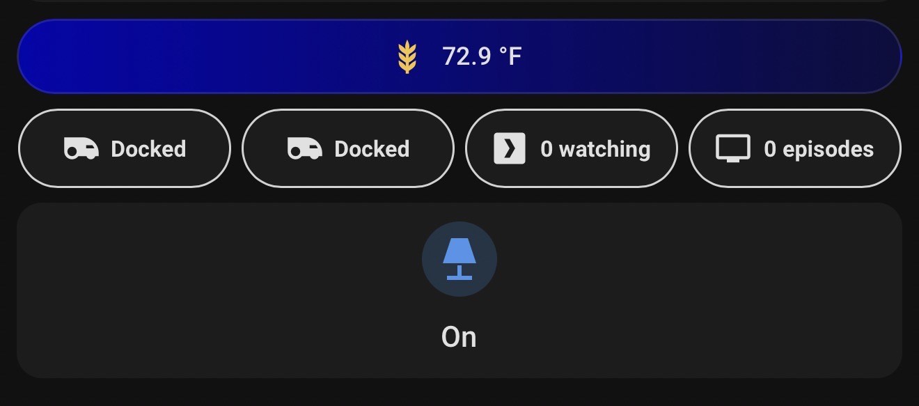

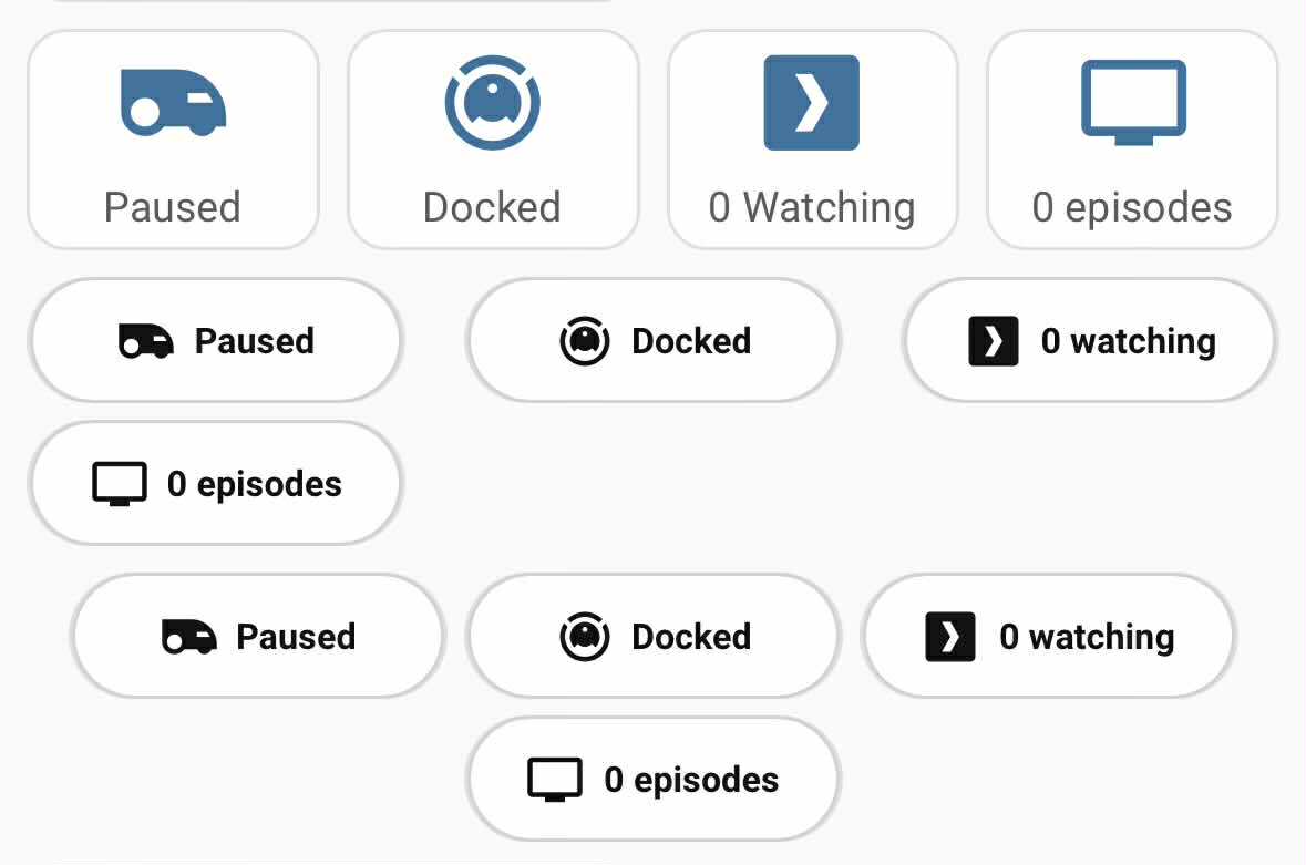

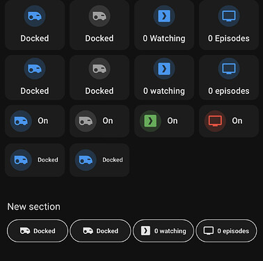

Thanks! Looks great on browser (top chips justify, bottom chips center):
But on the wall tablet it wraps the rows. Does the same if I narrow the browser window - just for a small bit of width between dropping from 3 to 2 columns/sections. Bit hard to get a screenshot from that but on mobile where it’s one column, it does pretty much the same:
To be fair, looking at it on mobile, I think the width of the chips will always be an issue with the icon on the side.
Have also tested making the mushroom-entity card’s height 80px to be about the same as the standard buttons - but that defeats the purpose of having the smaller chips.
Thanks for your help though - now that I know the bits I need to tweak, will have a play.
Test adjusting the width down to 100px. It will work better across multiple devices.
width: 100px !important;
If you want to go this route with the Mushroom Entity card, I’d suggest using a horizontal stack with the Sections dash for the four cards. It tricks the Sections dash to only use 1 row vs 2.
Another option
If you switch to the Mushroom Template card, it would allow you to control the Sections row height with some precision. It would still be larger than 1 row with a vertical layout.
layout: vertical
grid_options:
  rows: 1.3
  columns: 3
Moving to a horizontal layout with the template card would require reducing the font and icon size to shrink to the size of a chip.
Ta - had to get it down to 85px to fit on my iPhone 14’s app screen.
Alas 85px is too small for the other screens - pretty much the same size as the original chips.
I think I’m expecting a bit too much. Do appreciate your help though!

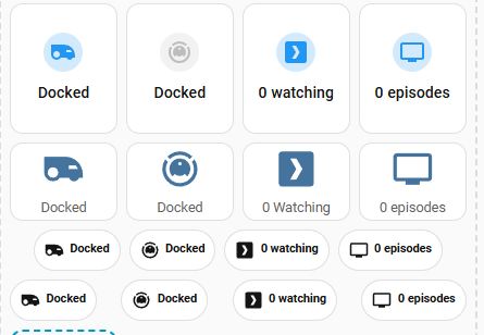

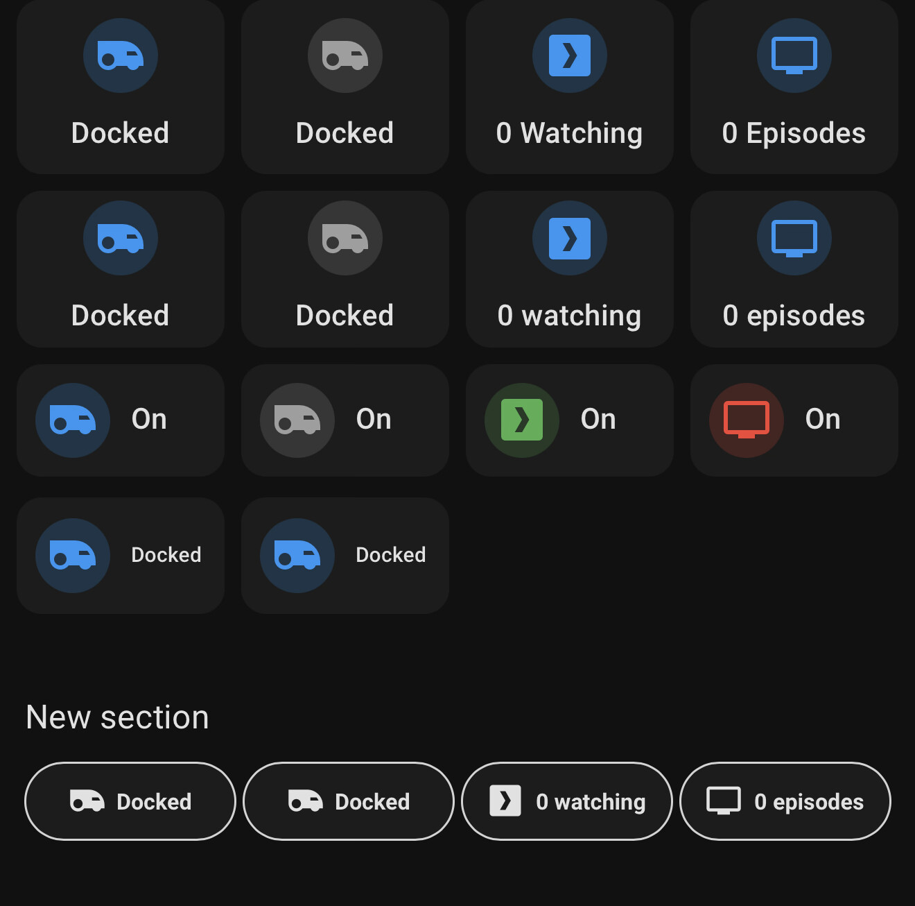

Sections will adjust according to the device you are using. With other dashboards types you have to set different values using the @media CSS option
@Media Guide
I worked through several iterations, but we can generate what you want in multiple ways with card_mod
Screenshots from my iPhone 16
Sections
Masonry Dash

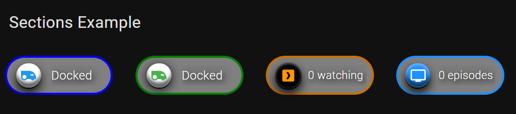

@KablammoNick An example to play with the Sections dash to highlight one method to mimic chips.
type: grid
cards:
  - type: heading
    heading: Sections Example
    heading_style: title
    primary: "{{ 'Docked' if is_state(entity, 'on') else 'Away' }}"
    icon_color: blue
    icon: mdi:robot-mower
    grid_options:
      columns: 3
    entity: light.night_stand
    card_mod:
      style:
        mushroom-shape-icon$: |
          .shape {
             background: white !important;
             box-shadow: 0px 1px 0px 0px rgb(0,0,0),
             0px 5px 10px 0px rgb(10,10,10),
             inset 0px 1px 3px 0px rgba(250, 250, 250, .5),
             inset 0px -5px 3px 0px rgba(0, 0, 0, .6) !important;
        mushroom-state-info$: |
          .primary {
              font-size: 12px !important;
              color: white !important;
              text-shadow: 2px 2px 5px black, 5px 5px 15px grey, 0 0 15px black;
              font-weight: 300 !important;
          ha-card {
            margin-top: 10px;
            background: grey !important;
            width: 105px !important;
            height: 38px !important;
            --icon-symbol-size: 16px;
            --icon-size: 24px;
            border-radius: 19px;
            border: 2px solid blue;
    icon_color: green
    grid_options:
      columns: 3
    card_mod:
      style:
          .shape {
             0px 2px 10px 0px rgb(10,10,10),
          .primary {
          ha-card {
            margin-top: 10px;
            --icon-size: 24px;
            border: 2px solid green;
    primary: 0 watching
    icon_color: orange
    icon: mdi:plex
    grid_options:
      columns: 3
    card_mod:
      style:
          .shape {
            margin-left: -2px;
             background: black !important;
          .primary {
              margin: -4px;
              font-size: 11px !important;
              font-weight: 300 !important;}
          ha-card {
            margin-top: 10px;
            --icon-symbol-size: 14px;
            --icon-size: 26px;
            border: 2px solid #cc7000;
    primary: 0 episodes
    icon_color: white
    icon: mdi:television
    grid_options:
      columns: 3
    card_mod:
      style:
          .shape {
             margin-left: -2px;
             background: #1E90FF !important;
          .primary {
              margin: -2px;
          ha-card {
            margin-top: 10px;
            --icon-size: 24px;
            border: 2px solid #1E90FF;
  .primary {
      alignment: center;
  .primary {
      justify-content: center;
You’ll most likely want to use a margin offset
      card_mod:
       style:
         .primary {
           margin-left: 15px ;
          ha-card {
            background-color: transparent;
            border-color: transparent;
            box-shadow: none;
          ha-state-icon {
          {% if is_state('binary_sensor.is_pubercave_pc_on', 'on')%}
            animation: boing 3s ease infinite;
            transform-origin: 50% 90%;
          {% endif %}
An align value will move the field too far in my opinion
      card_mod:
       style:
         .primary {
           text-align: center;
          ha-card {
That’s it. Thank you so much… tried for hours, and within 10 mins after asking here it’s resolved. Crazy.
edit: looks great now. Many thanks again.
whenever I need to move things to the center of the available space, I use
transform: translateX(50%) ;
I cant replicate the card, but it seems to work
     .primary {
if at all possible, I prefer that over the hardcoded options
I 100% agree, but with the provided code, options were limited. The primary field width would also need adjusted to use transform:
          .primary {
            transform: translateX(15%) ;
            width: 100px;
right.
which would make it kind of moot :wink:
You can take it to a container level and use this :arrow_down: for a more flexible option.
    card_mod:
      style:
          .container {
            text-align: center !important;
            display: inline-flex !important;
