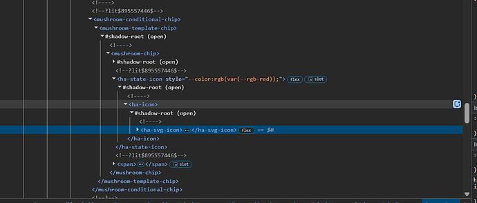

And here is the DOM in the HTML
Any help would be much appreciated!!!

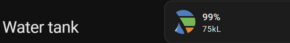

@LiQuid_cOOled : Hi! Would you have an idea and can help me please? Many many thanks in advance!!
Hi, I understand there may have been some changes to mushroom that have affected the code I used to display images based on the depth of water in my tank. I’d appreciate some help it getting them to display again.
type: horizontal-stack
cards:
  - type: custom:mushroom-title-card
    title: Water tank
    subtitle_tap_action:
      action: none
    title_tap_action:
      action: none
    primary: "{{ states(entity) }}%"
    secondary: >-
      {{ ((states('sensor.water_tank_current_volume') | float) / 1000 ) | int}}
      kL
    icon: none
    entity: sensor.water_tank_level_percent
    hold_action:
      action: none
    double_tap_action:
      action: none
    icon_color: ""
    badge_color: ""
    multiline_secondary: false
    tap_action:
      action: none
    features_position: bottom
    card_mod:
      style:
        mushroom-shape-icon$: |
          .shape {
            {% set water_level = states(entity) | int %}
            {% if water_level > 80 %}
              background: url('/local/community/my-icons/water_5.png') no-repeat center;
            {% elif water_level > 60 %}
              background: url('/local/community/my-icons/water_4.png') no-repeat center;
            {% elif water_level > 40 %}
              background: url('/local/community/my-icons/water_3.png') no-repeat center;
            {% elif water_level > 20 %}
              background: url('/local/community/my-icons/water_2.png') no-repeat center;
            {% else %}
              background: url('/local/community/my-icons/water_1.png') no-repeat center;
            {% endif %}
            background-size: contain;
            --shape-color: none;

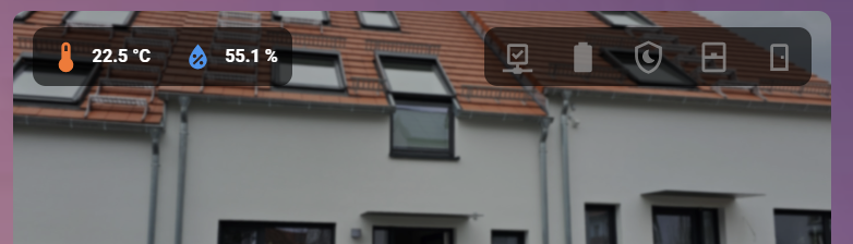

Hi together,
I would like to bring my chips closer to each other, similar as mentioned at https://github.com/thomasloven/lovelace-card-mod/issues/414 . I tried with card_mod with --mush-chip-spacing: -5px. I currently have set to 0px, but need it even closer
Many many thanks!!
My dashboard card (one example)…
My code (example)…

        mdi:battery
      {% endif %}
    icon_color: |
      {% if is_state(entity, 'on') %}
        var(--corian-red)
      {% else %}
        var(--corian-gray)
      {% endif %}
    tap_action:
      action: more-info
    double_tap_action:
      action: navigate
      navigation_path: /dashboard-haus/infrastruktur
    card_mod:
      style: |
        ha-card {
          border-width: 0px !important;
  - type: template
    entity: sensor.beschattungsfreigabe
    icon: |
        mdi:shield-sun
      {% else %}
        mdi:shield-moon-outline
      {% endif %}
    icon_color: |
        var(--corian-blue)
      {% else %}
        var(--corian-gray)
      {% endif %}
    tap_action:
      action: more-info
    double_tap_action:
      action: navigate
      navigation_path: /dashboard-haus/klima
    card_mod:
      style: |
        ha-card {
  - type: template
    entity: binary_sensor.hausfenster
    icon: |
        mdi:window-open
      {% else %}
        mdi:window-closed
      {% endif %}
    icon_color: |
        var(--corian-amber)
      {% else %}
        var(--corian-gray)
      {% endif %}
    tap_action:
      action: more-info
    double_tap_action:
      action: navigate
      navigation_path: /dashboard-haus/sicherheit
    card_mod:
      style: |
        ha-card {
  - type: template
    entity: binary_sensor.haustueren
    icon: |
        mdi:door-open
      {% else %}
        mdi:door
      {% endif %}
    icon_color: |
        var(--corian-amber)
      {% else %}
        var(--corian-gray)
      {% endif %}
    tap_action:
      action: more-info
    double_tap_action:
      action: navigate
    card_mod:
      style: |
        ha-card {
alignment: end
card_mod:
  style: |
    ha-card {
      position: absolute;
      top: 10px;
      right: 12px;
      #box-shadow: 0px 1px 3px 0px rgba(158, 158, 158, 0.7) !important;
      background: rgba(0, 0, 0, 0.6) !important;
      border-radius: 8px !important;
    :host {
      --chip-icon-size: 22px !important;  /* Default is 24px */
      --mush-chip-spacing: -5px; /* Standard ist 8px */
Why not just template the picture field
Just an example of what I mean :arrow_down:
    secondary: "{{ ((states('sensor.water_tank_current_volume') | float) / 1000 ) | int(0)}}kL"
    tap_action:
      action: none
    picture: |
      {% set water_level = states(config.entity) |int(0) %}
          {% if water_level > 80 %} /local....
          {% elif water_level > 60 %} /local....
          {% elif water_level > 40 %} /local....
          {% elif water_level > 20 %} /local....
          {% else %}
          {% endif %}
Thanks. I’ll try it. I have very little experience with this stuff so appreciate the assistance.
I’d just followed the example someone posted and have been using for a couple of years successfully.
Card mod is an alternative but not really necessary for what you are trying to achieve. Either way I can assist further if you run into a roadblock.
Its very close. Is there a way to have the whole image rather than a circular section?
original image is
thanks
I’m trying to get my badge icon to blink, but following the given example doesn’t seem to work:
card_mod:
  style: |
    mushroom-badge-icon {
      animation: blink 1s linear infinite;
    @keyframes blink {
      50% {opacity: 0;}
Altough, this works, but blinks the whole card:
card_mod:
  style: |
    :host {
    @keyframes blink {
      50% {opacity: 0;}

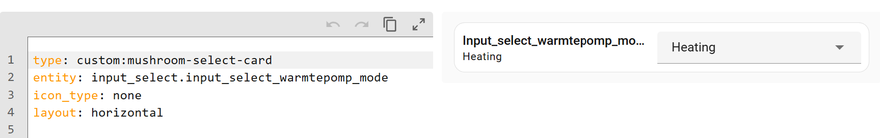

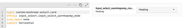

Hi Dimtri,
Great cards thanks for your work.
A question abot styling the fonts from a select card.
I want to style the text from the entity. Only the italics cause to affect al fonts.
I tried the different styling options in the Styling/config guide but no option wil affect th font of the name of the entity or the value.
What am i doing wrong.
