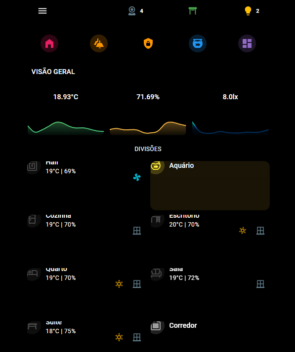

For some reason, even copying cards that are “ready” they still show the icon as small. This has been like this for over a year, I’ve tried fixing it, gave up, tried, gave up, tried, gave up, and now I’m gonna try again.
My Home Assistant can’t seem to reproduce the same way. What can I be doing wrong?!
The first screenshot is a recently “adapted” card and the icon still shows very small compared to the cards people been working on.
I’ve even tried reverting to the 3.4.4 version, still same results. Can’t even revert to the point they look like they were (with the big icon, I’m pretty sure you understand what I mean).
Guys, I’m sorry but I’m really lost lol. I’ve read this entire thread and no results. Tried over 10 cards, nothing. It has to be something so silly that I can’t even think off

Perhaps try adding !important to --icon-size.
Also, if you have been upgrading/downgrading etc, make sure to check out recommendations at Issues after upgrading any version - 3.x.x, 4.x.x · Issue #525 · thomasloven/lovelace-card-mod · GitHub
The darkness you see is because you are using Outset, you can use a different style to achieve a different effect:
You probably just want to change it to solid :slight_smile:

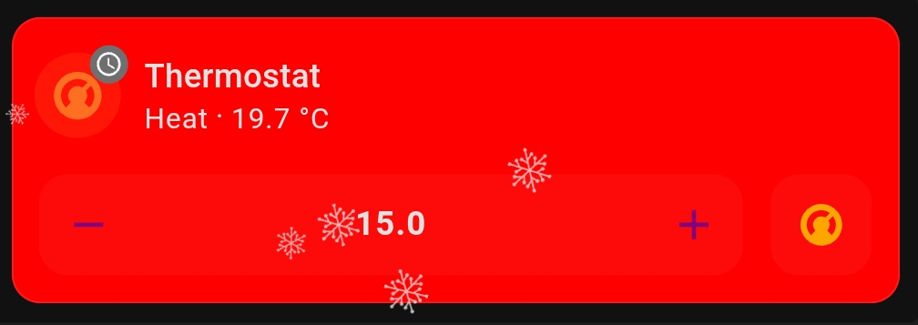

I must be doing something wrong with my card_mod ordering or syntax, because I’m running into a similar issue with my climate cards. I can’t set background color and icon color simultaneously.
I have this:
…coded as such:
card_mod:
  style: |
    ha-card {
    {% if is_state('climate.heat_pump_basement', 'heat') %}
      background-color: var(--background-hvac-heat);
    {% elif is_state('climate.heat_pump_basement', 'cool') %}
      background-color: var(--background-hvac-cool);
    {% elif is_state('climate.heat_pump_basement', 'dry') %}
      background-color: var(--background-hvac-dry);
    {% elif is_state('climate.heat_pump_basement', 'fan_only') %}
      background-color: var(--background-hvac-fan);
    {% else %}
      background-color: var(--background-hvac-off);
    {% endif %}
      --card-primary-font-size: 16px;
      --card-secondary-font-size: 14px;
      --card-primary-color: var(--primary-text-color);
      --card-secondary-color: var(--primary-text-color);
      --primary-text-color: var(--primary-text-color);
…and I want to set the buttons to the same color as the temperature setpoint, so I edit to add this:
    mushroom-climate-temperature-control$:
      mushroom-input-number$: |
        #container .button:nth-child(1) {
          --card-mod-icon-color: var(--primary-text-color);
        } #container .button:nth-child(3) {
    ha-card {

…and end up with this:
could you simplify that first? just use red or some other significant color to spot, and maybe add !important.
if you get that to work, then add the templates.
makes it easier to debug
Right you are… I was encouraged that at least the templates were working because I was seeing my changes… but other mods were being undone at the same time.
So, this results in a red background:
card_mod:
  style: |
    ha-card {
      background-color: red;
…and it appears this added code to change button color isn’t doing anything at all:
card_mod:
  style: |
    ha-card {
          --card-mod-icon-color: purple;

I didnt check any of the selectors, just the syntax for combining modifications to $: and final .:
Deleting my comment and editing for clarity…
A direct copy from @dimitri.landerloos’s original post (with my colors inserted) works:
card_mod:
  style:
Unfortunately, I don’t know the name of that button on the right side to alter the color of that. But that aside… I’m still unable to get the button color and card background color to work simultaneously. I’ve tried the suggestions you made above to no avail… your code above results in the background turning red, but default button colors.
card_mod:
  style:
    mushroom-button$: |
      .button  ::slotted(*) {
        --card-mod-icon-color: orange;
      ha-card {
        background: red;
Even got that last button for you :wink:
Dont mind the snow flakes, my wife loves the new experimental feature :slight_smile:
That’s outstanding! :smiley:
