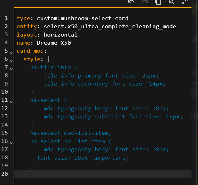

I’m trying to increase the text size in a drop-down menu, but it’s not working. Can you tell me how to do this in a select card?
type: custom:mushroom-select-card
entity: select.x50_ultra_complete_cleaning_mode
layout: horizontal
card_mod:
style: |
ha-tile-info {
–tile-info-primary-font-size: 22px;
–tile-info-secondary-font-size: 14px;
ha-select {
–mdc-typography-body1-font-size: 18px;
–mdc-typography-subtitle1-font-size: 18px;
ha-select mwc-list-item,
ha-select ha-list-item {
font-size: 18px !important;
This will get you started

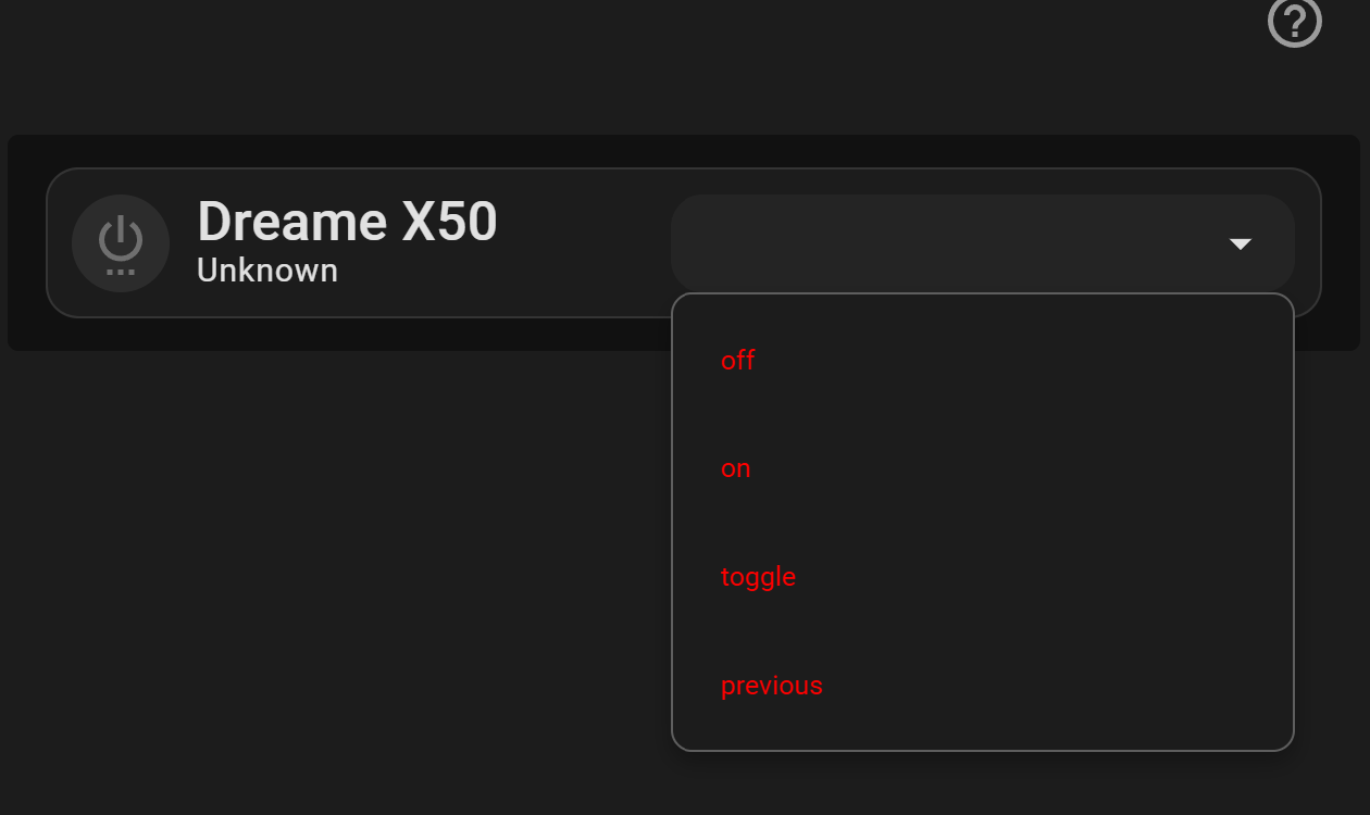

layout: horizontal
card_mod:
  style:
    mushroom-select-option-control$:
     ha-control-select-menu$:
      ha-dropdown-item$: |
       #label{
        color: green;
        font-size: 10px;
    mushroom-state-info$: |
      .container {
       --card-primary-font-size: 20px;
       --card-secondary-font-size: 12px;

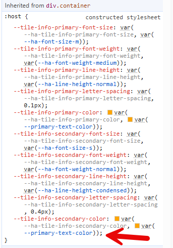

I was trying to change the --primary-text-color and --secondary-text-color of mushrom-template-card. The --primary-text-color works, but the --secondary-text-color always get the same color as the --primary-text-color.
I used Dev Tools to peek the CSS and found this bug:
That should be --secondary-text-color.
I don’t know how to report this bug to the dev team. Note, I am using 2026.2.3 core version.
So, I am using this as workaround:
          card_mod:
            style: |
              :host {
              --ha-tile-info-primary-color: #FFFFFF;
              --ha-tile-info-secondary-color: #999999;
That is on Mushroom? Then go to the repo and file an issue, by clicking the Issue tab and click New Issue, then follow the template you need to fill out. Should be painless and self explanatory
Style does come from Frontend but also there is a note in the file that this is by design.
So your override is needed as expected if you wish to have it as different color. I suppose the reasoning is that for tile, secondary is smaller font and condensed line height, but not a different color.

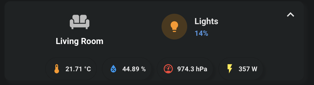

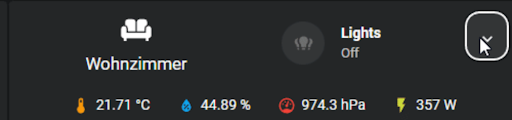

Hi Everyone. I’m trying to re create this example card from the Expander Card github page.
I have gotten very close, but I keep getting the drop shadows around the chips, which if you look closely you can see faintly here:
I have tried a ton of things to get rid of them with card-mod, but so far the only thing that works is to put the following in my theme.
mush-chip-box-shadow: “none”
mush-chip-border-color: “transparent”
Of course I don’t like this because it will remove them from all mushroom chip cards which I
don’t want to do. Does anyone have any idea how to properly apply this change with card-mod? My full card code is here, but the only thing I’m trying to style is the chips at the end:
  - type: custom:expander-card
    child-margin-top: 0.6em
    padding: 0
    clear: true
    title-card-button-overlay: true
    title-card-clickable: true
    expanded: true
    title-card:
      type: custom:vertical-stack-in-card
      cards:
        # --- TOP ROW ---
        - type: horizontal-stack
          cards:
              primary: Living Room
              icon: mdi:sofa
              layout: vertical
              card_mod:
                style:
                  mushroom-shape-icon$: |
                    .shape {
                      background: none !important;
                      --shape-color: transparent !important;
                    ha-card {
                      border: none !important;
                      box-shadow: none !important;
                      /* This moves the entire card (icon + text) up by 6px */
                      margin-top: -15px !important;
                    mushroom-state-info {
                      margin-top: -25px !important; /* Keeps the tight text-to-icon gap */
                    mushroom-state-item {
                      gap: 0px !important;
                    :host {
                      --mush-icon-size: 70px;
                      --primary-text-color: white;
                      --primary-font-weight: 660;
            - type: custom:mushroom-light-card
              entity: light.fibaro_dimmer_2_living_room_spotlight
              card_mod:
                style: |
                  ha-card {
                    /* Reduced from 35px to 18px */
                    margin-top: 8px !important;
                    /* Ensures the card doesn't cut off the text */
                    width: 100% !important;
        # --- BOTTOM ROW (Chips) ---
        - type: custom:mushroom-chips-card
# remember you disabled the drop shadows from all mushroom cards in your themes to get rid of them here
          alignment: center
          chips:
            - type: template
              icon: mdi:thermometer
              icon_color: orange
              content: "21.71 °C"
            - type: template
              icon: mdi:water-percent
              icon_color: blue
              content: "44.89 %"
            - type: template
              icon: mdi:gauge
              icon_color: red
              content: "974.3 hPa"
            - type: template
              icon: mdi:flash
              icon_color: yellow
              content: "357 W"
Thanks in advance for any ideas you may have.

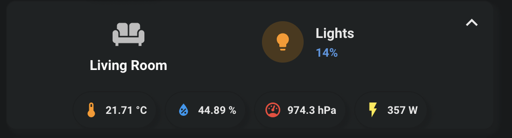

Im using uix now rather than card mod, but should work exactly the same if you replaced the uix: with card_mod:
          alignment: center
          chips:
            - type: template
              icon_color: orange
              content: "21.71 °C"
              uix:
                style: |
                  ha-card {
Ah yes, we are finally onto something. Thanks for the quick reply!! I didn’t consider putting them under the chips themselves rather than for the card as a whole. So, your suggestion did get rid of the box-shadow, but there is still a faint border. I tried
border-color: "transparent" !important
but it didn’t work. Any ideas?
Here’s how it stands now (drop shadow gone only from first chip, but thin border remains)
Current code:
          alignment: center
          chips:
            - type: template
              icon_color: orange
              content: "21.71 °C"
              card_mod:
                style: |
                  ha-card {
            - type: template
              icon_color: blue
              content: "44.89 %"
            - type: template
              icon: mdi:gauge
              icon_color: red
            - type: template
              icon: mdi:flash
              icon_color: yellow
              content: "357 W"
Okay. It’s just border. So the final solution looked like this:
                style: |
                  ha-card {
Thank you Dimitri!
