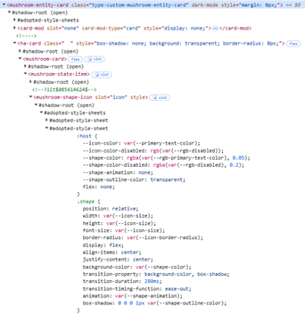

Using Chrome Developper’s Tool, I pinpoint the style declaration I need to alter. See the picture:
My guess is
mushroom-shape-icon
  .shape
     background-color
must be set to the value I want.
But how, in YAML in the card-mod/style section, do I declare the style change?
Suggest you migrate from card_mod to UIX. UIX now has DOM helpers, one which is uix_path() which gives boilerplate code to target element selected in Browser inspector. No more guessing.
Thanks, I’ll give it a try.
