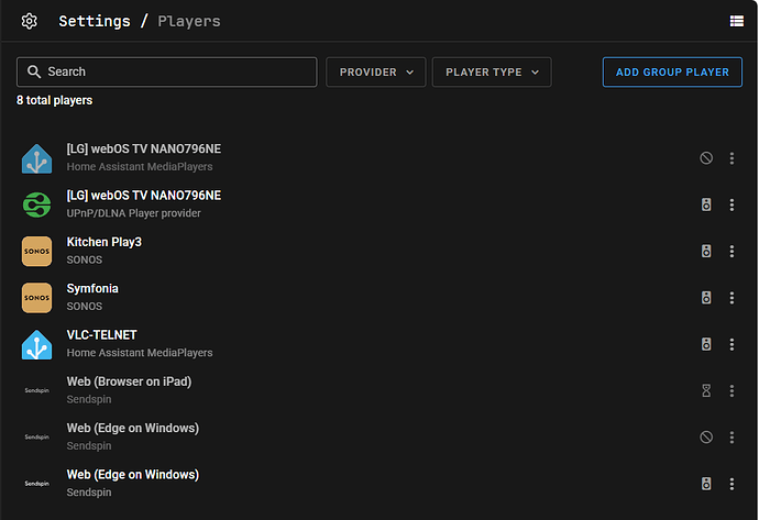

I seem to be close to having a working version of Music Assistant in HA, BBC Sounds, Spotify and media I have in my local HA media folder. I have a number of player providers configured. However, my current challenge is to get the content to actually play. I suspect there may be conflicting settings with multiple services trying to control the players.
I have a Sonos Play 3, a pair of Symfonia speakers, an LG TV, a USB speaker on the HA workstation which

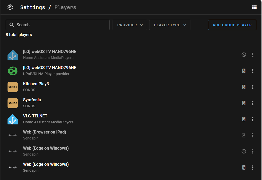

In Music Assistant>Settings>Providers filtered to show just the player providers shows I have 4 providers controlling 8 players configured thus:-
In settings>Players the 8 players are shown thus ( note I have disabled three services which seemed to be duplicates to see if that might have been the issue:
If I try and play media from HA directly, the music is played, but not when I try to play the same content on the same device from Music Assistant. Although MA shows the track being played on the chosen player, the player does not play!
Any insight would be gratefully received.

… I spoke too soon. MA will play through the USB speaker using VLC-Telnet. However, when I try playing anything on the Sonos system, the current music is stopped, but the music chosen in MA is not played.
