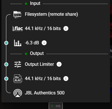

I have Airplay 2 support on a JBL Auth 500 but it looks like it does not support Airplay 1. Output limiter ALAC 16b/44.1K … would be nice if I could get sendspin working with the unit otherwise I think I will be sending it back. Shame really as it is a great sounding unit.

What are you talking about. ALAC 44.1k/16bits is just as lossless as your source FLAC 44.1k/16bits.
ALAC (Apple Lossless Audio Codec) is Apple’s answer for CD Quality Music, the AirPlay protocol only supports AAC, ALAC and LPCM.
In MA you can disable the Lossless ALAC Compression per speaker under Advanced Settings, but there is no audible difference as it is still lossless, so why waste bandwidth by sending LPCM?
Recently EAC3 was added to AirPlay 2 for Multi-Channel, but so far that only works through Apple TV/HomePods, and is not useful for Stereo Music.
Which means MA is doing AirPlay 2 differently than direct from Apple devices, giving you lossless over AirPlay 2.

Sorry about the confusion. I was actually referring to Sendspin and not the actual codec(s) used here. At the moment Sendspin is not available for Airplay 2 which is fine as I am able get all my devices to sync perfectly using Chromecast so that is what I will use while the bugs get sorted out on the Sendspin front.
