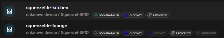

One other thing, doesnt seem to affect anything, but a couple of oddities with squeezelite players.
First is this:-
Not sure why the lounge player has airplay and sendspin twice, with one entry on each greyed out.

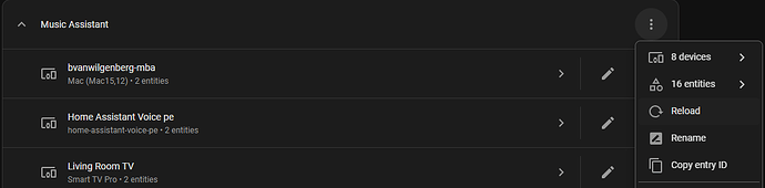

Also, if you restart the MA addon, the names of my squeezelite players in HA get changed to ‘unknown [mac address]’ (They are still fine in MA).
It also changed my HA entity names until I renamed them again.
It fixes itself if you then reload the integration:-

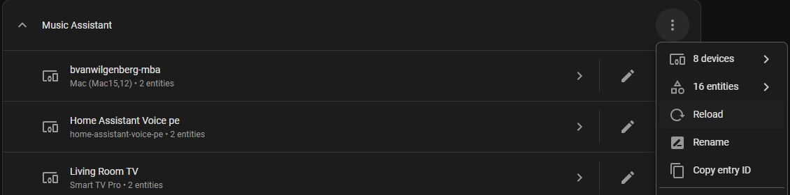

So.. firstly… restart MA the HA names look like this:-
Then I reload the MA:-
And they fix themselves:-

Try reloading the integration, it might fix itself.
However, it might not, because first time it happened, it had changed my entity names as well, and I had to rename them, which was pretty trivial to do because it only affected 2 media players.

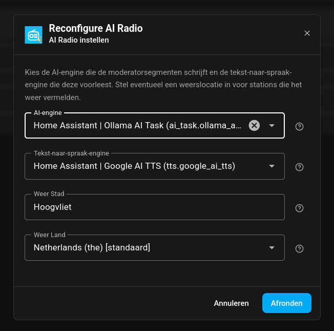

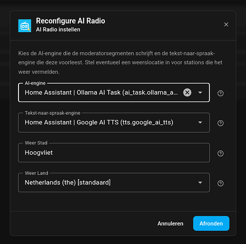

My configuration of the Music Nerd host is as follows:
The AI DJ plugin is configured this way:
I’ve used both local LLM’s (Ollama) and Google Gemini. Both give the same error: (Artist fact) failed to generate: AI engine ‘hass/ai_task.ollama_ai_task’ is not connected. Reconnect the provider (for example Home Assistant) and retry.
I have no idea how to follow this advice. It worked when using the beta version of MA. Have removed this version of MA when 2.10 stable came out.
Anyone has a solution to correct this error or knows how to debug this problem? If necessary I can provide more logging.
