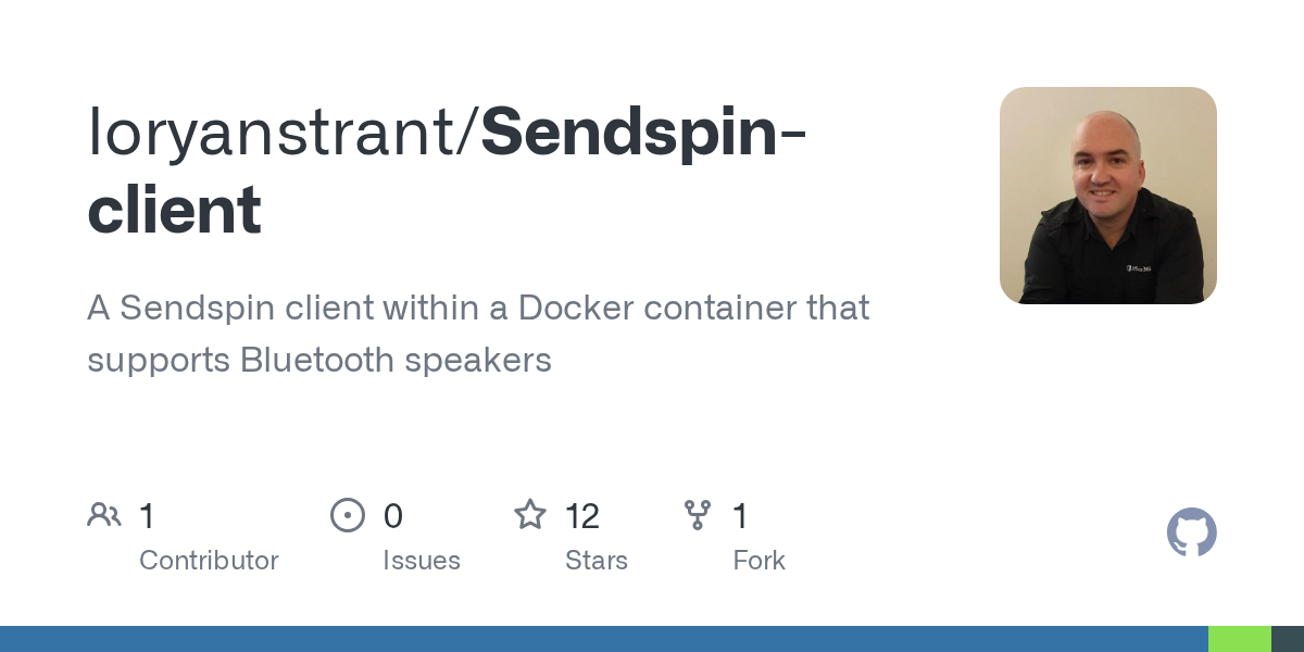

Does it support Bluetooth speakers now? I was under the impression it doesn’t, and you need DAC and a (passive) speaker.
no it does not support bluetooth which i also see as the last resort for music streaming in the home. If BT is your favorite way then there is much better BT recievers than what we got with squeezelite, i mean it works but it’s not great :man_shrugging:t3:
But this whole thread is about playing to a Bluetooth speaker…
It does with this setup:
Thanks for introducing this sendspin setup/client here. I handn’t looked into it much because, as @Fanful had mentioned, my use case for about half of my squeezelites is specifically with bluetooth, where wired connections just weren’t a great option. (e.g. waterproof bluetooth speaker in shower, bluetooth speaker in shed about 100 feet away from router & pi running home assistant). general setup is wifi to the esp, and then the last couple feet to the bluetooth speaker that i can take off the charger and place where i want it (i have a few different Anker soundcore speakers that I like)
If the docker container supporting bluetooth for sendspin is a viable client, i may look into it. But I do have 5 squeezelite clients that have been working nicely since I posted this, and I do tend to deprioritize messing with things that I already have working :wink:
