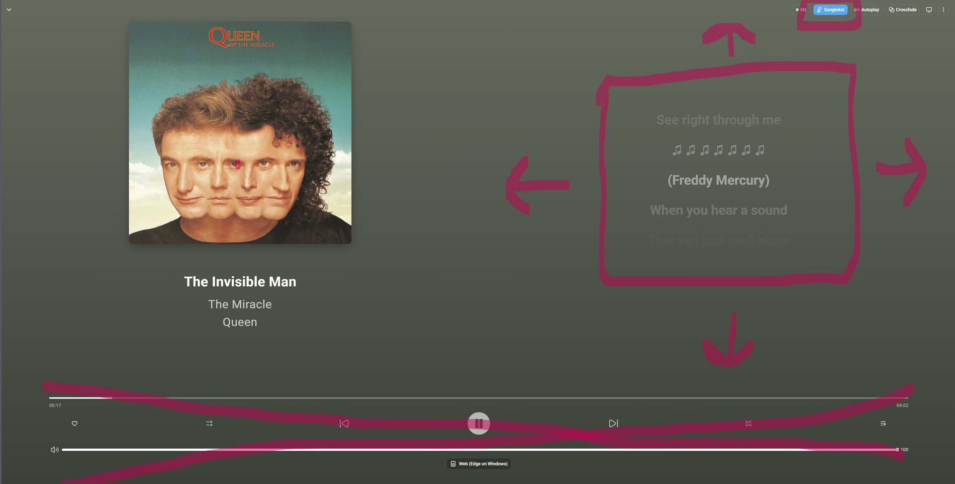

  2. Music Assistant Full Player: When I open the full player view inside Music Assistant, the lyrics button in the top-right corner works brilliantly! The sync and layout are great. However, I want to hide all the media controls (play/pause, timeline, volume sliders, track details, etc.) so that only the lyrics are visible on the TV screen.
Since Music Assistant already handles lyrics natively so well, I’d love to leverage its built-in engine rather than relying on external cards.
Does anyone have tips, CSS workarounds (like card-mod), or ideas on how to extract/display just the lyrics view on a dashboard?

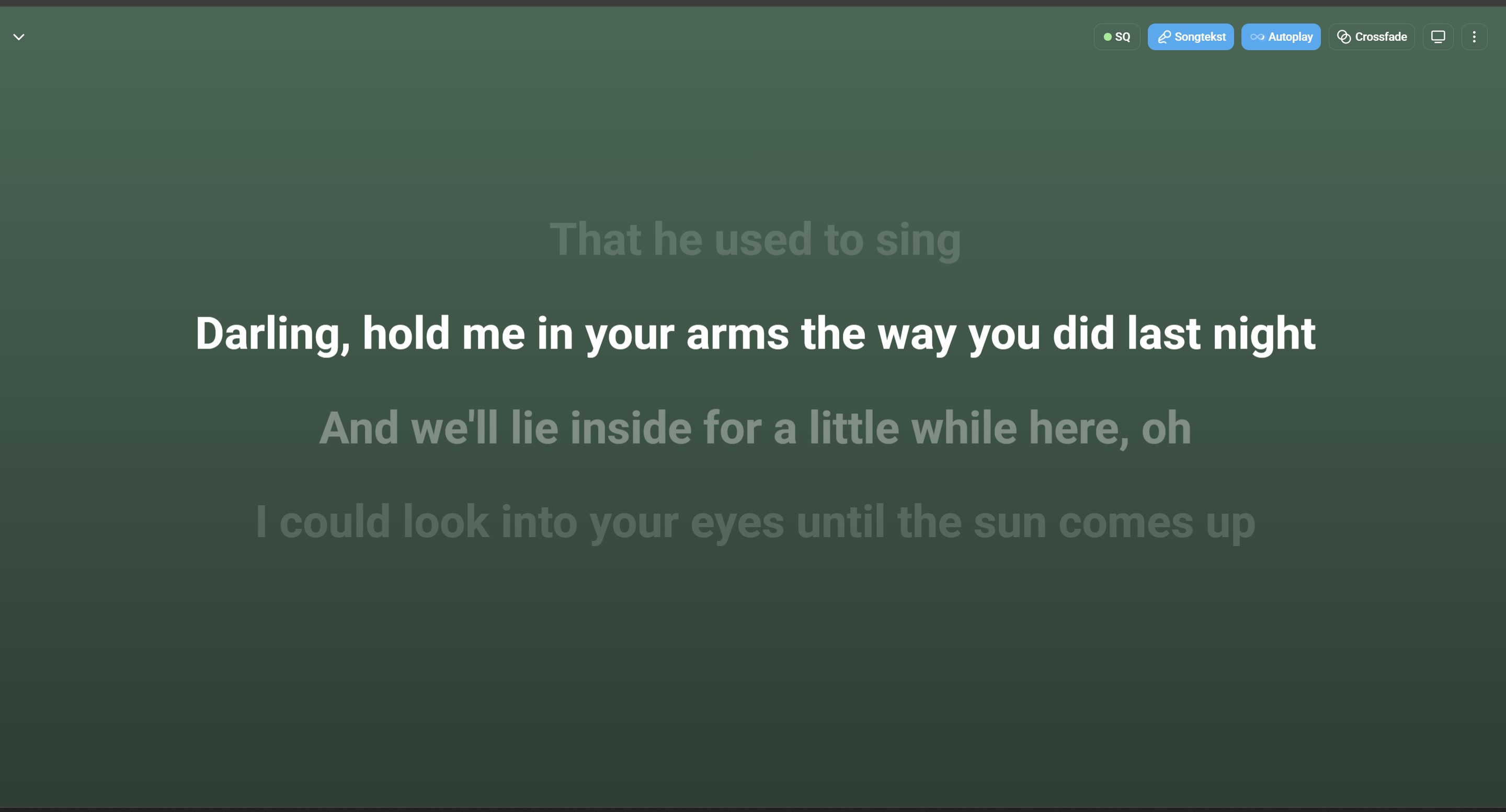

UIX now supports styling spps and ingress panels hosted as frames. This is available as an experiental option you need to turn on in 8.4.0-beta.1.
I have tested the theme variable below. This uses the fact that when the lyrics button is set, it gets class bg-primary. Then the main-media-details and player-bottom are only hidden when the lyrics button is set.
  uix-music_assistant: |
    .fullscreen-player-card:has(
      .fullscreen-header-controls button[aria-label="Lyrics"].bg-primary
    ) :is(.player-bottom, .main-media-details) {
      display: none;
Sep-28-2026 11-43-19
Note sure how you may be displaying on TV. I have not tested with casting - will do so when I get a chance. Looks like cast is just cover art and control so I assume you are using a device connected to your TV. Anyhow, let me know how you go and if you need more assistance.

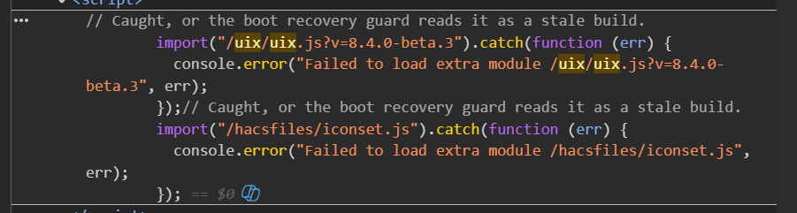

Are you on a desktop? Can you check that you see UIX get loaded for music-assistant panel? You will see something like the below in Browser developer console.
💡 UIX 8.4.0-beta.3 IS INSTALLED 💡 for d5369777_music_assistant
I see several references to UIX, but the closest thing I can find is
Not in the code, but in the console where info/warnings/errors are logged.
Specifically when you go to Music Assistant, UIX will be loaded into the frame and what I showed gets logged as info.
I found the message.
So that is oke
That is general load. You will get similar when you go to Music Assistant.

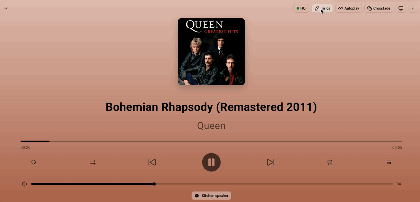

Loved the idea, had a go at it with Claude support and got it working. Not sure ofcourse if you are looking to run it in a similar setup but maybe it helps, thanks for the inspiration!
Great solution.
