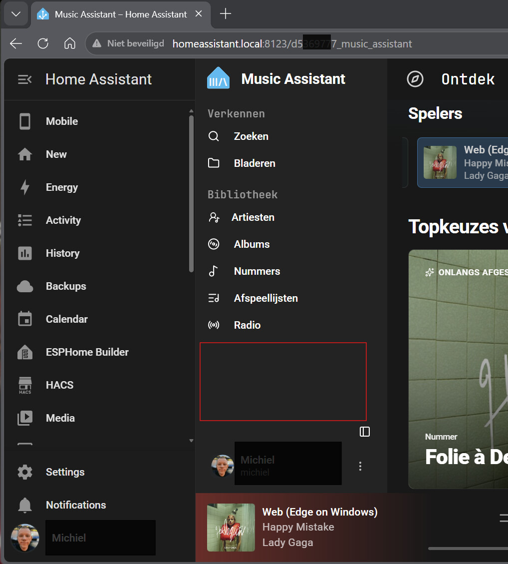

I have integrated Music Assistant into Home Assistant, but I miss the settings menu with the gear icon in the left sidebar.
I can go to my profile and then to settings via the breadcrumb trail.

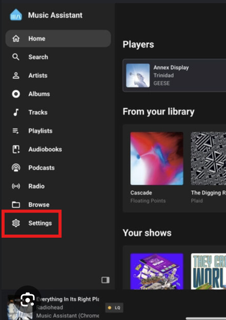

When I look at images on the internet this is how it should look like if i’m correct!?

That got changed and you’re looking at old pictures, click the 3 dots next to your MA profile image and you’ll get a popup with an ‘Edit menu’ option and you can add it back if you want.
thx, i’m in edit mode , but i don’t see any controls to add something to the (left)menu
Oops, realised that I’m on beta and things look different to me. I installed the release version and ya edit mode won’t help you there. If you can finagle your way back into settings though and select the User Interface card you can edit the menu from there (third item down in Preferences.
FWIW the Settings option was in my menu by default in a fresh install of the release version.
Thx Rick,
I installed the latest version of music assistant (2.10.0) and the problem is solved.
