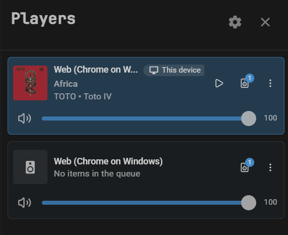

Music Assistant simply refuses to detect local Google Cast devices
I am at my wit’s end. I got a couple of Music Assistant Providers set up, but the only players it can see are my chrome browsers.

You have enabled the google cast player provider in MA?

Oh my goodness. So a “Player” can be a “Provider”? Thank you. This works. After trawling documentation for two days I finally got it working.
Not quite. The player have providers. If all the available providers were ebabled by default MA would take a lot more resources.
