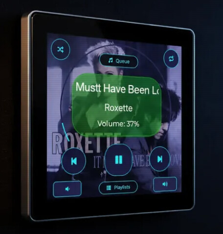

  • Now Playing screen
    Full-screen album artwork with a darkened background, track title, artist, volume and playback information.
  • Circular playback progress
    A large LVGL progress arc around the album artwork shows the current playback position.
  • Touch playback controls
    Previous track, Play/Pause, Next track, Volume Up/Down, Shuffle and Repeat directly from the display.
  • Music Assistant Playlists
    A dedicated Playlists page loads playlists from Music Assistant and allows starting them directly from the touchscreen.
  • Music Assistant Queue
    A separate Queue page shows the current playback queue and allows interaction without opening the HA or Music Assistant frontend.
  • Real-time Home Assistant state
    Track title, artist, artwork, duration, current position and volume are synchronized from the selected Home Assistant media_player entity.
  • Swipe Navigation
    The interface supports touch gestures for moving between the Player, Playlists and Queue pages.
  • Album Artwork
    The display dynamically loads the current entity_picture, so the controller follows whatever is playing.
