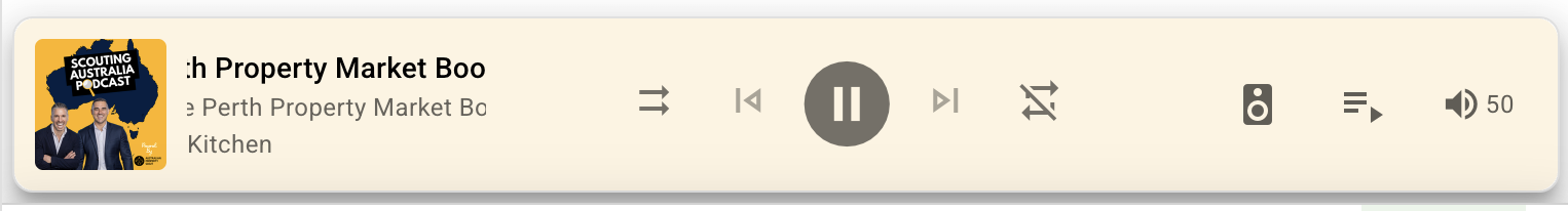

For some reason or other music assistant instead plays whatever this is…
It seems to disregard the file name, activate a search based upon it and plays what it thinks best. How can a play a specific file via the music assistant integration?

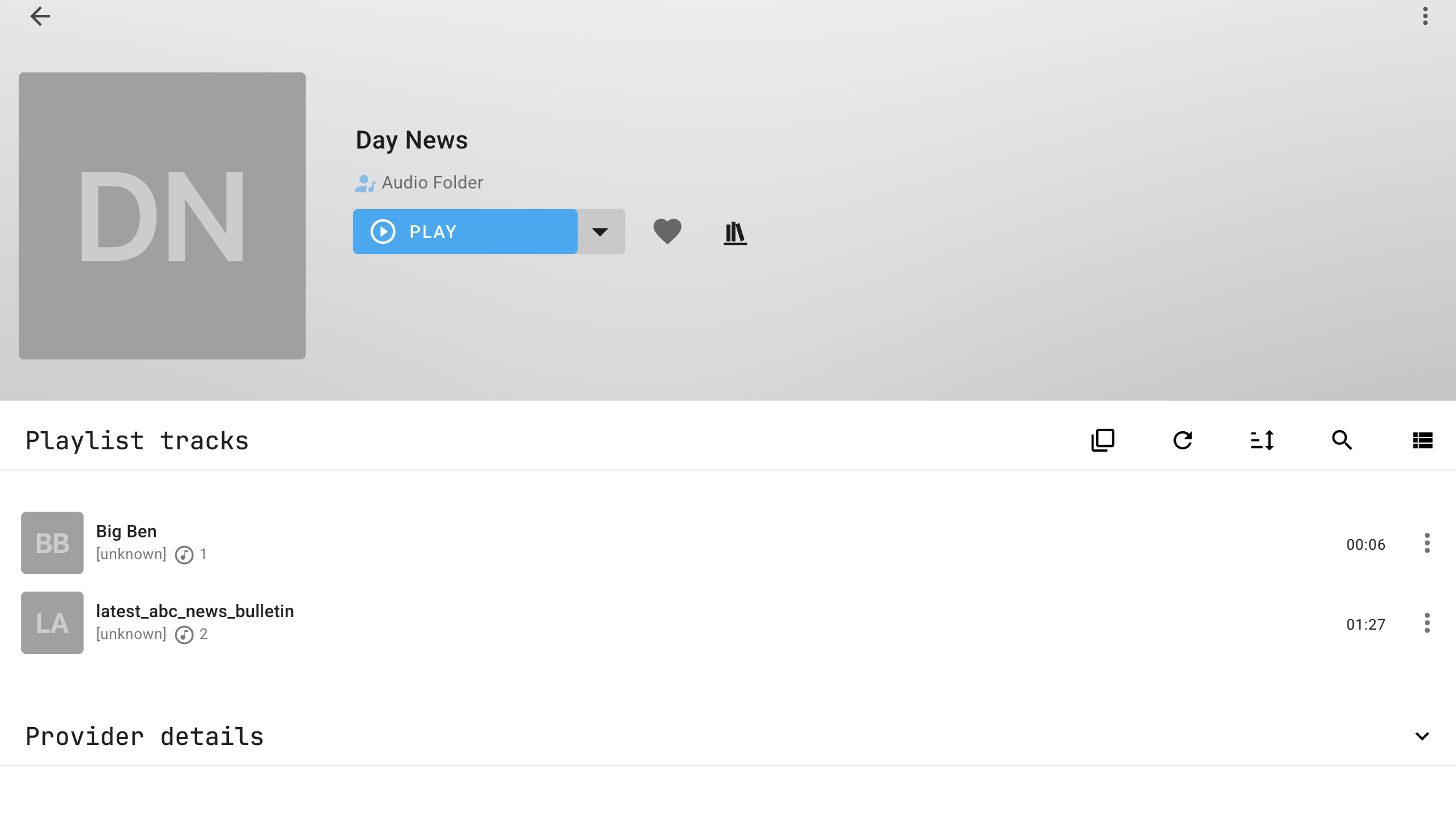

Thanks… I placed the file into a playlist which seems to be working (though the media player will not change from ‘playing’ once it has been played).

I’ve tried to play the media file a few times using the file name (which I understood WAS the media ID) but it simply would not play it. Instead choosing tp play something else, seemingly at random.
So I created a playlist with the file included and this was working… for a while. Now it plays over and over on repeat instead of just once.
Calling the file directly in the media player now plays the playlist instead of the file I wish to play.

  media_id: latest_abc_news_bulletin
Instead it plays this:
I was calling the playlist using this…
alias: Play the Day News playlist to kitchen MA player
action: music_assistant.play_media
  media_id: Day News
  media_type: playlist
  enqueue: replace
  entity_id: media_player.ma_kitchen
But now it plays this on repeat and I have no idea why.
