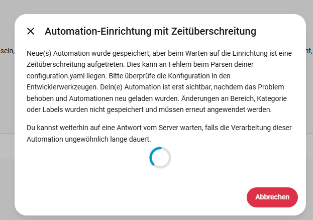

My automations haven’t been working since the update. I tried creating a new one, but it’s not being accepted. However, the automation.yaml file shows what I entered. What’s going on?
It’s also showing that “weekday:” isn’t correct.
Has anyone else experienced this problem?
Regards, Jürgen
Error message when saving the automation:
I think there was an automatic translation, Thanks for the notice

The error message mentions a timeout when trying to save the file.
This could be the storage media hardware failing.
Flash medias typically fail when writing, but still works with reading.

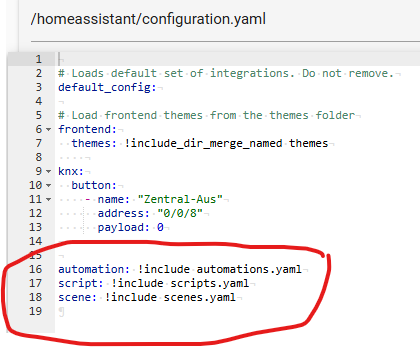

Problem solved, solution incorect Configuration.yaml i have added the marked code
