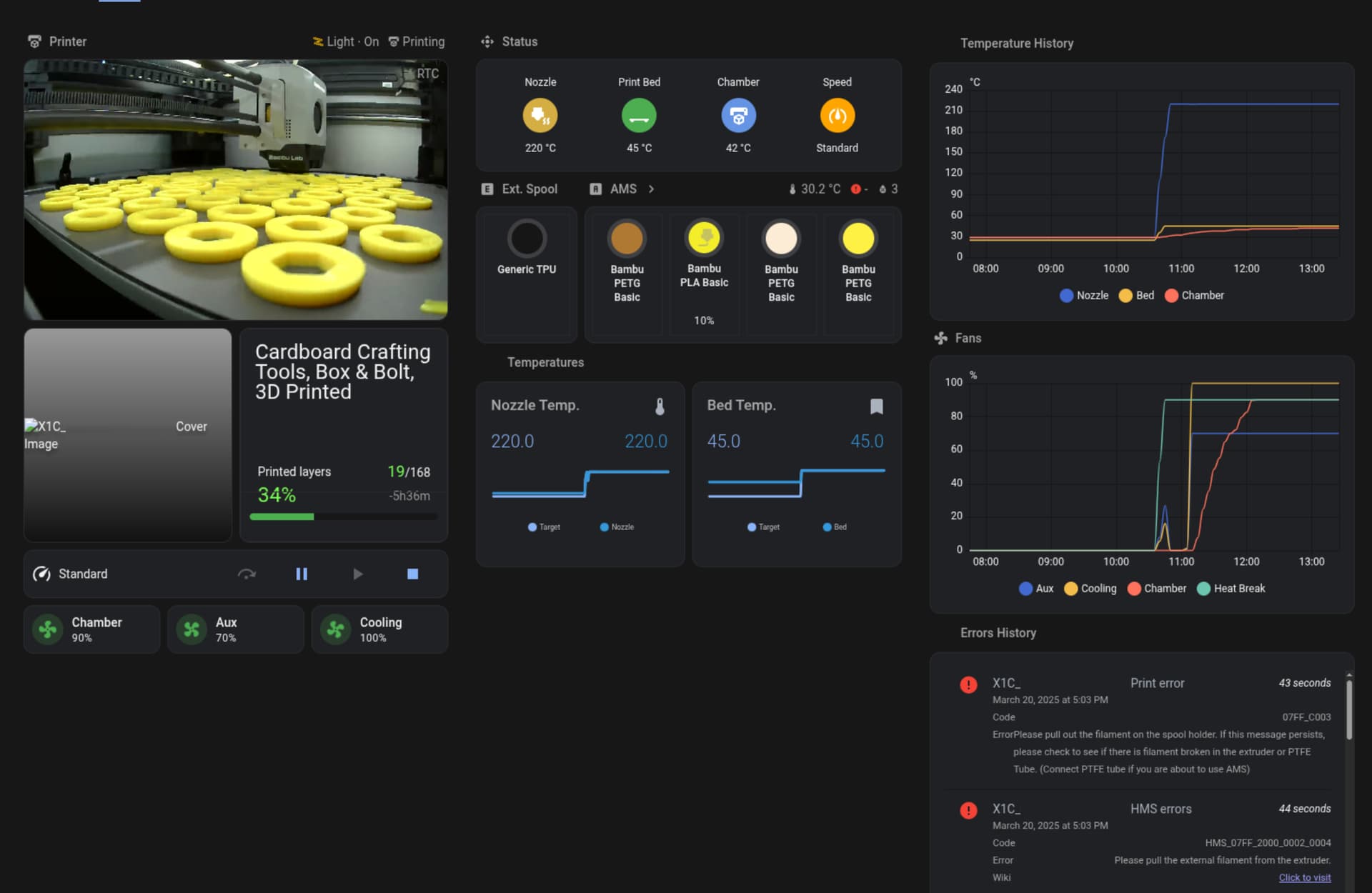

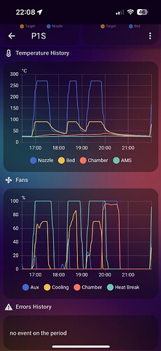

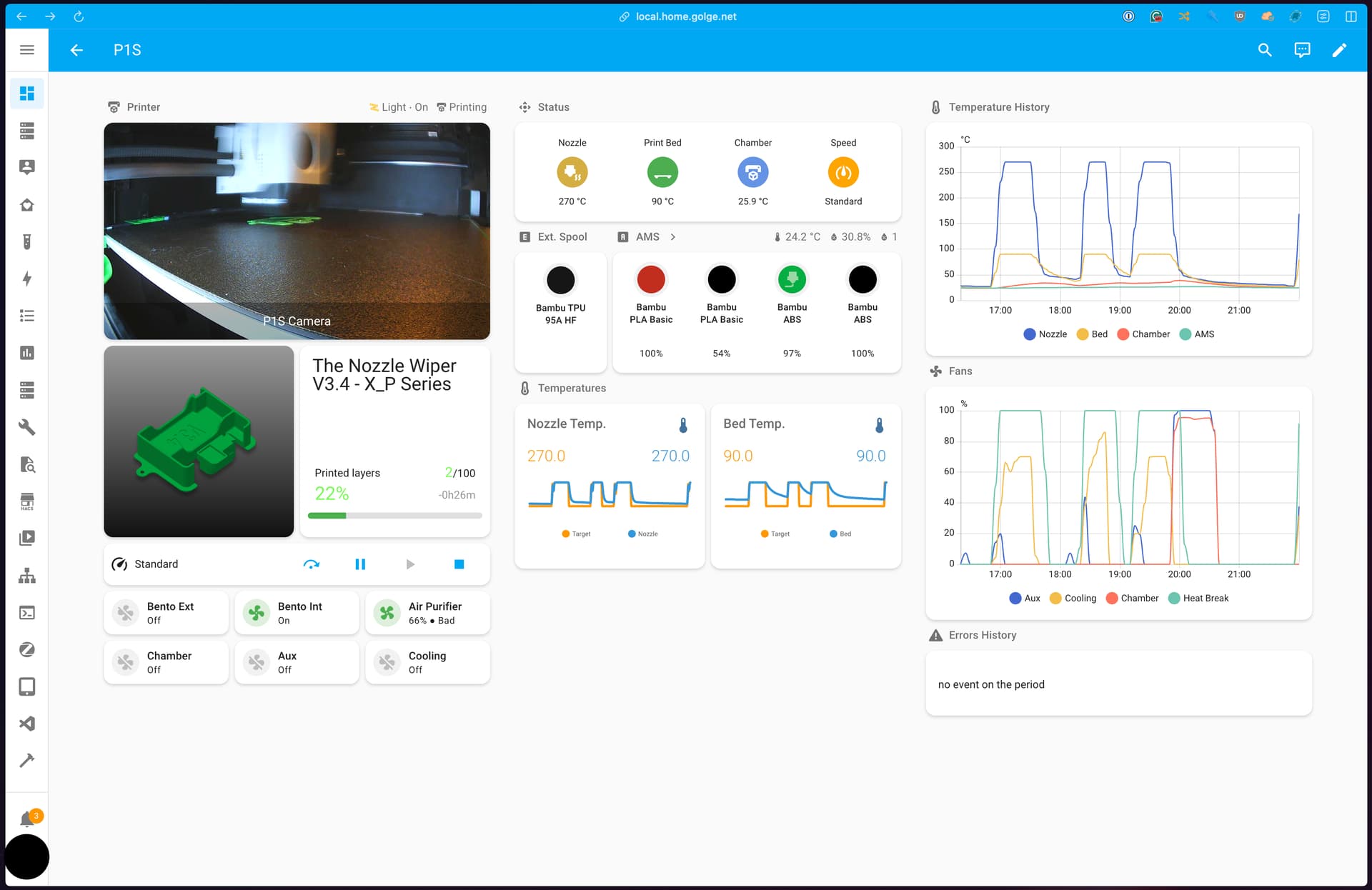

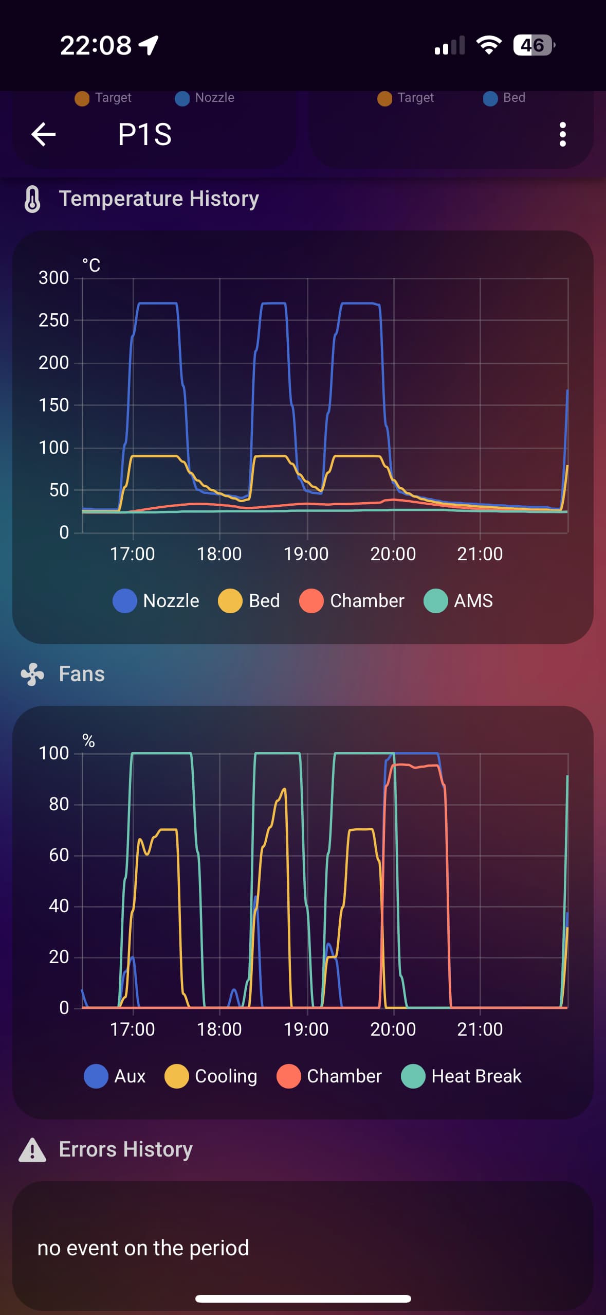

My Bambu Lab X1C Dashboard & Automations

Here you go :+1:
but you need to copy some code in configuration.yaml from BalooDK for the remain filament to be displayed :wink:
Code for the card :
type: vertical-stack
cards:
  - type: custom:mushroom-chips-card
    chips:
      - type: entity
        entity: switch.imprimante_3d_switch
        content_info: name
        icon_color: green
        icon: phu:bambulab-alt
    alignment: center
    card_mod:
      style: |
        ha-card {
          zoom: 1.3 !important;
  - type: custom:mod-card
    card:
      chips:
        - type: entity
          entity: button.p1s_reprendre_l_impression
          icon: mdi:play
          content_info: false
        - type: entity
          entity: button.p1s_mettre_en_pause_l_impression
          icon: mdi:pause
          content_info: false
        - type: entity
          entity: button.p1s_arreter_l_impression
          icon: mdi:stop
          content_info: false
      alignment: center
    card_mod:
      style: |
        ha-card {
          background: none !important;
          border: none;
          font-size: 4rem !important;
          zoom: 1.1 !important;
  - type: picture-elements
    elements:
      - type: state-label
        entity: sensor.p1s_progression_de_l_impression
        tap_action:
          action: more-info
          entity: camera.p1s_camera
        style:
          top: 90%
          left: 9%
      - type: state-label
        entity: sensor.p1s_grammage_de_limpression
        tap_action:
          action: more-info
        style:
          top: 90%
          left: 88%
      - type: state-icon
        entity: light.p1s_lumiere_de_la_chambre
        tap_action:
          action: toggle
        style:
          top: 10%
          left: 8%
      - type: state-icon
        entity: select.p1s_vitesse_d_impression
        style:
          top: 10%
          left: 89%
    camera_image: camera.p1s_camera
    camera_view: live
    tap_action:
      action: more-info
    card:
      type: custom:timer-bar-card
      entities:
        - entity: sensor.p1s_etat_de_l_impression
          guess_mode: true
          active_icon: mdi:printer-3d
          start_time:
            entity: sensor.p1s_heure_de_debut
          end_time:
            entity: sensor.p1s_heure_de_fin
      layout: full_row
      text_width: 5em
      bar_radius: 4px
    chips:
      - type: entity
        entity: sensor.p1s_etape_actuelle
        icon: mdi:cube
      - type: entity
        entity: binary_sensor.p1s_erreurs_hms
        icon: mdi:alert-circle
      - type: entity
        entity: sensor.p1s_utilisation_totale
        icon: mdi:clock
      - type: entity
        entity: sensor.p1s_temperature_de_la_buse
        icon_color: orange
        icon: mdi:printer-3d-nozzle-heat
    alignment: center
    card:
      type: horizontal-stack
      cards:
          chips:
            - type: template
              entity: binary_sensor.p1s_etat
              content: AMS
          alignment: start
          chips:
            - type: entity
              entity: sensor.ams_temp_sensor_temperature
              icon: mdi:thermometer
              icon_color: orange
          alignment: start
          chips:
            - type: entity
              entity: sensor.ams_temp_sensor_humidite
              icon_color: blue
          alignment: start
          chips:
            - type: entity
              entity: sensor.ams_indice_d_humidite
              icon: mdi:water-opacity
              icon_color: blue
          alignment: start
    card_mod:
      style: |
        ha-card {
          border: none;
    card:
      cards:
          card_mod:
            style: |
              ha-card {
                font-size: 12px;
                --tray_1_color: {{state_attr('sensor.ams_emplacement_1', 'color') [0:7]+'FF' }};
                --tray_2_color: {{state_attr('sensor.ams_emplacement_2', 'color') [0:7]+'FF' }};
                --tray_3_color: {{state_attr('sensor.ams_emplacement_3', 'color') [0:7]+'FF' }};
                --tray_4_color: {{state_attr('sensor.ams_emplacement_4', 'color') [0:7]+'FF' }};
                --tray_1_bg: {% if is_state_attr('sensor.ams_emplacement_1', 'active', true) %} rgba(255,254,249, 0.25); {% else %} rgba(111,111,111, 0.1) {% endif %};
                --tray_2_bg: {% if is_state_attr('sensor.ams_emplacement_2', 'active', true) %} rgba(255,254,249, 0.25); {% else %} rgba(111,111,111, 0.1) {% endif %};
                --tray_3_bg: {% if is_state_attr('sensor.ams_emplacement_3', 'active', true) %} rgba(255,254,249, 0.25); {% else %} rgba(111,111,111, 0.1) {% endif %};
                --tray_4_bg: {% if is_state_attr('sensor.ams_emplacement_4', 'active', true) %} rgba(255,254,249, 0.25); {% else %} rgba(111,111,111, 0.1) {% endif %};
          card:
            card_mod:
              style: |
                .entities {
                  align-items: start !important;
            show_name: true
            show_icon: true
            show_state: true
            type: glance
            entities:
              - entity: sensor.bams_a_1
                icon: mdi:circle-slice-8
                card_mod:
                  style: |
                    :host {
                      --paper-item-icon-color: var(--tray_1_color);
                    state-badge {
                      background-color: var(--tray_1_bg);
                      border-radius: 50%;
                    div {
                      white-space: unset !important;
                      text-wrap: balance !important;
              - entity: sensor.bams_a_2
                card_mod:
                  style: |
                    :host {
                      --paper-item-icon-color: var(--tray_2_color);
                    state-badge {
                      background-color: var(--tray_2_bg);
                      border-radius: 50%;
                    div {
              - entity: sensor.bams_a_3
                card_mod:
                  style: |
                    :host {
                      --paper-item-icon-color: var(--tray_3_color);
                    state-badge {
                      background-color: var(--tray_3_bg);
                      border-radius: 50%;
                    div {
              - entity: sensor.bams_a_4
                card_mod:
                  style: |
                    :host {
                      --paper-item-icon-color: var(--tray_4_color);
                      opacity: 0.8
                    state-badge {
                      background-color: var(--tray_4_bg);
                      border-radius: 50%;
                    div {

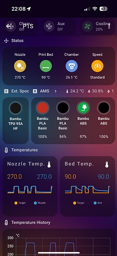

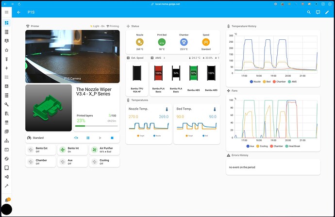

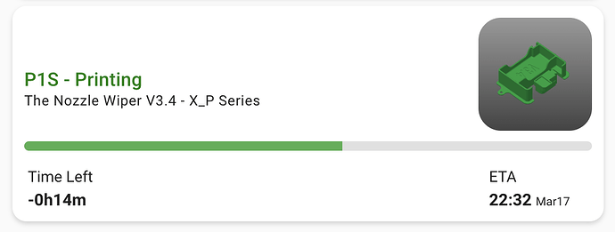

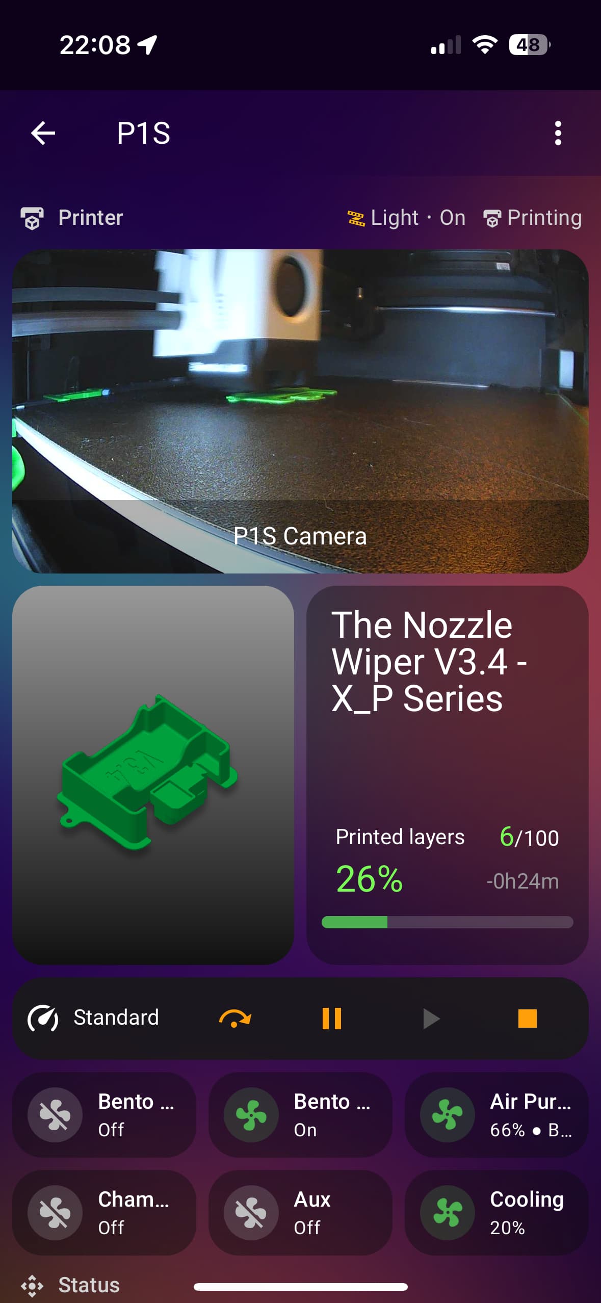

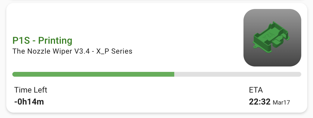

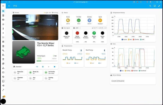

So,
I’m fiddling with BalooDK’s AMS code from my P1S with AMS.
Here is the Dashboard code:
views:
  - title: AMS
    sections:
      - type: grid
        cards:
          - type: vertical-stack
            cards:
                card_mod:
                  style:
                    hui-horizontal-stack-card $: |
                      div#root > :last-child > * {
                        width: 100%;
                        flex: auto;
                card:
                  cards:
                      chips:
                        - type: template
                          entity: binary_sensor.frog_p1s_online
                          content: AMS A
                          card_mod:
                            style: |
                              ha-card {
                                border: none;
                        - type: spacer
                        - type: entity
                          entity: sensor.frog_p1s_ams_humidity_index
                card:
                  cards:
                      card_mod:
                        style: |
                          ha-card {
                            font-size: 10px;
                            --external_spool_color: {{state_attr('sensor.x1c_ext_external_spool', 'color') }};
                            --tray_1_color: {{state_attr('sensor.frog_p1s_ams_tray_1', 'color') }};
                            --tray_2_color: {{state_attr('sensor.frog_p1s_ams_tray_2', 'color') }};
                            --tray_3_color: {{state_attr('sensor.frog_p1s_ams_tray_3', 'color') }};
                            --tray_4_color: {{state_attr('sensor.frog_p1s_ams_tray_4', 'color') }};
                            --external_spool_bg: {% if is_state_attr('sensor.x1c_ext_external_spool', 'active', true) %} rgba(200,100,50, 0.5); {% else %} rgba(111,111,111, 0.1) {% endif %};
                            --tray_1_bg: {% if is_state_attr('sensor.frog_p1s_ams_tray_1', 'active', true) %} rgba(200,100,50, 0.5); {% else %} rgba(111,111,111, 0.1) {% endif %};
                            --tray_2_bg: {% if is_state_attr('sensor.frog_p1s_ams_tray_2', 'active', true) %} rgba(200,100,50, 0.5); {% else %} rgba(111,111,111, 0.1) {% endif %};
                            --tray_3_bg: {% if is_state_attr('sensor.frog_p1s_ams_tray_3', 'active', true) %} rgba(200,100,50, 0.5); {% else %} rgba(111,111,111, 0.1) {% endif %};
                            --tray_4_bg: {% if is_state_attr('sensor.frog_p1s_ams_tray_4', 'active', true) %} rgba(200,100,50, 0.5); {% else %} rgba(111,111,111, 0.1) {% endif %};
                      card:
                        card_mod:
                          style: |
                            .entities {
                        show_name: false
                        show_icon: true
                        show_state: true
                        type: glance
                        entities:
                          - entity: sensor.frog_p1s_ams_tray_1
                            icon: phu:3d-filament
                            card_mod:
                              style: |
                                :host {
                                state-badge {
                                  border-radius: 50%;
                                div {
                          - entity: sensor.frog_p1s_ams_tray_2
                            card_mod:
                              style: |
                                :host {
                                state-badge {
                                  border-radius: 50%;
                                div {
                          - entity: sensor.frog_p1s_ams_tray_3
                            card_mod:
                              style: |
                                :host {
                                state-badge {
                                  border-radius: 50%;
                                div {
                          - entity: sensor.frog_p1s_ams_tray_4
                            card_mod:
                              style: |
                                :host {
                                state-badge {
                                  border-radius: 50%;
                                div {
              - type: horizontal-stack
                cards:
                  - type: custom:button-card
                        let tray = "Tray 1";
                        let filamentType = states['sensor.frog_p1s_ams_tray_1'].attributes.type || 'Unknown Type';
                        return tray + " | " + filamentType;
                    show_icon: false
                    show_name: false
                    custom_fields:
                      status: |
                          let percentage = parseFloat(states['sensor.frog_p1s_ams_tray_1'].attributes.remain) || 0;
                          let remainingMeters = (percentage / 100) * 335;
                          return percentage.toFixed(0) + '% | ' + remainingMeters.toFixed(0) + 'm';
                    styles:
                      card:
                        - height: 22px
                        - font-size: 12px
                      grid:
                        - grid-template-areas: '"i" "n" "filament_name" "status"'
                        - grid-template-rows: auto auto auto auto
                        - grid-template-columns: 1fr
                      status:
                        - justify-self: center
                        - font-size: 10px
                        - color: var(--primary-text-color)
                      icon:
                        - color: |
                              return states['sensor.frog_p1s_ams_tray_1'].attributes.color || '#FFFFFF';
                        let tray = "Tray 2";
                        let filamentType = states['sensor.frog_p1s_ams_tray_2'].attributes.type || 'Unknown Type';
                    show_icon: false
                    show_name: false
                    custom_fields:
                      status: |
                          let percentage = parseFloat(states['sensor.frog_p1s_ams_tray_2'].attributes.remain) || 0;
                    styles:
                      card:
                        - height: 22px
                        - font-size: 12px
                      grid:

It works, mostly but the colors displayed are wonky:
The colors, currently are
  1. Empty
  2. Green
  3. White
  4. Black
Any thoughts about what is going on?
Is there a list of ā€œattributesā€ somewhere?
Thanks!
It’s not showing the colors at all. The icons will show the color, but you don’t have any icons.
You need to install the ā€˜Custom brand Icon’ pack from HACS, or change the icons for your filament, It’s set to phu:3d-filament in my code.
You can see the attributes under states in the developer tools .
Amazing.
Great, thanks!
