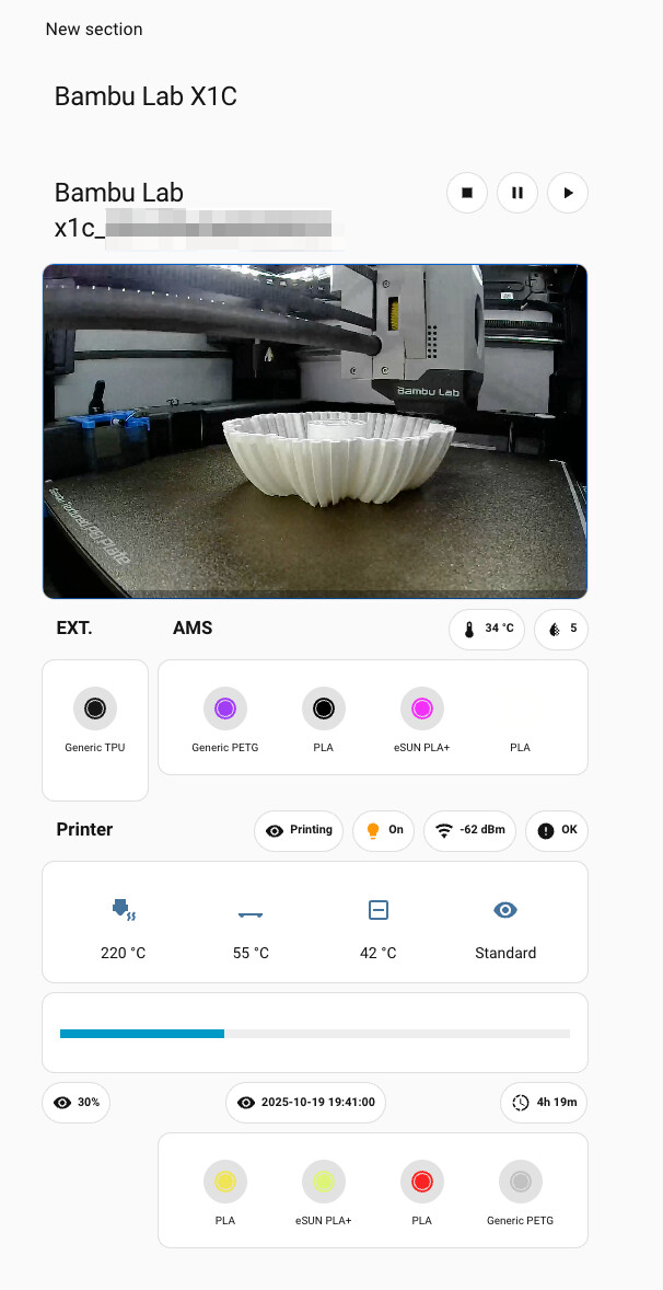

My Bambu Lab X1C Dashboard & Automations

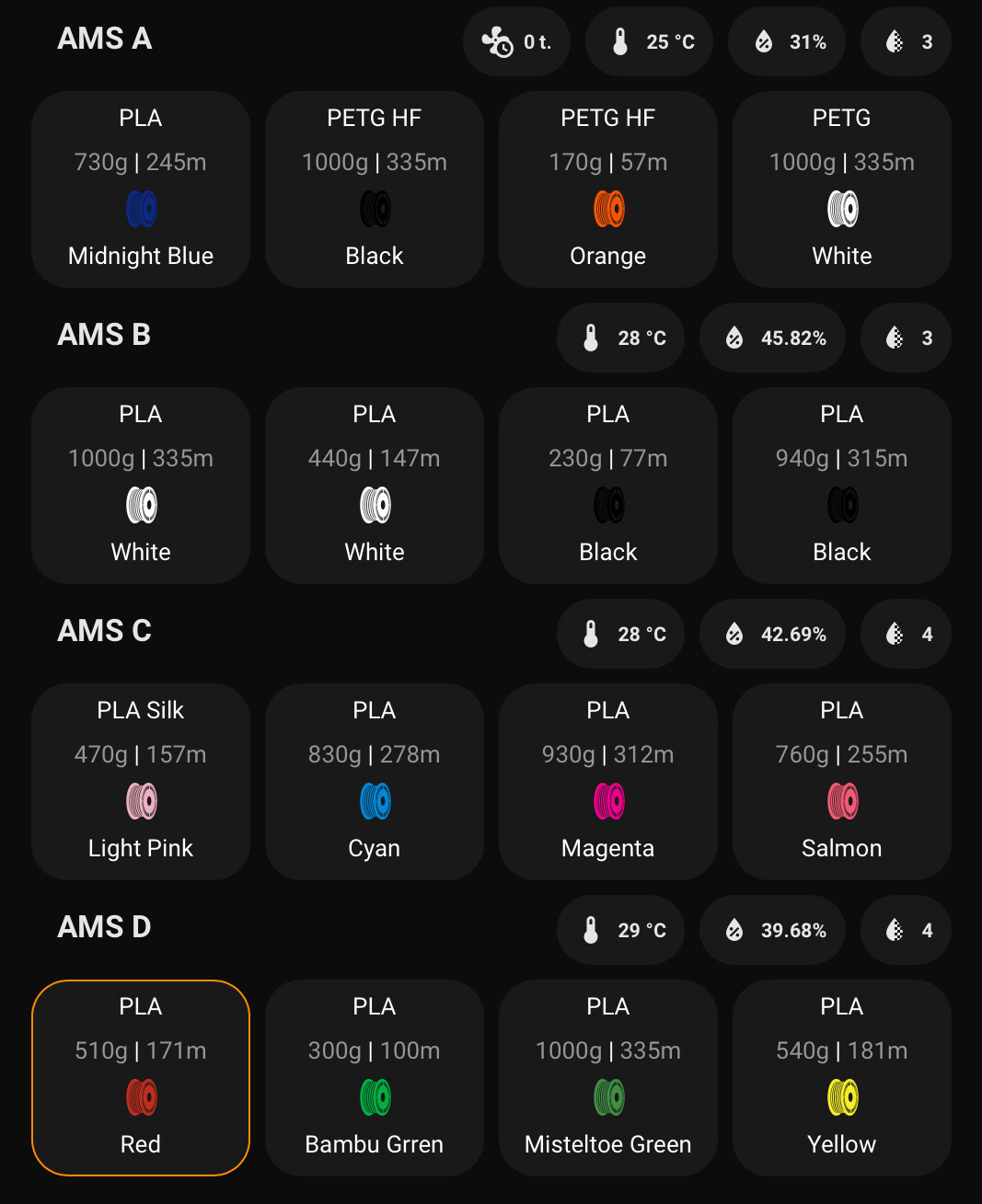

Made some changes for my AMS overview card.
Now it fetches the filament color name too.
And I got rid of the sensors in configuration.yaml

I got my 1st Bambu lab printer a few days a go and I’m trying to implement the same configuration as you ( Great job and thanks a ton for sharing).
I’ve replaced all your entites with mine but I’m facing an error when trying to save, It says: Unknown type encounter: sections
I’m running version 2025.9.3 so was expecting “sections” to be supported and recognized but that seems to be the case.
Also when trying @benji setup, I can get the colors to display, regardless of using the --paper-item-icon-color: or the –state-icon-color:
Any idea on how to get this sorted or if any one else has an idea that it would be highly appreciated
Thanks in advance
Would it be possible to get your code for the AMS? It looks perfect! :heart_eyes:
What do you use for keeping track of your remaining filament?
The printer keeps track of remaining filament.
You need to create a file in /homeassistant/custom_templates/ and name it: cols.jinja
Put this code in the file
{% macro hex2name(hex,name_only=True) -%}
{% set cols = {
    "Indian Red":            "#cd5c5c", "Light Coral":      "#f08080",

    "Bambu Green":            "#00AE42", "Misteltoe Green":   "#3F8E43",
    "Cyan":                 "#0086D6", "Magenta":           "#EC008C",
    "Orange":               "#F75403", "Gold":               "#E5B03D",
    "Red":              "#C12E1F"

This is the dashboard code for 1 AMS:

              'remain')/100)*335) <= 0 %}
                Empty spool
              {% else %}
                <font color=#959595>{{ (state_attr('sensor.x1c_00m09d470100819_ams_1_tray_1', 'remain')*10) }}g <font color=#FFFFFF> | </font><font color=#959595>{{ ((state_attr('sensor.x1c_00m09d470100819_ams_1_tray_1', 'remain')/100)*335) | round(0) }}m
              {% endif %}</td> </tr></table>
              <font
              color={{state_attr('sensor.x1c_00m09d470100819_ams_1_tray_1',
              'color') [0:7] }}> <ha-icon icon="phu:3d-filament"></ha-icon>
              <table width=100%><td align=center><font size="2" color=#FFFFFF>{%
              from 'cols.jinja' import hex2name %}{{
              hex2name(state_attr('sensor.x1c_00m09d470100819_ams_1_tray_1',
              'color') [1:7]) }}</font></td></tr></table>
      - type: vertical-stack
        cards:
          - type: markdown
            card_mod:
              style: |
                :host {
                  max-width:100px !important;
                  border:none;
                  margin: 0px 0px 0px 0px !important;
                  padding: 0px 0px 0px 0px !important;
                ha-markdown {
                  width: 100%;
                  line-height:1.5;
                  height: 100%;
                  justify-content: center !important;
                ha-card {
                  {%- set active = state_attr('sensor.x1c_00m09d470100819_ams_1_tray_2', 'active') %}
                  {%- if active == 1 %}
                    --ha-card-border-color: darkorange;
                  {%- else %}
                  {%- endif %}
                  border-radius: 20px;
            content: >-
              <table width=100%><td align=center><font size="2" color=#FFFFFF>{{
              state_attr('sensor.x1c_00m09d470100819_ams_1_tray_2', 'name') |
              replace('Bambu ', '') | replace('For PLA/PETG', '') | replace('
              Basic', '')}}</font>  <table width=100%><td align=center><font
              size="2"> {% if
              ((state_attr('sensor.x1c_00m09d470100819_ams_1_tray_2',
                Empty<br>spool
              {% else %}
                <font color=#959595>{{ (state_attr('sensor.x1c_00m09d470100819_ams_1_tray_2', 'remain')*10) }}g <font color=#FFFFFF> | </font><font color=#959595>{{ ((state_attr('sensor.x1c_00m09d470100819_ams_1_tray_2', 'remain')/100)*335) | round(0) }}m
              <font
              color={{state_attr('sensor.x1c_00m09d470100819_ams_1_tray_2',
              hex2name(state_attr('sensor.x1c_00m09d470100819_ams_1_tray_2',
        cards:
          - type: markdown
            card_mod:
              style: |
                :host {
                  border:none;
                ha-markdown {
                  width: 100%;
                  line-height:1.5;
                  height: 100%;
                ha-card {
                  {%- set active = state_attr('sensor.x1c_00m09d470100819_ams_1_tray_3', 'active') %}
                  {%- else %}
                  {%- endif %}
            content: >-
              state_attr('sensor.x1c_00m09d470100819_ams_1_tray_3', 'name') |
              size="2"> {% if
              ((state_attr('sensor.x1c_00m09d470100819_ams_1_tray_3',
                Empty spool
              {% else %}
                <font color=#959595>{{ (state_attr('sensor.x1c_00m09d470100819_ams_1_tray_3', 'remain')*10) }}g <font color=#FFFFFF> | </font><font color=#959595>{{ ((state_attr('sensor.x1c_00m09d470100819_ams_1_tray_3', 'remain')/100)*335) | round(0) }}m
              <font
              color={{state_attr('sensor.x1c_00m09d470100819_ams_1_tray_3',
              hex2name(state_attr('sensor.x1c_00m09d470100819_ams_1_tray_3',
        cards:
          - type: markdown
            card_mod:
              style: |
                :host {
                  border:none;
                ha-markdown {
                  width: 100%;
                  line-height:1.5;
                  height: 100%;
                ha-card {
                  {%- set active = state_attr('sensor.x1c_00m09d470100819_ams_1_tray_4', 'active') %}
                  {%- else %}
                  {%- endif %}
            content: >-
              state_attr('sensor.x1c_00m09d470100819_ams_1_tray_4', 'name') |
              size="2"> {% if
              ((state_attr('sensor.x1c_00m09d470100819_ams_1_tray_4',
                Empty<br>spool
              {% else %}
                <font color=#959595>{{ (state_attr('sensor.x1c_00m09d470100819_ams_1_tray_4', 'remain')*10) }}g <font color=#FFFFFF> | </font><font color=#959595>{{ ((state_attr('sensor.x1c_00m09d470100819_ams_1_tray_4', 'remain')/100)*335) | round(0) }}m
              <font
              color={{state_attr('sensor.x1c_00m09d470100819_ams_1_tray_4',
              hex2name(state_attr('sensor.x1c_00m09d470100819_ams_1_tray_4',
Super, I’m having some initial problems, but I’ll solve it sooner or later. :upside_down_face:
Mange tak!
It works!!! I tried so over dozen changes, and nothing worked until this :point_up_2:t2: one. Thank you so much!
OMG 4 AMS units. One of these days I’ll use this thing to print something besides benchys…
One of these days I need to print a benchy :stuck_out_tongue_winking_eye:
Been 3D printing for 8 years, and never printed one
Does anyone gave a sensor or automation to get the elapsed time on a notification? I tried using the start time + now when sending the notification but no luck.
Nice card and code.
  • Have to replace the naming of all the printer model and ams for those hitting issue not showing up. e.g sensor.x1c_xxxxx with your printer entity name in home assistant.
  • For the feed, need to turn on under Bambu Printer Settings>Lan Only> Lan Only Live View.
  • Have added my 2nd AMS as I have two but not able to align together as too much code to read.
  • Only filament colours are facing issue for me and the replace “paper-icon” to “state-icon” works.
