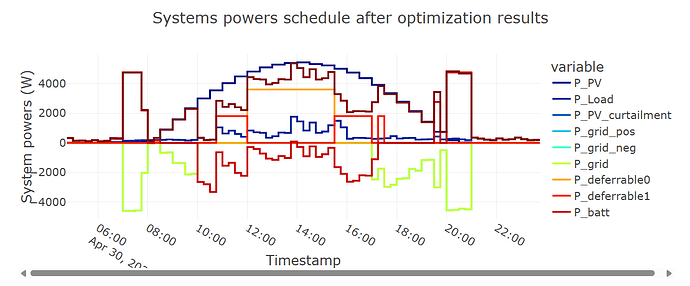

Calling emhass day ahead optim and MPC optim with parameters based on entso-e with some calculations on them to get my input and output tarifs and different values for the deferrable loads depending on what my calendar says (nightwork, holiday or [different]). I put up a dashboard with some sliders to easily edit those inputs without having to edit the code.
After about 2 weeks of faffing about with it, mostly vibe coding and standing up against the gasslighting of the LLM I used, yesterday I finally got everything in working order I think. Putting the optimization table with the prices and automation yamls into the LLM gives promissing result. Tommorrow the last automation (the one talking to the battery) will go live as my dynamic tariff wil start form the first of may. Wish me luck guys.
