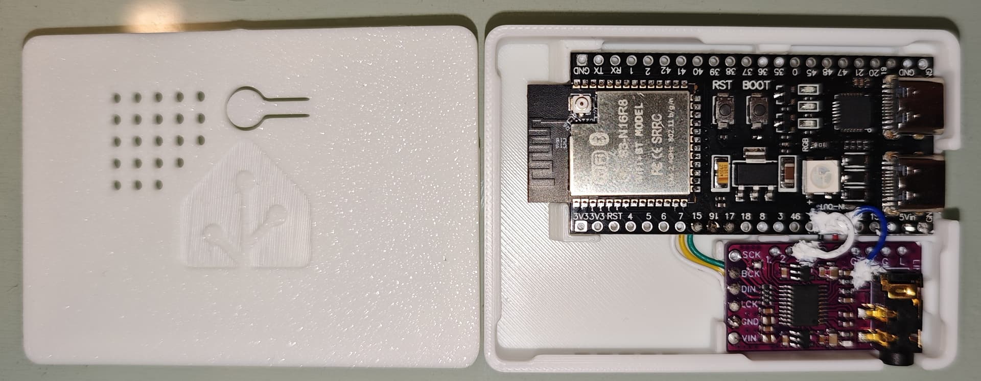

Hello, I was trying with a simple media player kit for a few evenings, can’t get it work as expected. I hope someone can help me.
My hardware setup:
ESP32-S3-DevkitC-1 N16R8 (not espressif original one)
PCM5102A DAC (small purple board)
LRCLK - GPIO15
DIN - GPIO16
BCLK - GPIO17
XSMT - GPIO10
I have tried different options so far:
  • legacy I2S Audio Media Player with Arduino framework
  • I2S Audio Speaker + Speaker Media Player with pipelines (full setup and simplest setup with only annoucement pipeline output to i2s audio speaker)
  • I2S Audio Speaker + Speaker Source Media Player + Sendspin source
    In each of the setup also tried in different sample rate (44100 or 48000), mode (stereo or mono), format (MP3 or FLAC), buffer duration (100ms to 1000ms).
What I can make success so far is with MP3 format playing from home assistant. It is quite ok without stuttering. My goal is to achieve playing media from Music Assistant, which is so far never succeed.
Here is my latest code I used:

Add some hardware information:
SCK is connected to GND by soldering the jumper on PCM5102A board, also H1L, H2L, H4L are soldered to Low. Except H3L, I connected the XSMT pad to GPIO10 to be able to control mute via ESP32.
I additionally connected a pin of the 3.5mm jack to GPIO11, this is used to detect the jack plug.
At this moment I removed all non-core function code in order to test the media player.
For VCC I used 5V to supply to PCM5102A, not sure if this could be a cause, if it can’t be solved by modifying the codes, my last try will be change the hardware setting.

As for wiring, the grounds of both boards are connected I guess its difficult to see from your pic.
Try using the pins I use, I remember having issues using other pins in the early days.
LRC GPIO11
BLC GPIO9
Dout GPIO7
Yes, I always download the bin and use USB to erase and install.
For me it was always ring buffer problem. I am thinking of my network throughout issue, because using of FLAC is worse than MP3. FLAC has bigger size.
Maybe I solder another esp32 and pcm board to see if it is the board’s problem.

I did a resoldering, changed VCC to 3.3V, data bins to GPIO 4/5/6.
Commented out the buffer size, the default buffer duration is 500ms. It doesn’t help. I tried from 100ms to 1000ms, no difference.

I am out of idea. Maybe it is the hardware issue, cheap board…
But did you read the last comment that said they had a c5 working with the same dac as you are trying to use.
I am guessing your board has issues.
I almost come to that coclusion too. I think it is the esp32-board issue, not the pcm5102a. Only esp has ring buffer.
