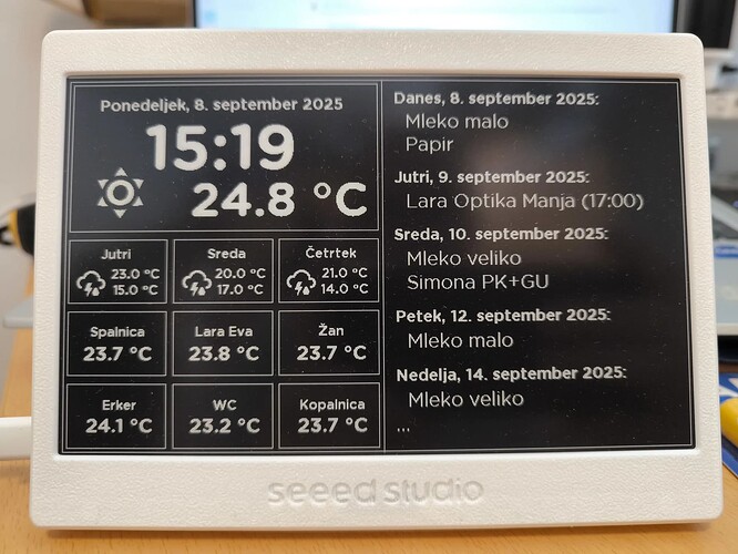

My ESPHome eink screen

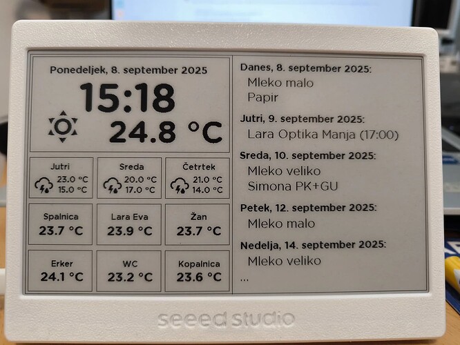

Dark Theme:
Light Theme:

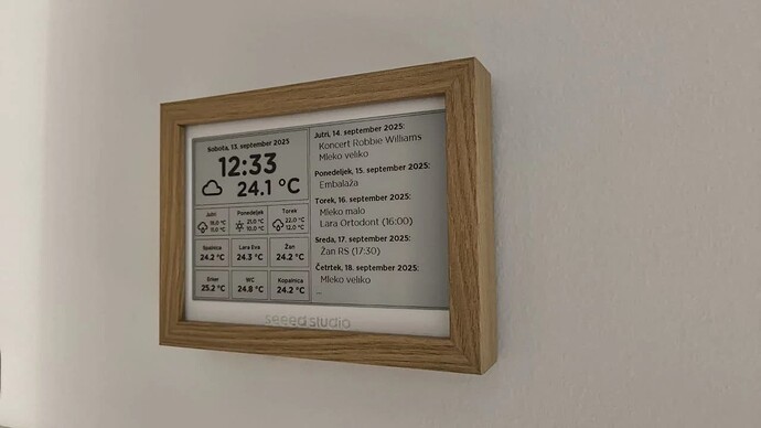

Wall Mounted:
After about 70 reflashes to fine-tune the look, the screen now updates only through Home Assistant automation — during the day, when someone is home — with updates every second after a full minute.
The calendar display combines three calendars, merged via automation and sent as an MQTT message that ESPHome picks up.
Power comes from a 5V supply. Two existing wall holes with UTP cables run directly to the main power cabinet, where a DIN-mounted 220V-to-5V adapter provides the source. Two UTP wires carry the power, connected to the 5V and GND pins on the ESP chip. Small holes were drilled into the screen enclosure and picture frame backplate, so in the end only two wires needed to be hooked up.
Wife love the black theme, but for me light one is better. I can easily switch the theme in Home Assistant entity property.
Posted all the files in Github: GitHub - thehijacker/ESPHome-E-Ink-Weather-Calendar-Wall-Monitor: This project provides a complete solution for a wall-mounted e-ink display powered by ESPHome and tightly integrated with Home Assistant. It displays weather, calendar events, room temperatures, and Slovenian date/time, with smart refresh logic and support for dark/light modes.
