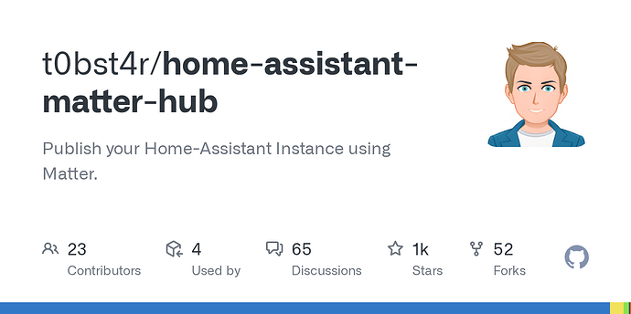

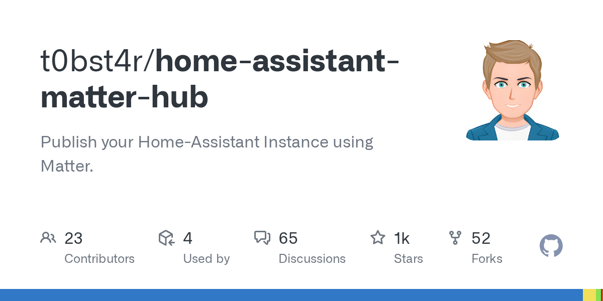

I have been successfully using this addon for about three months now: home-assistant-matter-hub. It works with any entity type listed here.
It is sometimes buggy (e.g devices get added twice with only one working) but that only happened to me once…
There is no additional cost, no cloud service (except that Alexa itself already is a cloud service) and no additional hardware required.
The only requirement is that your HA has to be im the same network as one of your Alexa devices.

I do not know Alexa and I not really sure what you want, but Ha have the option to share its devices as Matter devices to a Matter fabric, even devices that are not Matter.
Maybe Alexa can do that too.
Exactly, it’s matter, but the other way around than you’d think.
Set up matter hub linked above, and expose your entities to it. Easiest is to create “Alexa” label, assign it to entities you want to expose, and tell Matter Hub to look for “Alexa” label. Then, connect your echo/alexa to this created matter network via generated QR code. And now you have all your exposed entities in Alexa. With added benefit that it goes directly to Alexa, without the additional cloud hop when using HA Cloud or any other Alexa skill…
In other words its local without need to open any ports in the router.

The Matter Hub add-on is a really good option, too, but will use more resources on your hardware.

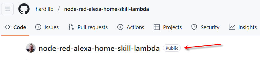

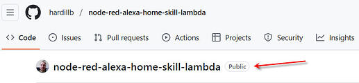

Hi
Ben Hardill is working hard on it :
https://github.com/hardillb/node-red-alexa-home-skill-web/issues/192
I think a solution will be found…
Seems like per the posts it may have been fixed.
Which is currently considered the better route to go with (stable, feature complete, etc)?
https://red.cb-net.co.uk or https://alexa-node-red.bm.hardill.me.uk
