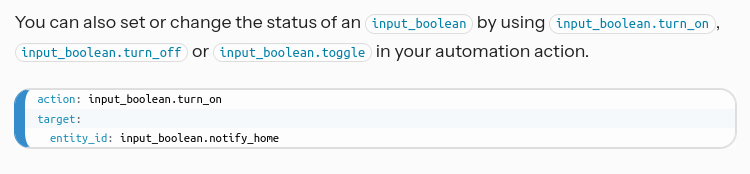

You’re missing the target key in the first action as well as the third and fifth actions.
https://www.home-assistant.io/integrations/input_boolean/#automation-examples
As the error states, entity_id is not valid at that level, it needs to be under target.
