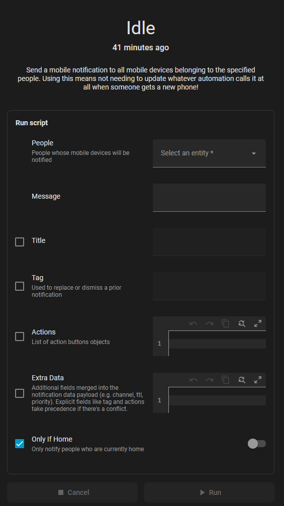

My Flexible Mobile Notification Script
I’m sure there are many similar scripts, but this is what worked for me! The main point was just avoiding needing to go through every automation that sent a mobile notification and updating it when someone gets a new phone.
This script makes it super convenient to send notifications, without needing to remember the exact actions to call, or a lot of copy-pasted logic to check if people are home before notifying them. It does require that every Person you want to notify has their mobile device set as belonging to them, but that should already be the case!
Just select the Person entities you want to notify, type in your message, and you’re good to go!

  only_if_home:
    name: Only If Home
    description: Only notify people who are currently home
    required: false
    default: false
    selector:
      boolean: null
