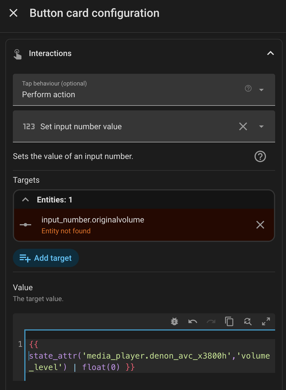

I agree with that. In my suggestion above, I made everything using the GUI (just had to go yaml to paste in the entities I do not have).
luxia:
Are you sure?
Yes.
You can put whatever you want in the “Value” field and the card may look fine, but the action will fail because templates are not supported:
