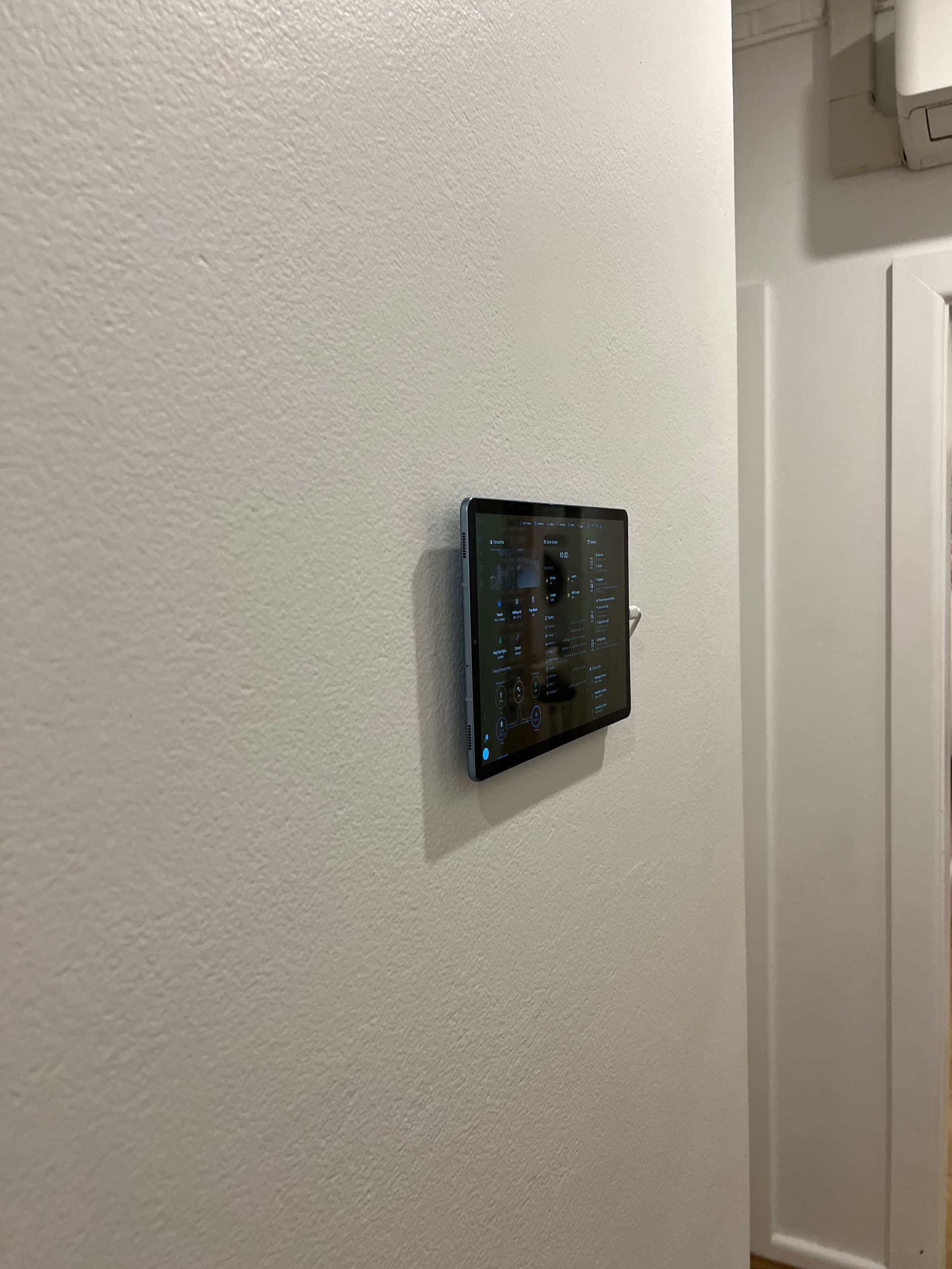

I’ve been running this mounting method for about 3 years now and it’s been absolutely rock solid. It’s fully universal for any tablet as long as it has a flat rear back. I thought it’s probably about time I upload and share the 3D model so others can enjoy it! At the time I couldn’t find any design I liked aesthetically, and I think this is still true today based on a quick search I did.
https://makerworld.com/en/models/1693448-super-minimal-frameless-tablet-ipad-wall-mount#profileId-1795300
I originally had an iPad mounted for the last 3 years, but have recently swapped it out for an Android based tablet with an OLED display that I picked up for a bargain price of $100AUD (slight screen burn in).

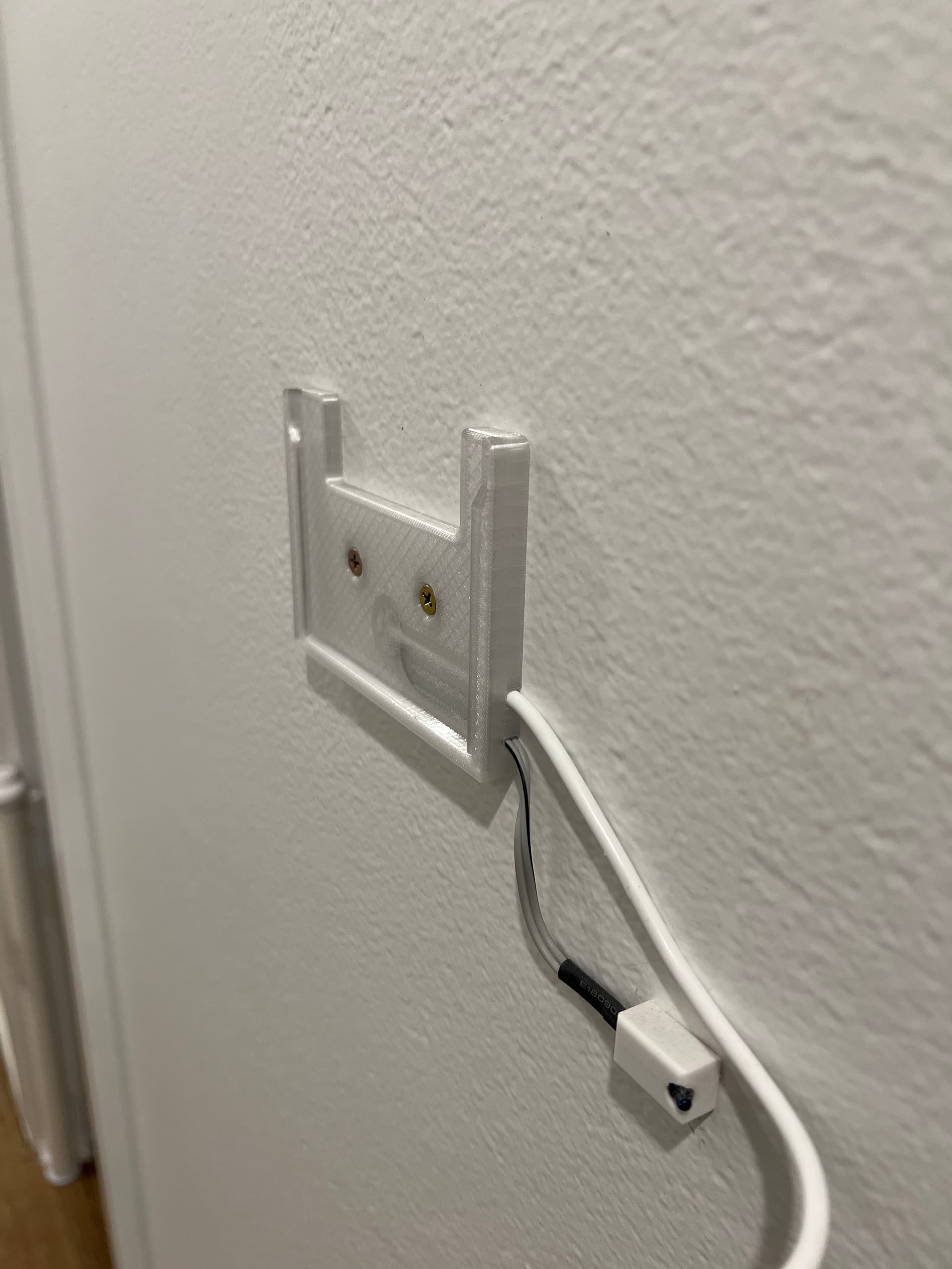

I recently modified the design to support routing a second cable through for a concealed IR blaster to control air conditioning in the hallway.

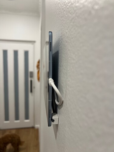

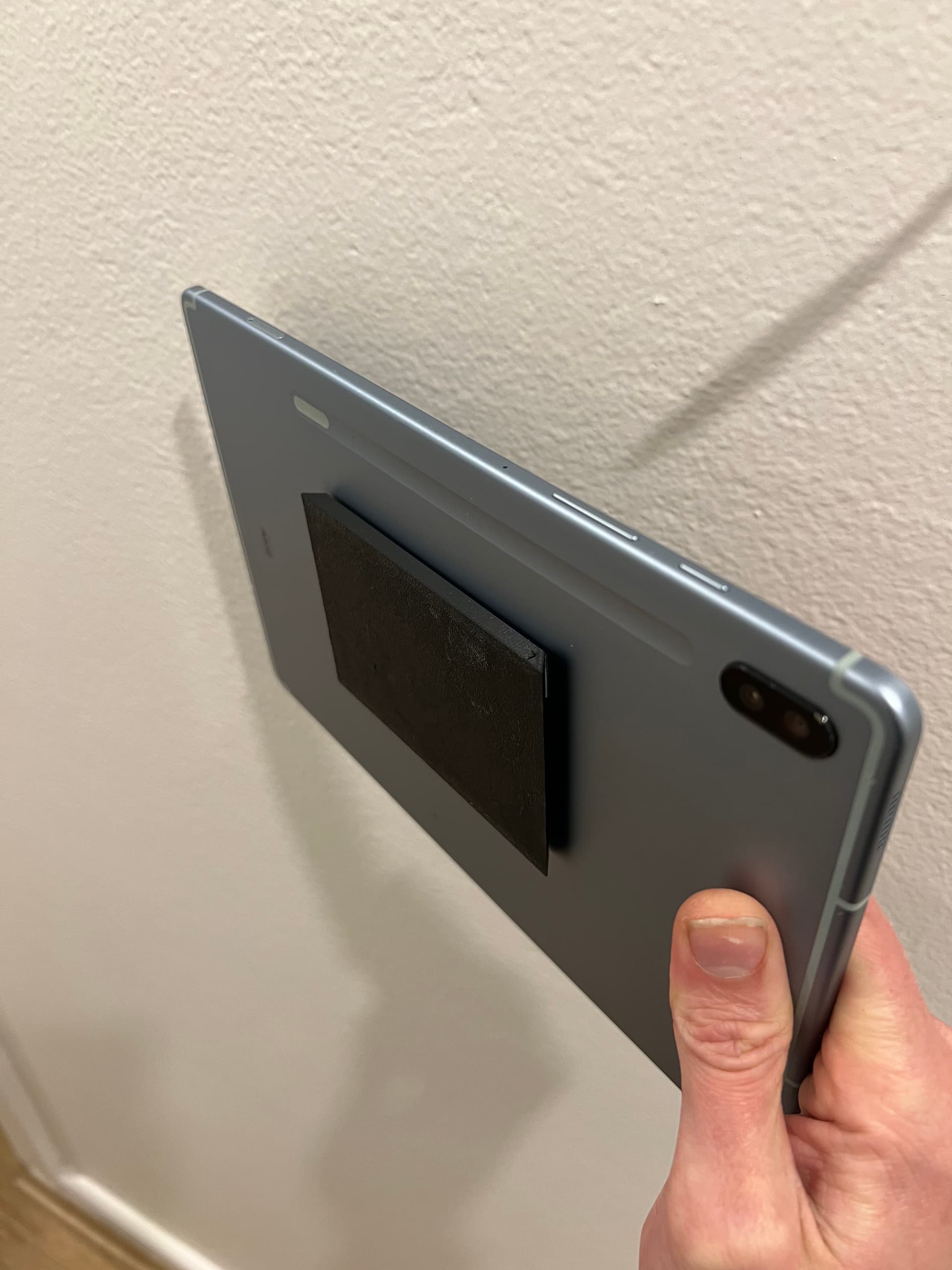

The mounting design uses a sliding vertical cleat design to allow the tablet to be easily removed from the wall when needed. Simply slide the tablet upward and out to use it elsewhere. The cleat attaches to the rear of any tablet with a secure mounting tape. But don’t cheap out on the tape, it’s the only thing holding the tablet to the mount!!

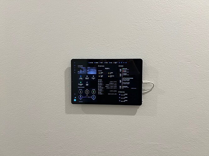

The dashboard itself follows an “information oriented” design, and tries to give the user high density information at a glance, but enables digging in if necessary. It features train times to the city from our local train station, household calendar, energy statistics, quick access for some select entities, as well as listing of lock/fan/light entities considered “on”/“unlocked” for quick control if necessary and glancing at the current home state. I’ll be sure to make a separate post another day about my dashboard design…

Is that a strong magnet glued to the back of the tablet?
All you need is a right angle power cable to tidy up that flying power charger lead that is poking out, implement wireless charging with smart shutoff when the battery is charged, or print a frame cover shroud to hide it, and give a belt and braces approach to prevent it falling down.
