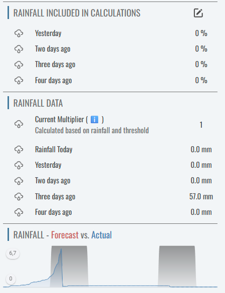

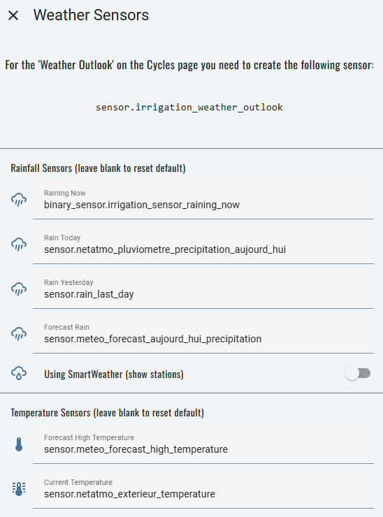

Hello Klogg, thank you for your excellent work.
If you have a few minutes, I need help with precipitation data.
I’m using a Netatmo station to find out if it’s raining now and if it’s raining today.
My concern is more with the “rain forecast,” for which I use the Météo France integration. I extract the information from Météo France and place it in the “meteo_forecast_aujourd_hui_precipitation” sensor:
- trigger:
      - platform: state
        entity_id: weather.carrieres_sur_seine
    action:
      - service: weather.get_forecasts
          type: daily
        response_variable: daily
    sensor:
      - name: Meteo Forecast Jours
        unique_id: meteo_forecast_jours
        state: "{{ daily['weather.carrieres_sur_seine'].forecast[0].condition }}"
        attributes:
          forecast: "{{ daily['weather.carrieres_sur_seine'].forecast }}"
        availability:  "{{ states('weather.carrieres_sur_seine') not in ['unknown', 'unavailable', 'none'] }}"
  - sensor:
      - name: Météo Forecast Aujourd'hui Précipitation
        unique_id: meteo_forecast_aujourd_hui_precipitation
        state: "{{ state_attr('sensor.meteo_forecast_jours','forecast')[0].precipitation | float(0) | default(0) }}"
        icon: mdi:weather-rainy
        unit_of_measurement: '%'
Is this the correct sensor to provide for “Predict Rain” ?
The problem is that in the Rain area the information is always displayed as 0.0.
If you can provide me with any suggestions to solve my problem, it will be helpful.
Thanks.

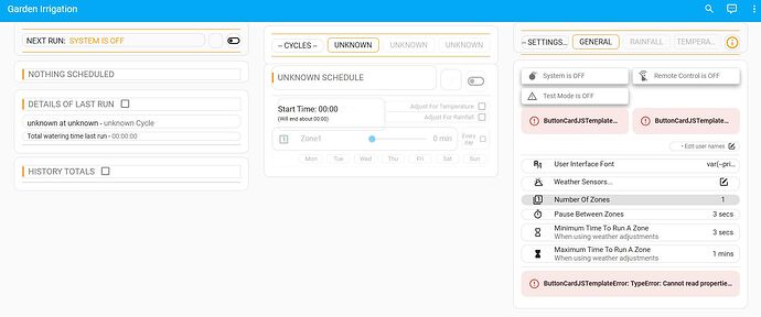

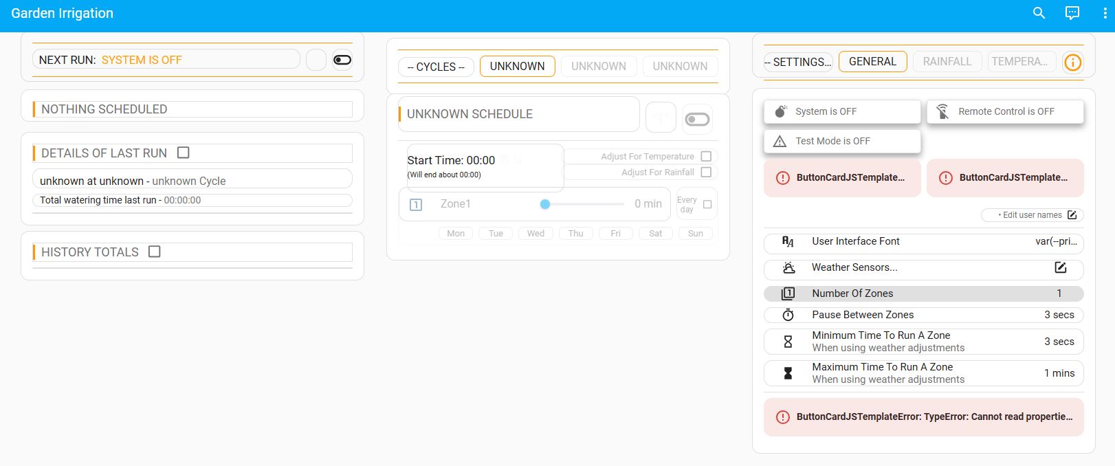

Hi there. Did you fixed those red cards? Ihave the same after install the new version
Hi all!
I installed the new version, and I am having these error that I cant fix
I dont know what is missing.
thanks
Hi @Stesa6980 I have the same error of indentation. did you fixed it?
