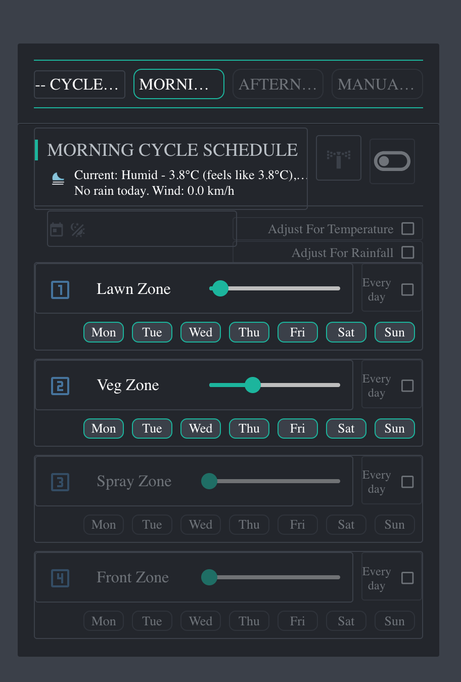

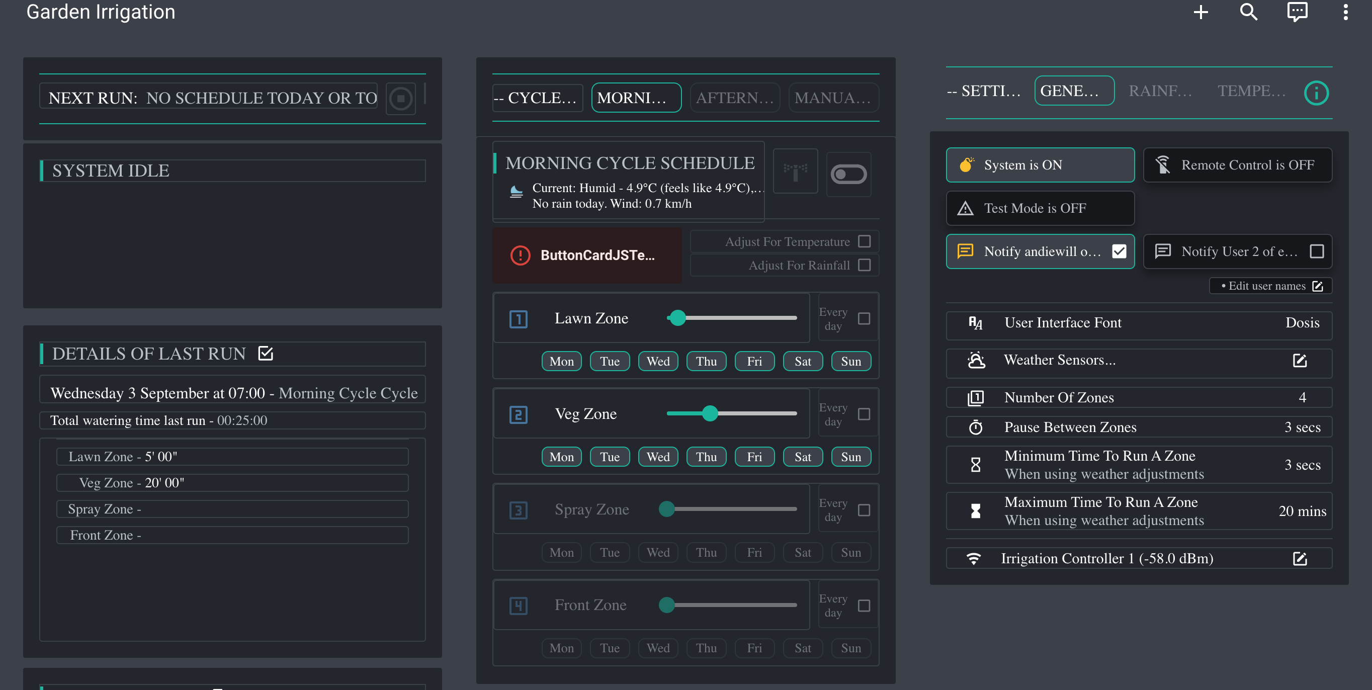

Thanks for sorting this out it was a life saver after the new changes, this also gave me time to sort out a few bits that was not showing correctly, and getting my weather outlook sorted which was well over due, but there is one thing that i cant seem to sort out is the start time button for the morning schedule, any ideas what going on with that ?

Is it just the morning zone because that would be even stranger…
I suggest you begin by adding a line
show_name: true
and then using that and the existing line
show_label: true
to only show one at a time - by changing them to false. The formatting will be wrong but hopefully that will at least point to what is broken and we can take it from there.

Thanks for getting back and i did try that to no avail, i tried a few permutations and in the end by selecting false to all the values at least i could enter to pop up menu and adjust the time, but this means i loose the icon on both morning and afternoon start time, i will have a go in the morning with a clear head and give it another go unless you have any ideas, but thanks for getting back to me.

If it is only the morning schedule my guess would be a typo somewhere in one of your sensor names - but that is a guess.

update…
After trying lots of permutations to resolve this to no avail to get this solved, i decided to start this from scratch sort of, anyway my thoughts is i think it was a bug on that particular instance of HA, even with the restore / backup i could not resolve it, but adding and restoring bits of back ups finally did the trick, it was along process but worth it having it looking as it should be, once again to Klogg thanks for this intergration as it is also one of my main ones i have and works wonders for my needs.
